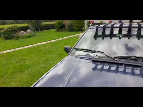

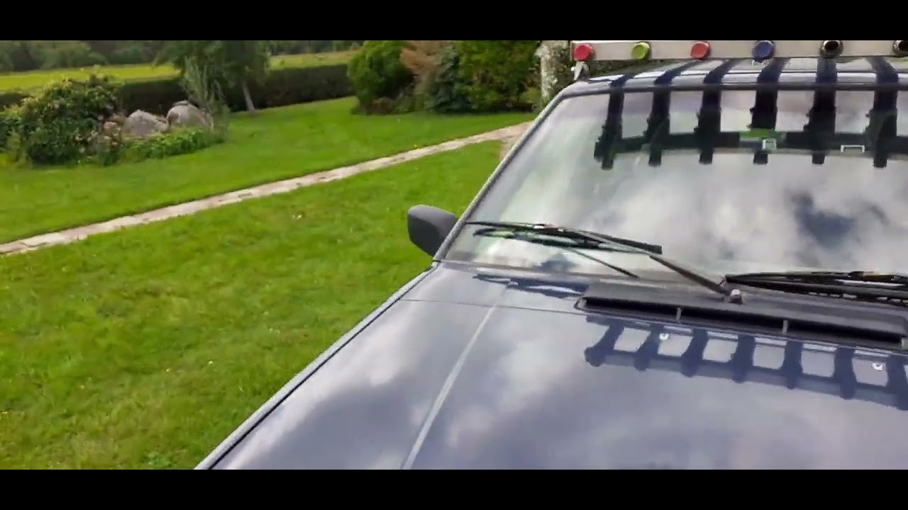

A piece of square 2" ss tubing happened to fall in my lap a while ago. Without even a mm to spare it was just enough to weld new 8-legged cooler manifolds.
I took the oppertunity to fit the cooler under the roof rack. This way I can utilize the rack for storage - maybe a luggage box for fuel?
It turned out very well, lots of cooling and space for a woodbox, I was looking at a smaller car to do over with less wood, what do you recommend for volvo?
The 140, 240, 740, 940 series are the most spaceous under the hood and the primitive computers don’t mind whatever you do. I’ve tried disconnect both MAF and TPS and the engine runs normal whatever I do. Not the case with the Mazda.
