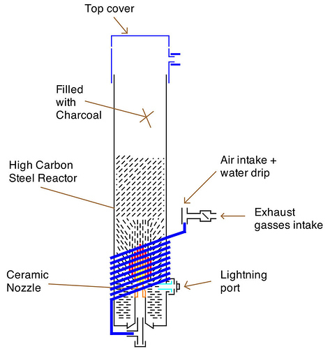

When I look at this design ( not of the simple fire but of K’s ) I am curious why he can leave an opening in the bottom of the device allowing air in ( plus steam ) ? Does this not give an chance of explosion with the inrush of air from the bottom?
It would seem to me that charcoal gasifiers would have less chance of explosion with a backfire because it would have less volatile gas in it than one that uses wood?
Always curious about the what and why of the design.
