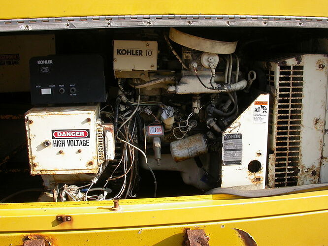

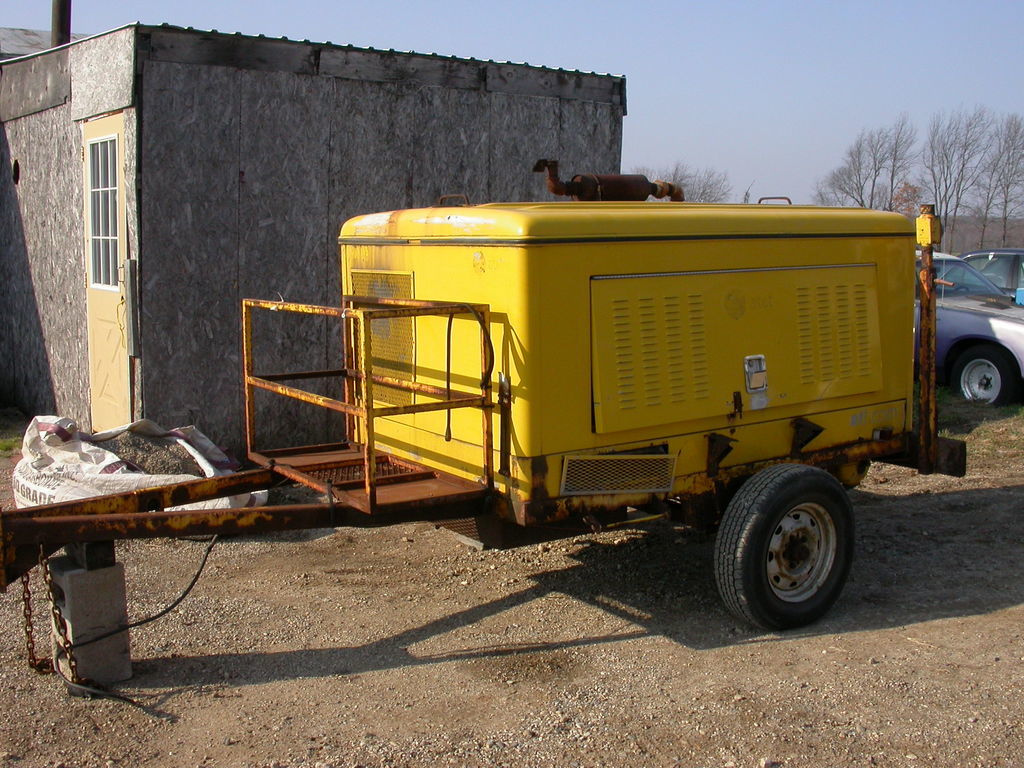

I did some swapping and ended up with this Kohler 10kw generator and trailer.
The Generator is 10kw model 10cc61. Enigne is Ford VSG411 1.1 liter with heat exchanger built into the exhaust. Runs at 1800rpm. Age approx 1990.

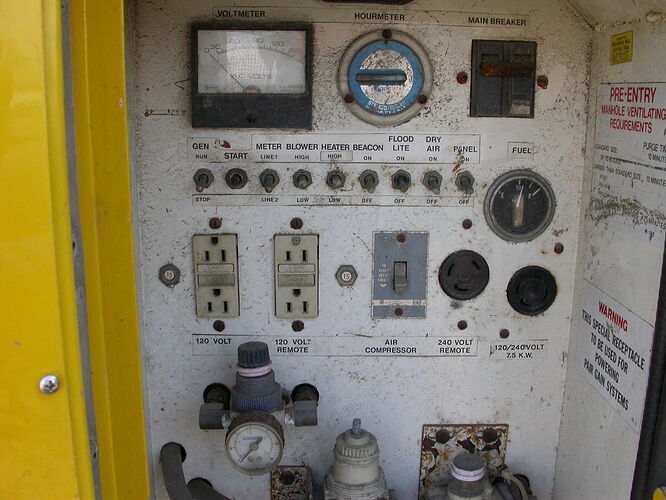

Trailer also has a blower and water to air heat exchanger for heating the tunnels. An air compressor, air dryer, air tanks, and a few more gadgets.
Future plans for it are to add a WK gasser and a battery bank. I may also be able to add a wind generator too it. This was auctioned off and was once a MIchigan Bell mobile power unit.

Definatly a four cylinder from the pictured four spark plug wire coil pac and the #4 in the engine model number. The 11 meaning 1.1 liter displacement. And I think the “G” meaning gasoline or gasious (NA or LPG) fueled engine. As in the LRG-425 Ford being a four cylinder gasous fueled 2.5 liter SOHC “Lima” based engine.
Heres where I struggle:
Post 70’s American/Canadian made Ford 4 cylinder engines had the intakes on the opposite side. As a cross flow cylinder head engine (exhuast and intakes on opposite sides) this is most likely an overhead camshaft? Belt driven? This is not a bad thing.
Mid down out the side of the engine below the intake is pictured what looks like an ignition distributor replacement camshaft postion signal generator. Not bad either - Ford did this on thier 4.0L V-6 and others converson to FI set ups. Need this for ignition (and port FI) cylinder to cylinder timing sequencing. Would date this block series as being an older carry over design. Early cast iron is good. I’ve only seen Ford use waste spark coil pac ignition since ~the early 90’s. Very reliable systems all in all.
The gas fuel mixer appearance is unfamiliar to me and seems to incorperate a built in electric fuel "lock’ valve? An intergal LPG vaporizer? Or, is this an actual gasoline carburetor? The wires to a fuel flow shut off solenoid and/or and electric choke heater coil?
I think this Ford Industrial engine may be Ford European or Brazilian sourced. This is NOT so good. NO Ford vehicles in the block series were used here. Where are you going to get hard engine parts from? Water pump, head, valve/cam cover gaskets, etc, etc.

I found out from a friend that the engine is used in several different agricultural applications including Bobcats. So parts should be readily available for it.
The carb is gas but it is supposed to also be propane of NG. Some parts are missing to run on gaseous.
There is a control box that also controls the throttle electronically. Some wires have been cut so I need to verify control board and governor function.
This engine uses a 5 bolt flywheel, newer 1.3 liters use a 6 bolt. I will take a template when I pull it apart.

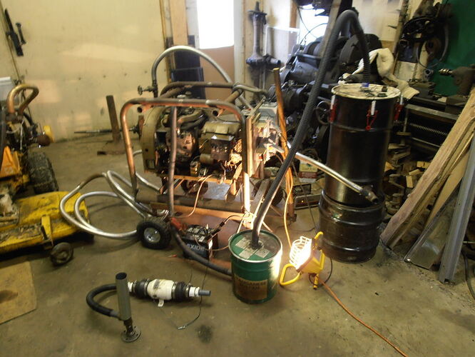

Hi Wayne, I have a 7Kw Kolher gen set from a motor home and have fixed it to run on charcoal gas. The only adaptation I made to the carb was to remove the air intake and put a 1" steel “T” fitting over it. On one side of the “T” is the hose that brings the charcoal gas in while the other side has a gate valve to control the amount of oxygen comming in. The throttle valve is left in place along with the linkage that attaches to the govenor to keep it humming at 1800 RPM. I have over seven hours of run time and have not had any problem with the throttle fluctuating back and forth with changes in load. It takes about 5 minutes from a cold start to get the engine running and the air valve set. Once set though, I rarely touch it until the unit needs shut down.
The first photo is the entire set up while the second photo shows how it is attached to the carb. The linkage from the govenor to the throttle is also visible.
