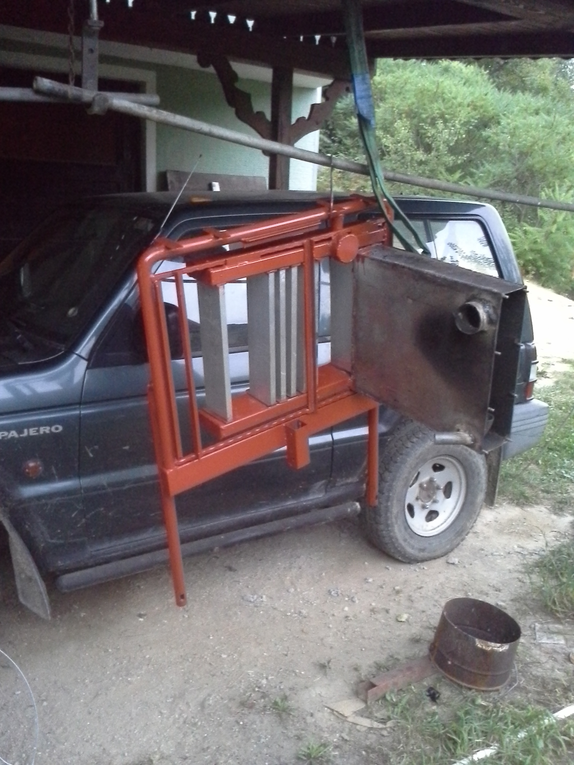

Today was “ornamental” day, made a place for the licence plate and lights. + a first coat of paint
you can see the hot filter box on the right, without the lid. lt isnt painted for better heat conductivity, neither is the cooling rail and gasifier.
