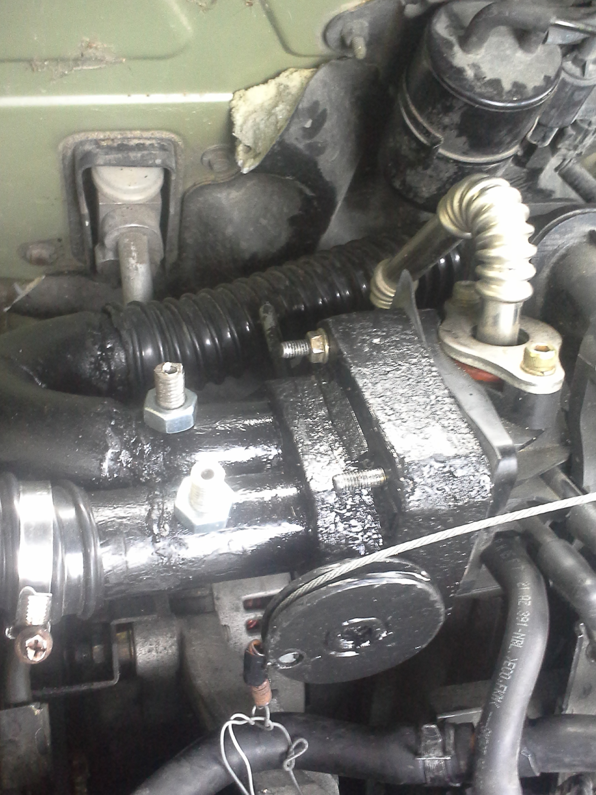

Update on the double throat&friends:
this is it. Works well, the flaps are well balanced. The throtle spring is temporary, untill l find a rotational spring.
Automixer to be made today, 8" this time.
At first test nothing was different. Still no woodgas idle. Thain l quickly stoped after a drive, disconnected the gas hose and tryed to light the gas. Tryed. Wuldnt burn untill offgas came trugh the system. I put a shopwac on the air intake of gasifier, positive pressure, gues what
cyclone flange leaks big time. This is the reason for weak gas, high temps, white ash on the cyclone. Welded the flange now.
The power was back, but still no longer idle on woodgas. When it consumed offgas the engine dyed.
Thain l remembered the non return flap. Dissasembled it and went for a ride. Amazeing difference! Looks like idle vacuum cant open it! Now l can idle as long as l want, but when l stoped the engine this happend

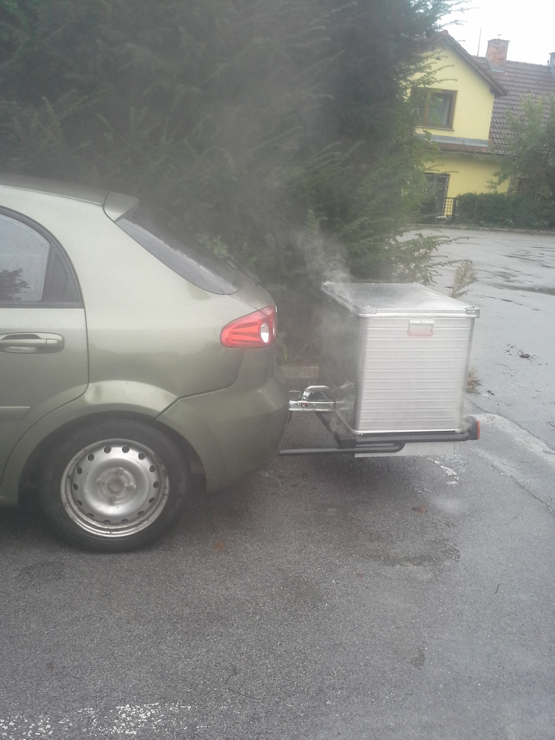

and it wuldnt stop! People were stairing and l had to deliver a inportant letter and the post office was FULL of customers. Thanks god noone called the police.
This made me think why l have so much offgas. I think the anwser is very hot hopper due to a sealed insulated alubox. Any idea how to change that?
Another interasting thing with a double throat throtle body is when cranking the engine you have to lieave the gas pedal alone. Still have to set this in my mind.

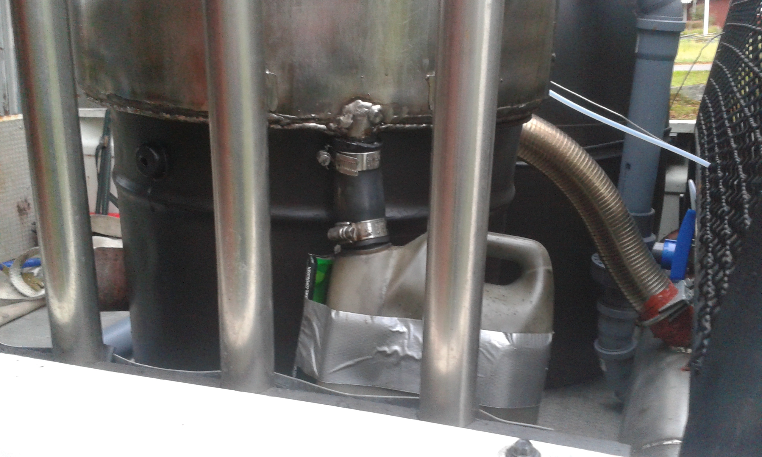

Reinstate the air flap on the gasifier!
Put another in the motor room, bubbling into 1–2 cm deep water.
Abowe the water, in the same plastic cannister, wet open cell plastic foam.
This second flap, which remains cold, can have rubber tigtening surfaces; it may not leak backwards, while the motor is succing.

JO, the thing is l have so much offgas it suffocates the engine sometimes. It got better with twinflap but the pressure still has to go somewhere.
Plus, the biggest problem, the offgas cools the charbed to a point takeing off after a few second stop is a problem. Again, much better with twinflap, still not good enough.

OK, Kristijan!
10.10.2016
If the backflap reinstalled on the gasifier keeps tight, the gas tries to advance forward along the gastubing.
Before it reaches the gasmixer, put in a Y- or T- piece.
From here on, one leg to the gasmixer, another hosed to a plastic cannister, probably on the low left side in the motor room.
On the way in into the cannister, put a plastic or metallic backflap opening towards the cannister. A very tight one!
It may not leak backwards, when the motor is succing!
Going into the cannister abowe the planned water or nafta level, using a 90 degree knee facing downwards into the liquid.
From the knee a bit of tube or hose downward, a bit under the planned liquid level.
So the off-gas will bubble through the liquid surface and keeping the open-cell plastic foam wetted, which helps to catch the visible parts of the off-gas.
Of course the cannister has to have an escape-hole on the top!
Water and wash detergent can also work.
Ahaaa! Finally I understand what’s ment by “offgas” other than after shut down produced nitrogen free gas - STEAM. Of course you get more of it not condensing it.
Maybe you could make some hopper tubes on the outside of your box. You would have to make holes in the box at the top of the sides, but the tubes could go all the way down into a small tank and from the tank up through the empty box bottom.

now l understand. I think the watter isnt nessesery, the gas is allmost invisible. Ill put a second non return flap in for sure!

About the tubes, damageing the alubox is not an option (police stuff). Ill start with a fan mounted in the alubox and see where that takes me.

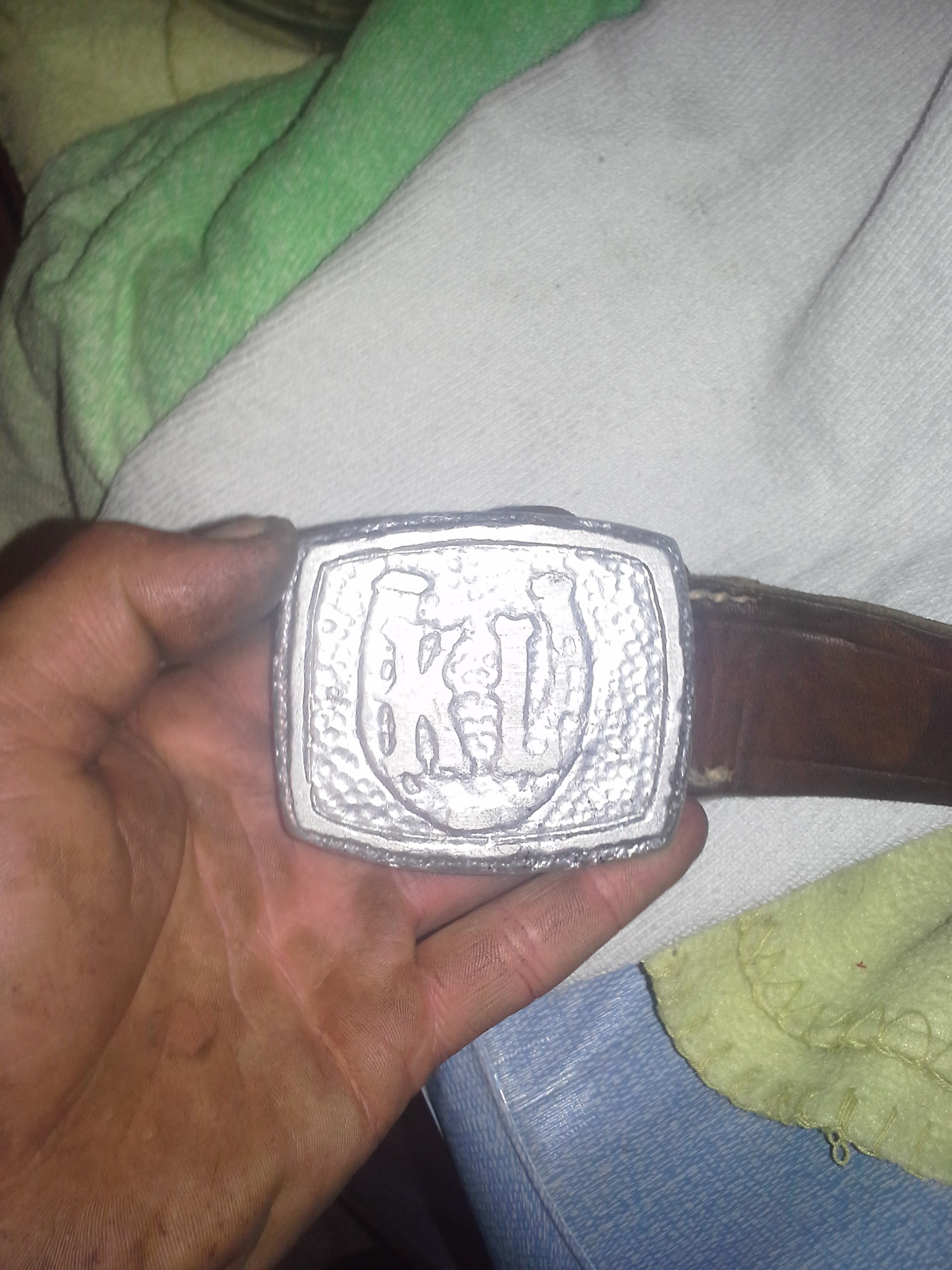

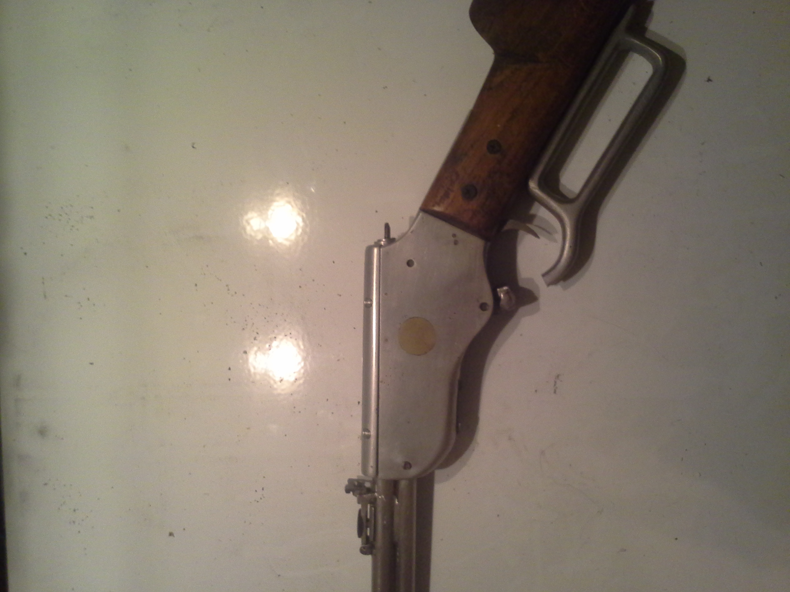

I dont know Calvin and what he does, l use lost foam method. Its so simple lm surprised not many folks cast their own parts. First you make your desired shape out of regular styrofoam. You berry it in regular sand and cast molten metal in. Thats it. The detail is amazeing!
Here are two of my castings l did last year, just to show the detail possible.

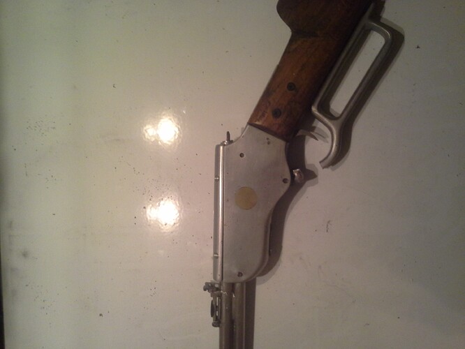

The henry rifle replica is entirely made by this method, but the lever is unfortunaly broaken off. The buckle l use every day :blush:

Thinking further: The “condensation cannister” should have an exit tube leading out of the motor room aswell! In consquence with Steve’s serious talk!
You missed the part of my statement about your “superman” cape. You must be Superman with all of you knowledge and talents. Is the Henry functional? TomC
Aaaa sory about that :blush: no, no superman but thanks.
Yes its functional, as a capgun. 5 shot.

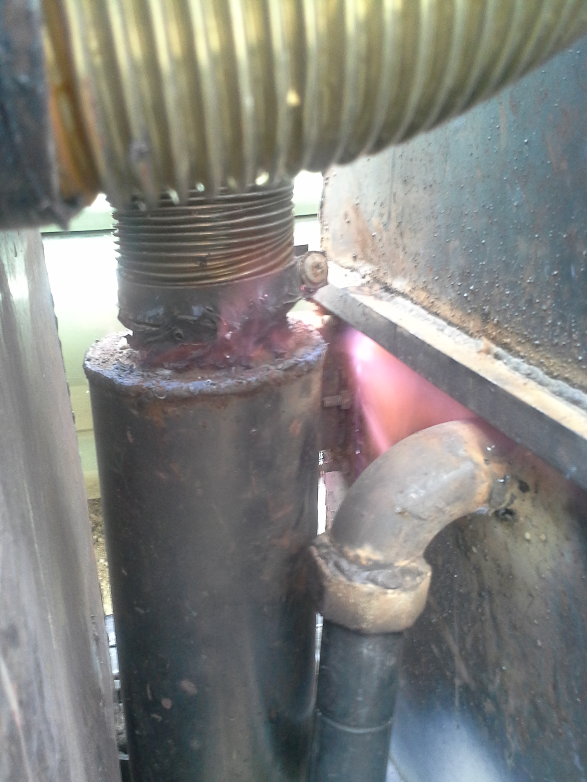

JO, your idea got me thinking last night. How is tar affecting cooling areas? Do you have tar buildup on your outer hopper wall?
Yes, I have. But only to a certain point I think. If I allow the hopper to heat up from time to time it seems to melt and drain some. I wonder if Wayne has seen more tar bildup in his super cold finned tubes. If he reads this he might be able to tell what happens with bildup in the long run and cold vs hot surfaces.
Good morning JO and Kristijan .
I have seen no build up of tar in the hopper . It all drains down to the hopper condensate tank where it is emptied periodically. However there is a crust ( baked tar ) that will accumulate at the top of the burn tube that I will dislodge at cold start ups after lighting ( a few strokes with the poker ) . This build up of baked tar will only happen when the gasifier is allowed to go cold at shut down and set a few hours or over night .
( I may produce more tar than most because I run almost 100% on pine wood .)
Kristijan,
To add to your confusion I’d say Wayne and I are both telling the truth.
The difference might be I do a lot of really short trips, 10 miles or 15 min to work. The lower half of my hopper is actually still cold to the touch. Tar starts not to flow well if it’s below indoor temp (20C).
This morning it was just above freezing and when I got to work the lower half of my hopper was still at that temp (or slightly higher). I think this makes the tar stick to my hopper wall. I know that after a longer (hotter) trip the tar flows down and accumulates in my plastic can. This is when I empty, not only condensate, but also the collected tar. It’s the only time my can is warm enough to get the tar out.
Thanks for your input. l have that baked crust in the entire hopper. I think the tar sticks on it while cold and since it warms superhot soon it bakes and falls off. Same on the lid.
