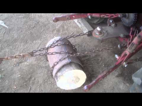

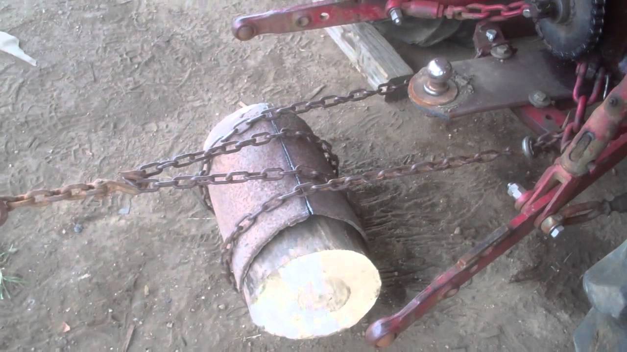

Good Morning Mr. Larry .
Her is a video of shrinking a fire tube .
It is about a 10-15 min job.
I also us the same process on some of the other containers to make them whatever size I need .
You might be able to use the 14 inch tube inside an 18 inch container but the space would be limited and probably restrict the air flow .
Thanks Wayne I might give it a try. Bet it takes me more than 15 minutes.

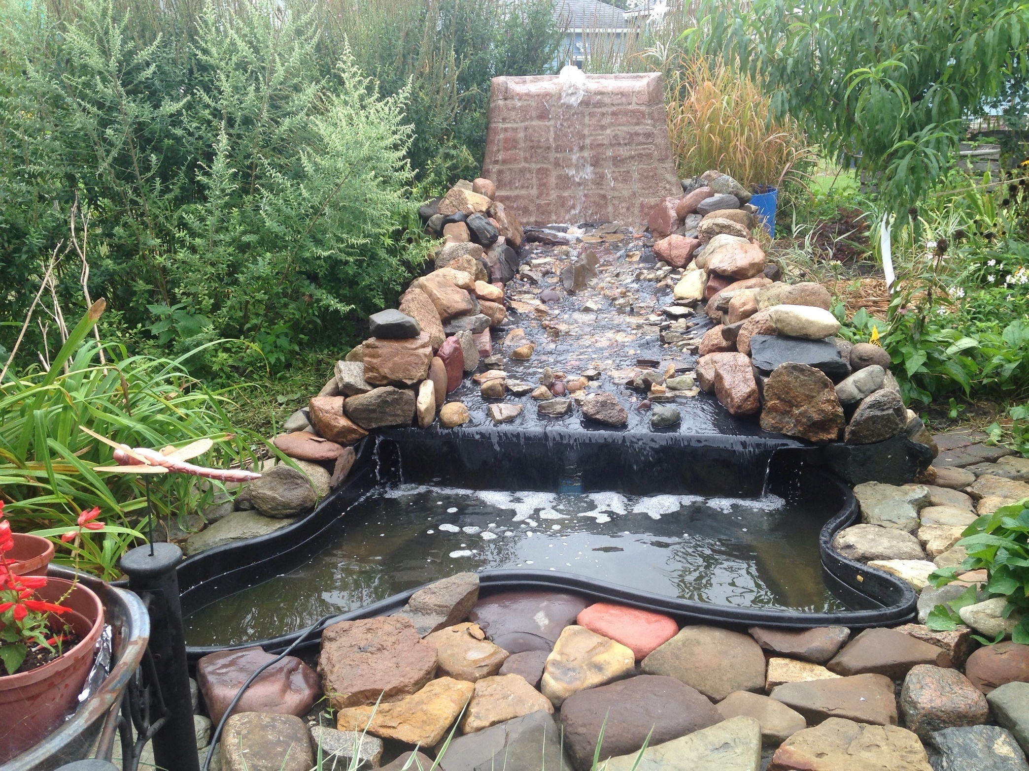

Had some fun this summer making this waterfall/stream/pond combo!! We have about 30’ of room between our house and where I hang out in my shop, so instead of having to mow this area we did this!!!
Are you stocking any fish in it???TomC
