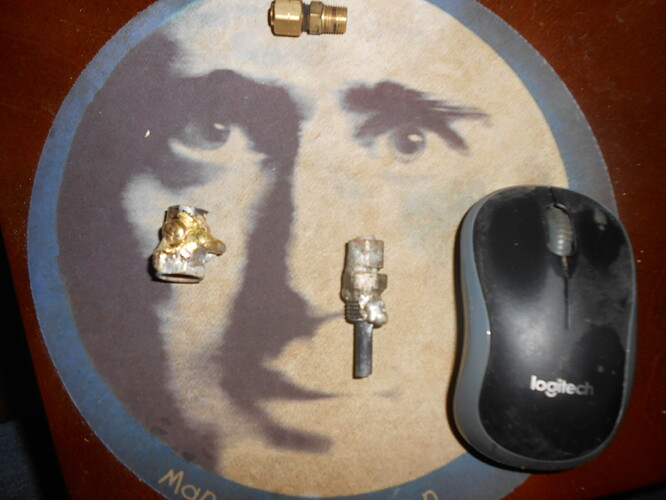

Build fail , fail to rebuild , need to buy more oxygen . I had a pin hole leak and tried to redo twice and burned hole through pipe and fitting .

Hope this thing is installed outside. There must be a better way to join that tubing other than high-temperature brazing. I would use black Iron pipe wherever possible. Black iron pipe is a proven way to transport fuel gasses. Then, a short flex to the propane cylinder outdoors. What is wrong with compression fittings and semi-flexible copper pipe?? Will you need a pressure regulator?? Use RV grade parts.
What is the application? Home heating? Generator? BBQ? 500 Gallons!!?
This is what I am speaking of:
Mike just used eletrical solder that worked fine no leaks . Problem was I could not get it running under 3000 rpm , I added economy and emissions part and could not get engine running over 1000 rpm . I have no idea why .

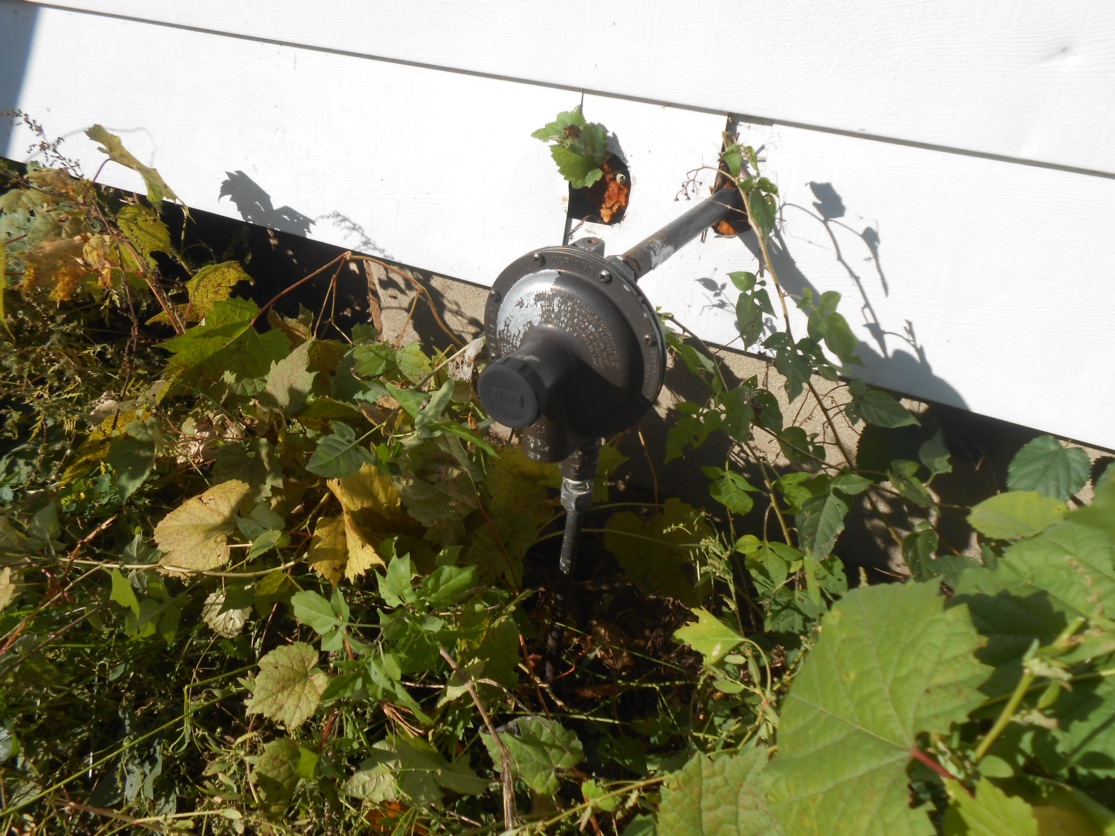

The propane does not come from house into tank
The copper tubing goes from tank regulator to house regulator and has flare fittings

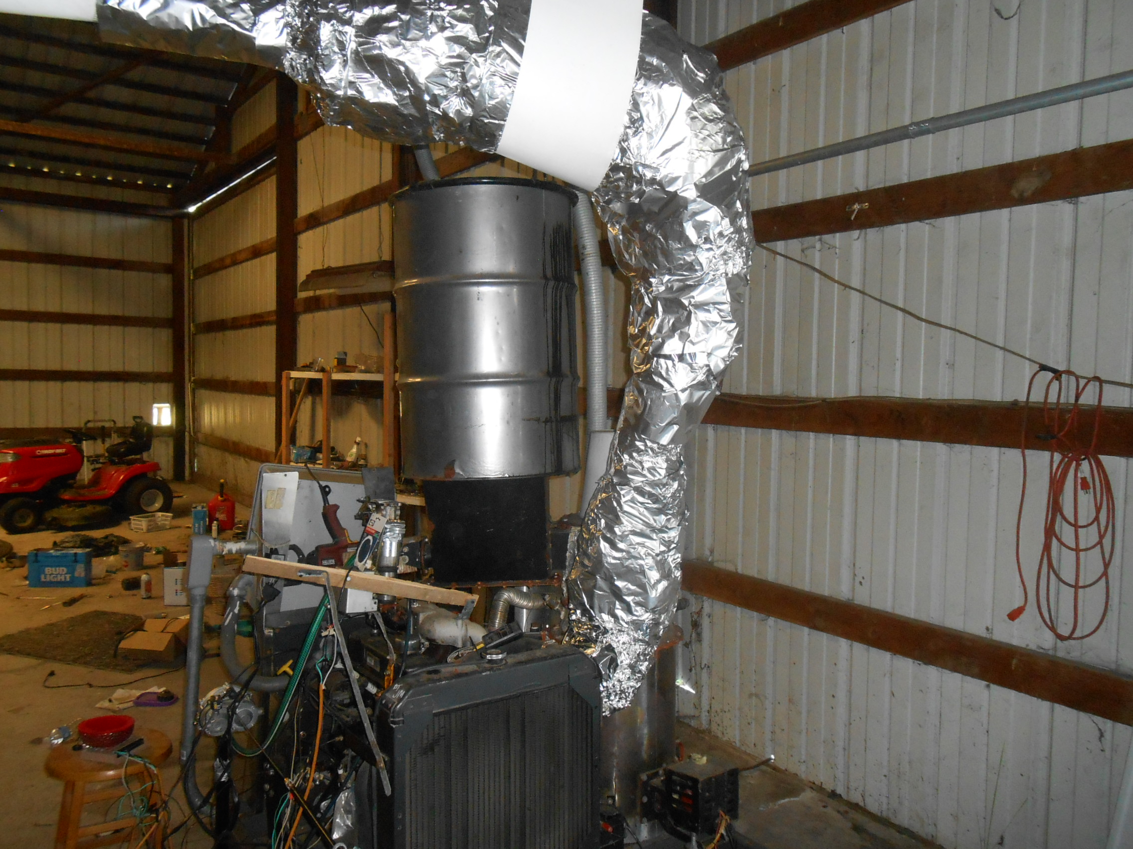

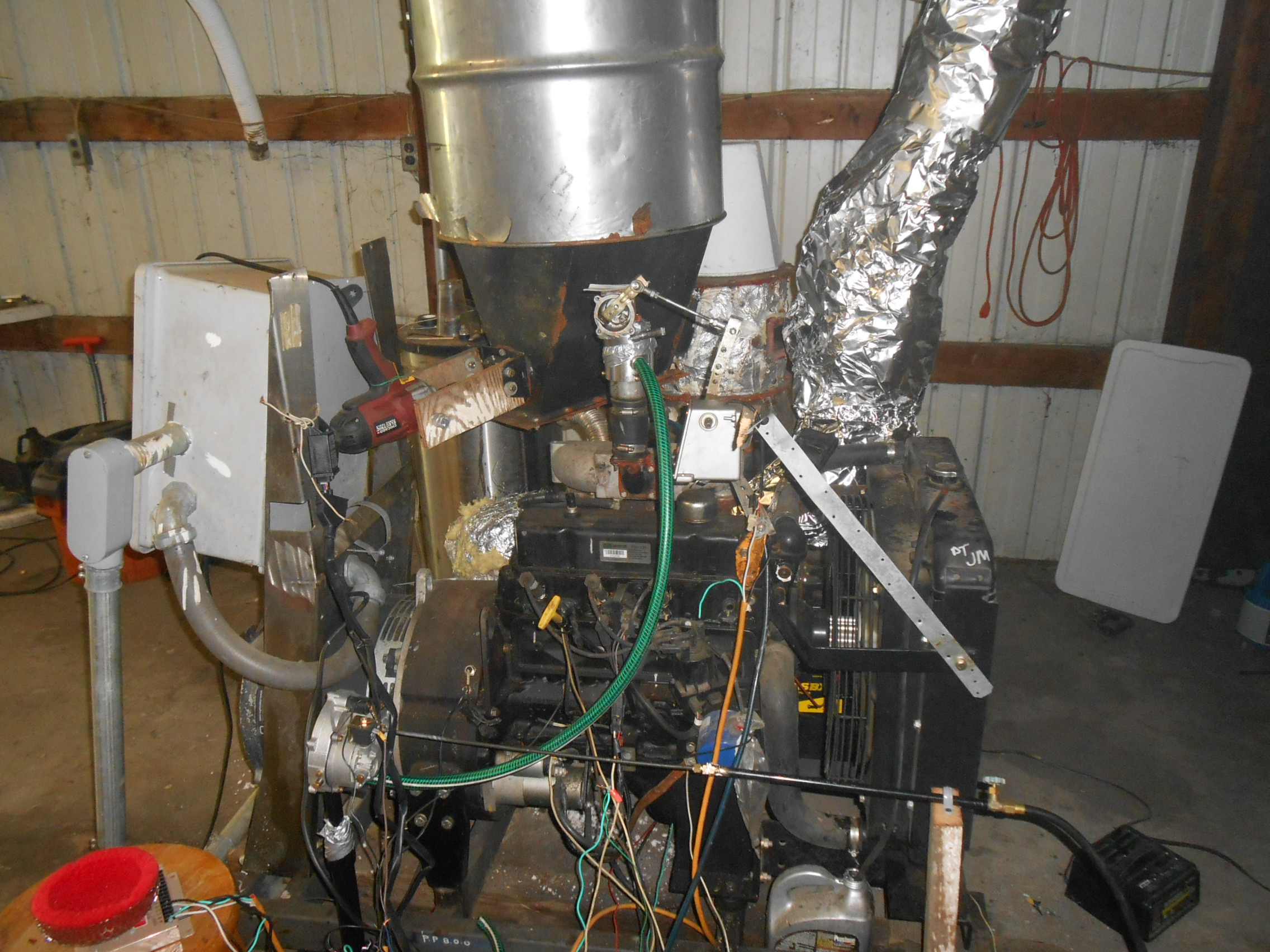

After a decade of work and a hundred thousand dollars invested I have gotten a generator running on propane which generates no energy and no heat .
This was air intake over throttle body . Just a hole that big in this piece of cardboard . Also solder I used on propane line .

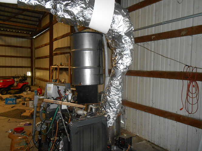

Picture of whole unit

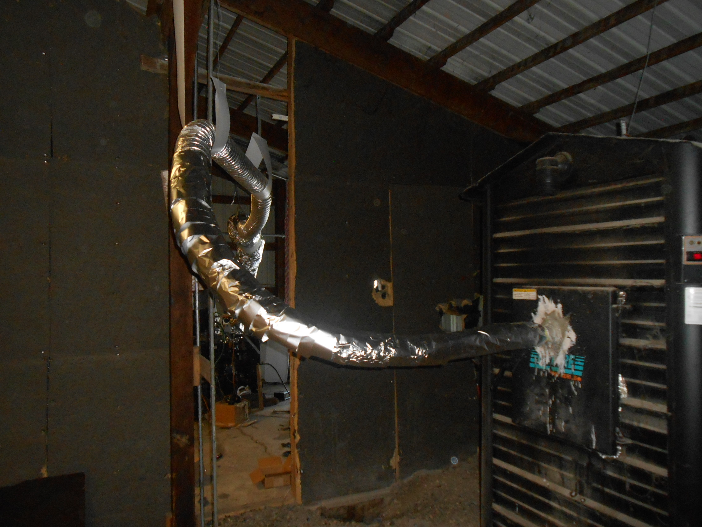

Picture where exhaust enters boiler
Picture where exhaust leaves unit . It is like I am living in a cartoon .

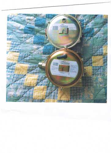

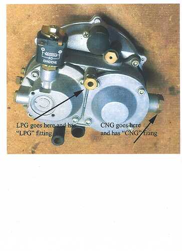

One has to deal with something, otherwise the brain and joints stop, a lot of will and energy seems to be invested. Did you use a vacuum regulator? Do you have an automatic mixer?
Henry, this is a good vacuum regulator and at the same time a liquid propane gasifier, in which case it must be heated. There are many unknowns on your system, including the flow rate of the pressure regulator on the tank, the functionality of the lambda system for the preparation of the mixture, … I’m a little scared for you to guide you right, you should go slowly through the system and analyze part by part.
The regulator needs to go back to Argentina . I am going to try to run this off Webber Grill . I need new regulator maybe a fork lift .

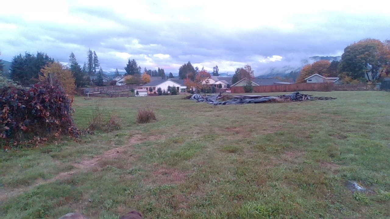

Looking SW to NE across our Yacolt-home properties - most of the leaf colors are wind blow off and dropped now. The “smoke” over the top of my house rooftop is actually background fog forming

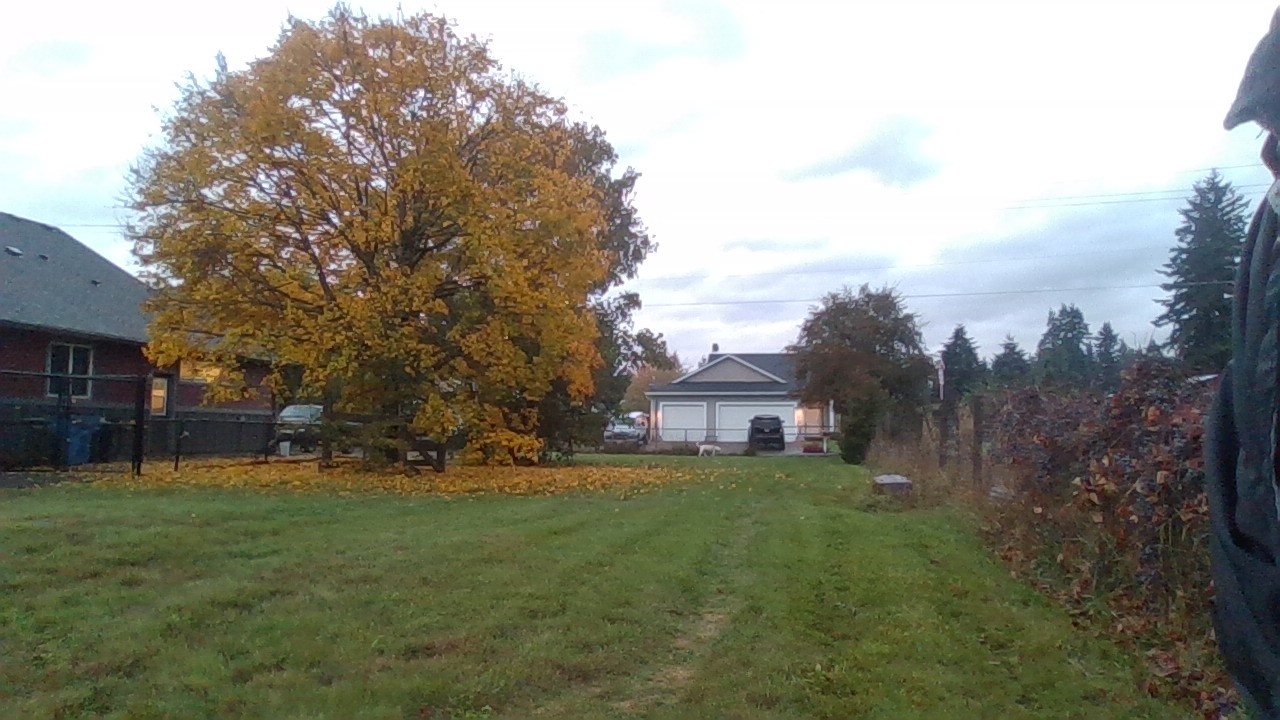

And reverse view - yes my planted maple trees to make leaf’s for the garden to the right
And everything seen here we did before 2000 cow graze down. Until our dear neighbors made that illegal by town ordinance.
And this is what I must mow since to not have unmanaged grasses Fire hazard fines, and noxious weeds fines.
I did hammer out the last hopefully mowing this year in three hours fast bucking bronco speed mowing last week. Ha! walked crooked for a day or so.
Yes. 1 1/2 gallons of gasoline sacrificed to community standards.
These rocky, stump holed cow pastures only look smooth.
I have torqued-tweaked, worn out, and broken down five different mowers now since the year 2000.
Sorry. Just not woodgas-able to do this. I’d bucking bronco shake apart an add-on system.
