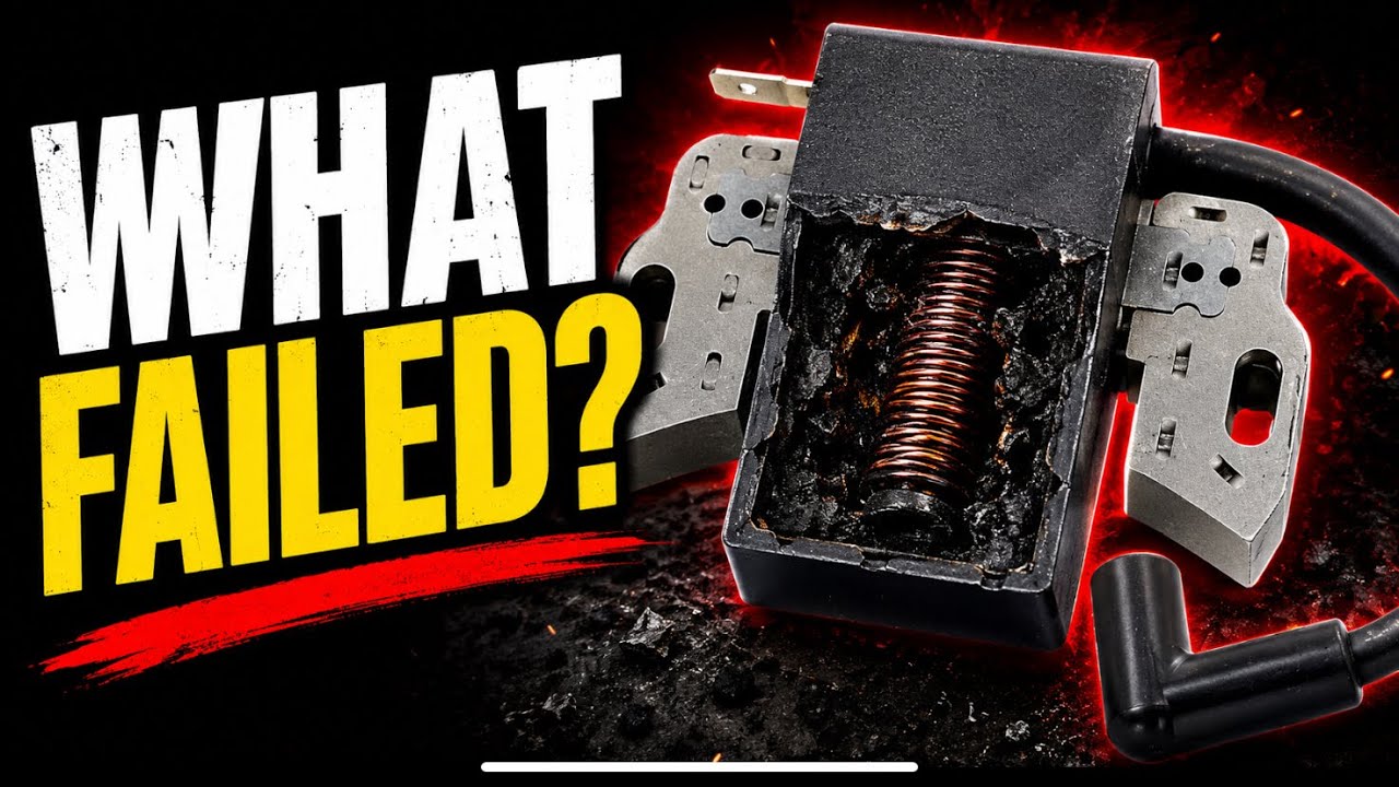

Hi Goran these have solid-state ignitions with windings and a special transistors built within the coil pac.
You need to test for ignition spark strength:
My handy-dandy ignition strength tester says for Small Engines the spark in open air must jump a 5 mm gap with strength:
As seen you can easily make up something similar for testing.
Tested weak spark the only adjustment is the coil to flywheel air gap. If O.K. time to change out the coil pac. Likely shorted coil windings or a leaking transistor.
