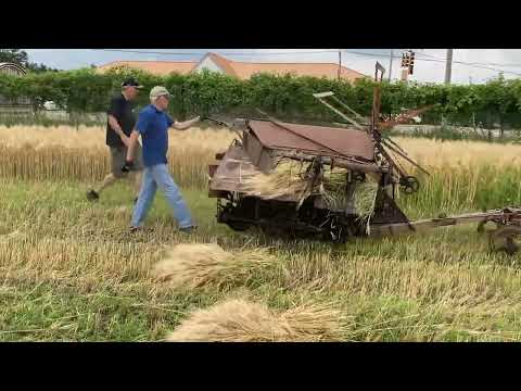

They make super expensive binders for those. But if it helps, since my curiosity was piqued as to how it was done…
Which gets to an issue of a knotter, which you probably have to swipe one off a baler. The conveyor is just canvas sewn in a loop. Which even with a manual trip, and a no knotter, it gets you what you have right now without a second person, so it should go faster.
I started looking at the walk behind reaper binders. ![]()

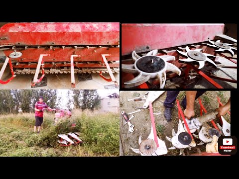

This gathers everything and dumps really neatly to the side. More advanced models have a gatherer and binder as well. But basically it is a pair of chains with cleats and snouts with matching wheel sprockets that aren’t even powered to hold the material. The actually look like they are plastic. and I don’t see why tines like they use on the bcs couldn’t be used.

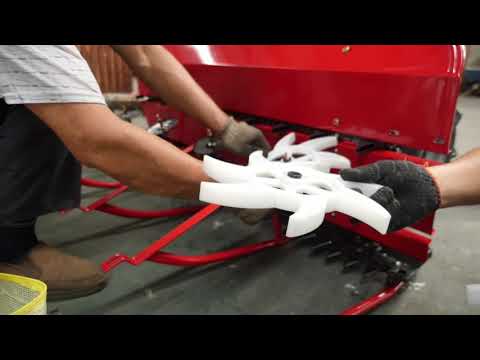

This is an assembly
This is a build video of the snouts for a knockoff.
A BCS version knockoff might be the easier and cheapest to build. the gathering mechanism is literally just a 2 discs on each side with curved gathering tines on them kind of similar to a hay rake tine. But because the gathering system puts everything in the middle, it wouldn’t be that great with the walk behind because you want wider wheel spacing.
