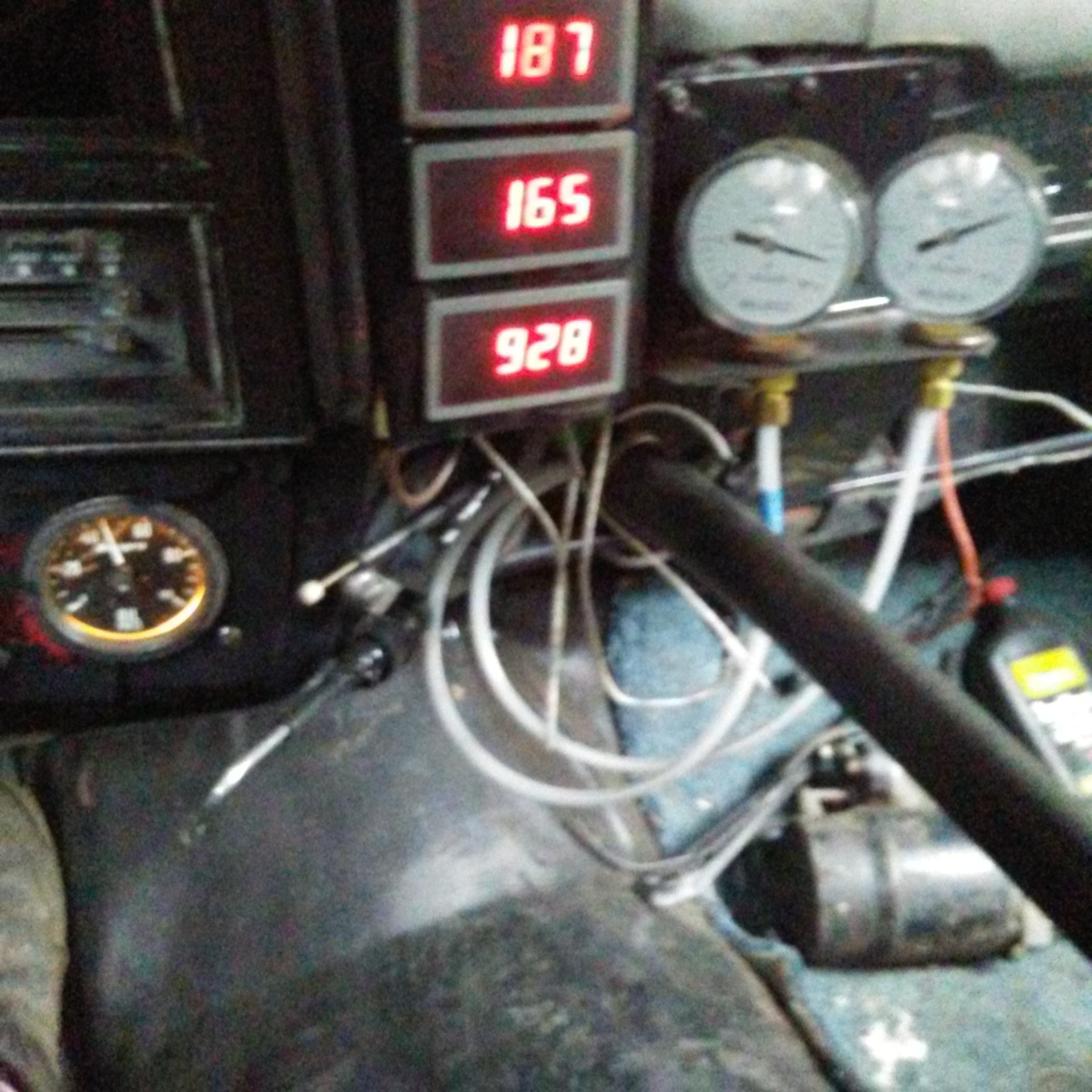

Thanks Sean O i. Thought it was runni g a little ruff at idle, and it was below zero while driveing wind. I am going too raise my restrictor and and narrow it and see, as i made some tar on the throtol plates this morning no stuck valves but was running a little ruff at first start up.with my v10 burn tube i think its too long for the motor i am using.so i will be adjusting the temp restrictors.and when i hit the grate at fill up i used a 1" pipe instead of a small rod.my restrictor is about 7" at bottom of the larger diameter tube and the long vi0 tube.That may be the milege and power problem as well.
You might want to try like a valve cleaner if it is getting a little sticky, before it becomes an issue. something like marvel mystery oil, or something similar. I forgot what most people use on the list, but it beats tearing the engine apart. You may have issues because you are using pine and that tends to have more tars in it to begin with so you may have to make some adjustments, but fix the air leaks you know about first. You wouldn’t be the first to have issues with gas quality because of tiny air leaks.

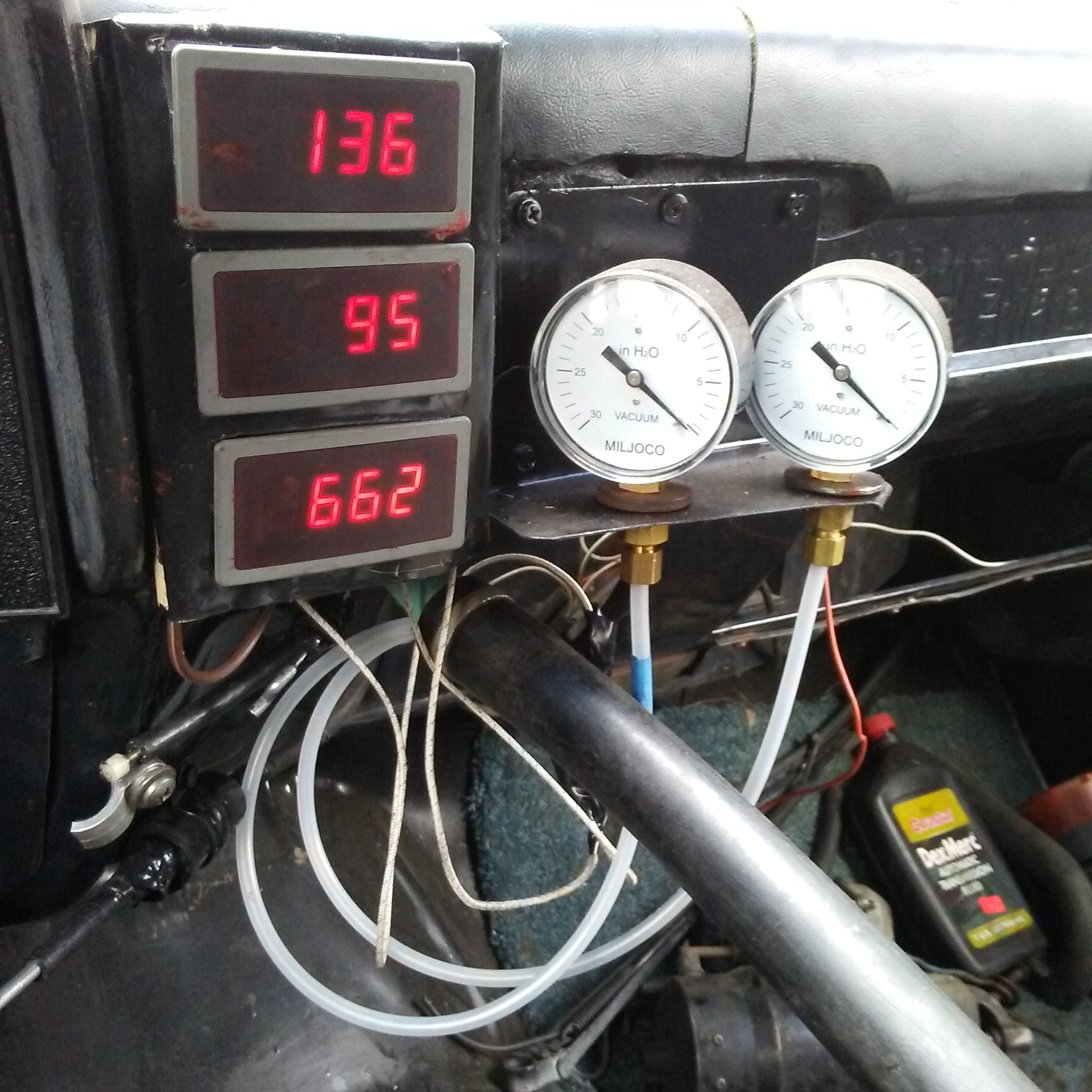

I noticed a 600 and 900 degree tempretures on the tempretures displays in your pictures
Both of these are pretty good indications of an air leak or overpulling where the gasifier has gone into “heater” mode.
I had these same issues for about 6 months after my first start up. I continued to try to drive at 60 MPH and finally Wayne K advised that I had found the upper limit of the 12" gasifier with a 7" restriction at about 50 mph!
