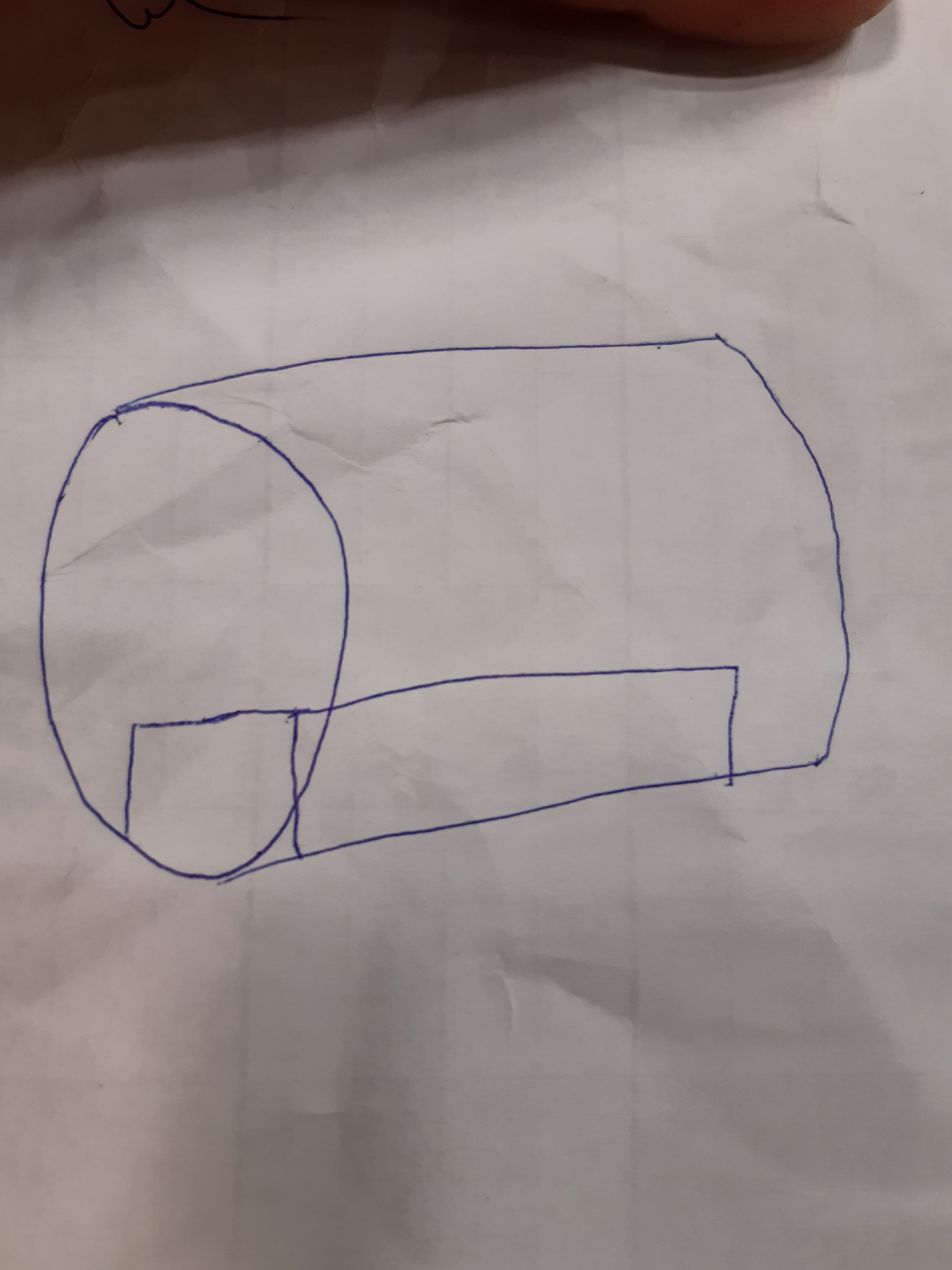

So cool you have the exact same plan as me. I actually got an old slurry tanker with a nicely sealed door at the back. Yours must be similar. What design are you planing?
I was just confused because most of the other retort makers use a design (enxter retort) where there is an inner and tank and an outer tank. so that the heat can go all around the inner tank. But it is muc…h easier to build with just a fire room along the bottom of the pipe.
:slight_smile:
Well l wuld suggest extending the fire room a bit so that at least 1/3 of the kiln surface is heated.
This design is simpler to make but probably less efficient. For me, wood is free. A finding a extra vessel to make a outer shell isnt…
wood is almost free for me too. it is easiest for me to build the fireroom 600mm wide. i think i am going to risk it. hopefully it will work…

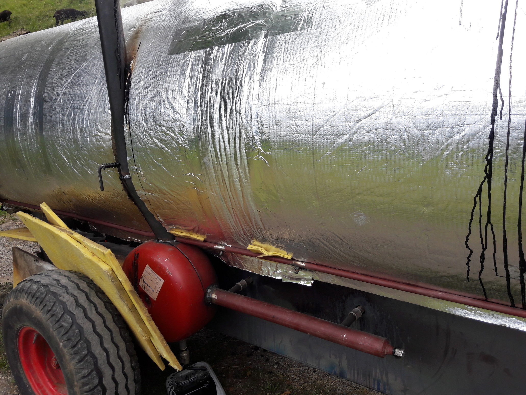

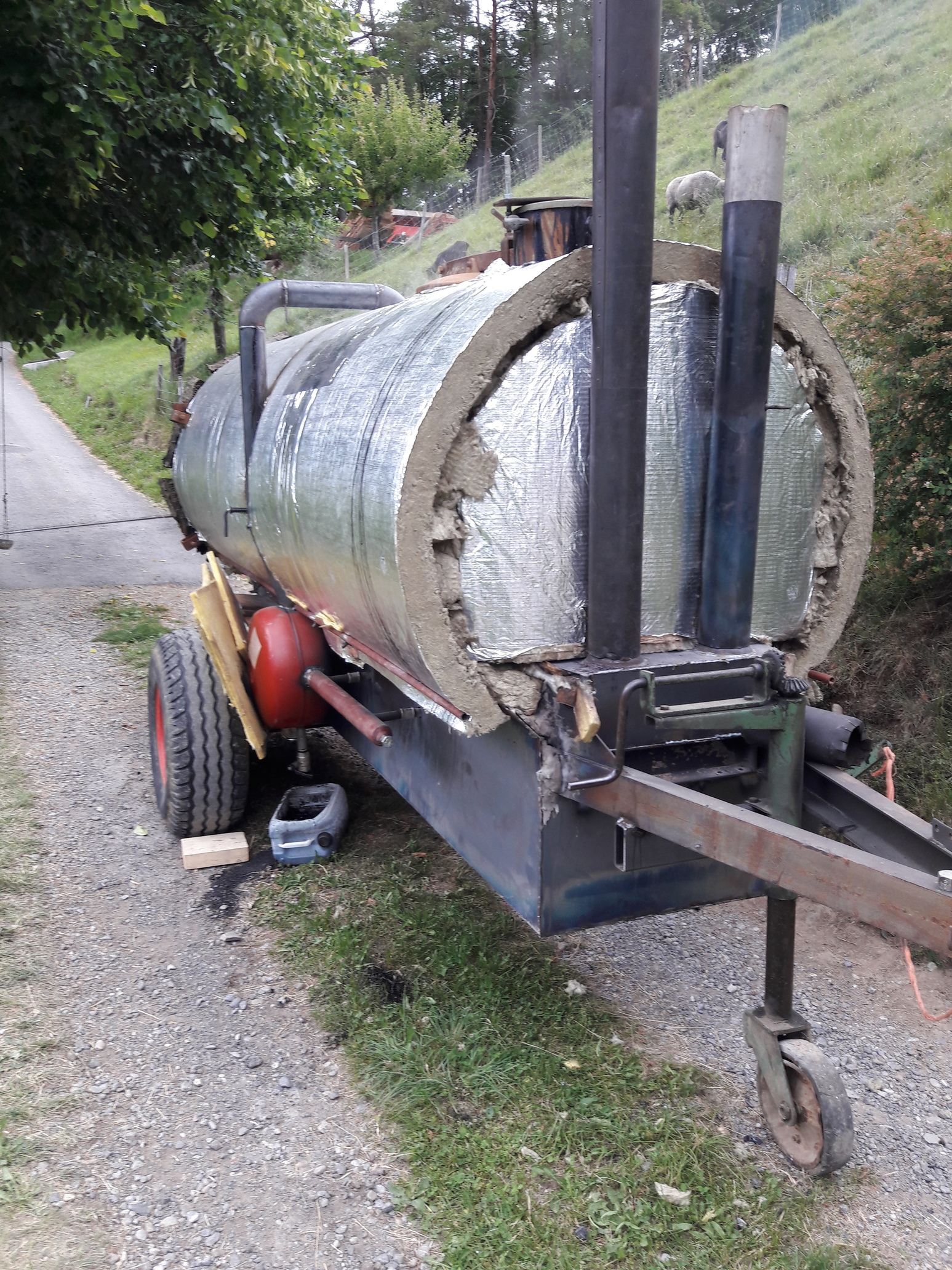

So I have built my charcoal maker.
From the tank runs a 3inch pipe down to the destributer for the gases. From there 2inch and then 3/4 into the fireroom. The burner pipes have holes of 8mm.

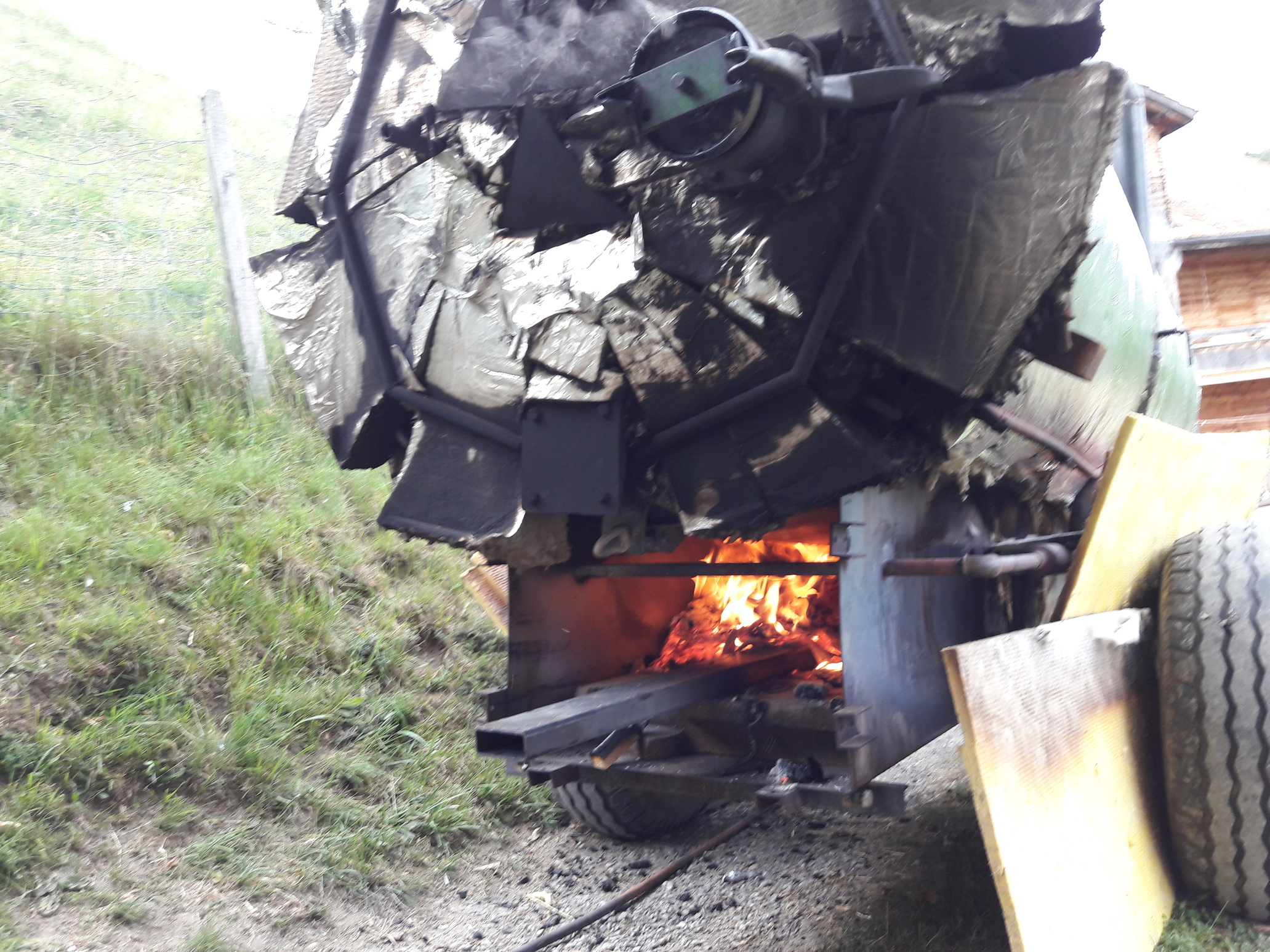

Today I have spent 10 Hours to try and get the process started. But I only got some shy flames out of 2 of the 5 Burners. But by far not enough to get to the the point of it running without added fuel. I had the fireroom so hot that the tank was partly glowing.
So I think heat was enough.
I just dont know what is not right. Does anyone have some advice? Thanks
How dry is the wood you are trying to make charcoal out of? Do you see a lot of white steam?
My wood is stored for 2 Years in the covered in the sun so I guess it is well below 20%. Yes there is white steam but not more than usual.
I think the surface over which you heat the wood is too small, if the heat covered the whole tank, the thing would work
That is an impressive retort I hope it dosen’t melt with all that insulation. It should be very efficient.
Do I see a steam vent on top? How many hours did it take to get rid of all of the steam. Even 20% moisture is very many gallons of water that must be driven off. Don’t send gas down to burners until you can ignite the gas at the steam vent on top.
Thanks for all the advice so far. I see I did some mistakes. The steam outlet is just about 4 Inch. That might just slow down the steam to much to get out eficently. Still I do think that in 10 hours of heating it should get out.
Then I did try and start the burner while there was still white smoke (water). I should wait till the steam turns into like mustard coloured. Is that correct?
thanks
Yes, on letting the steam vent until burnable mustard colored smoke comes out. I would add some fire brick to the walls of the fireroom (we say firebox), a grate, a door and a blower.
Bruce, l have to dissagree. Firebrick on the inside will decrease efficiancydrasticly. It will protect the metal thugh.
Like sayd by others, the problem is to litle heating surface. Even when it gets to auto-burn mode, the surface where the burn takes place is to small and will likely overheat.
