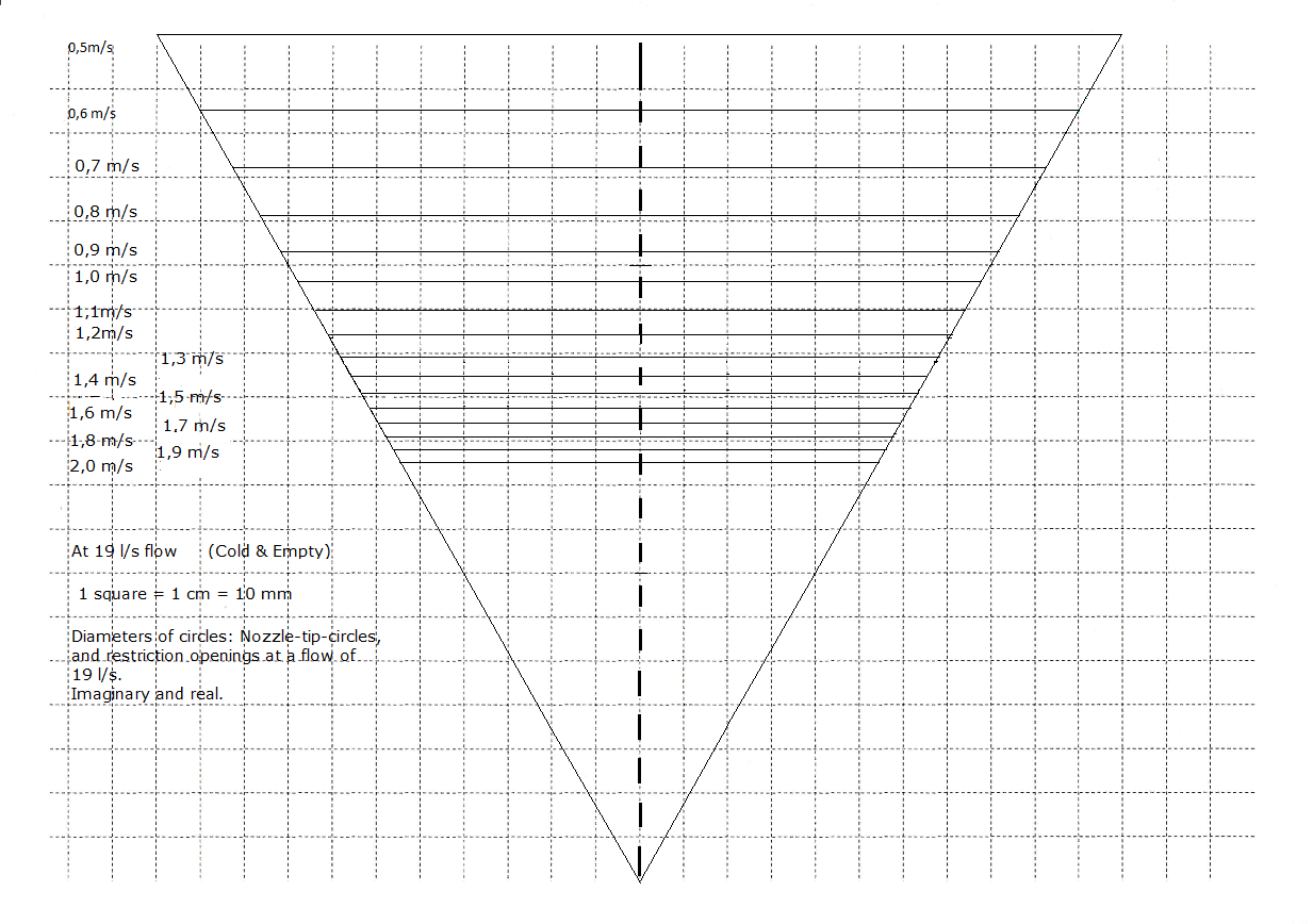

You aim at velocity. During WWII a spring loaded flap at the entrance did it with one cyclone; two different cyclones is better.
Fundamental velocities for 1,8 l & 3500 RPM WOT
Cold & empty.
(18,9 l/s) but rounded to 19 l/s.
One step on the road:
Found a functioning converter! NCH
Here is the Flow : Diameter = Velocity Diagram
