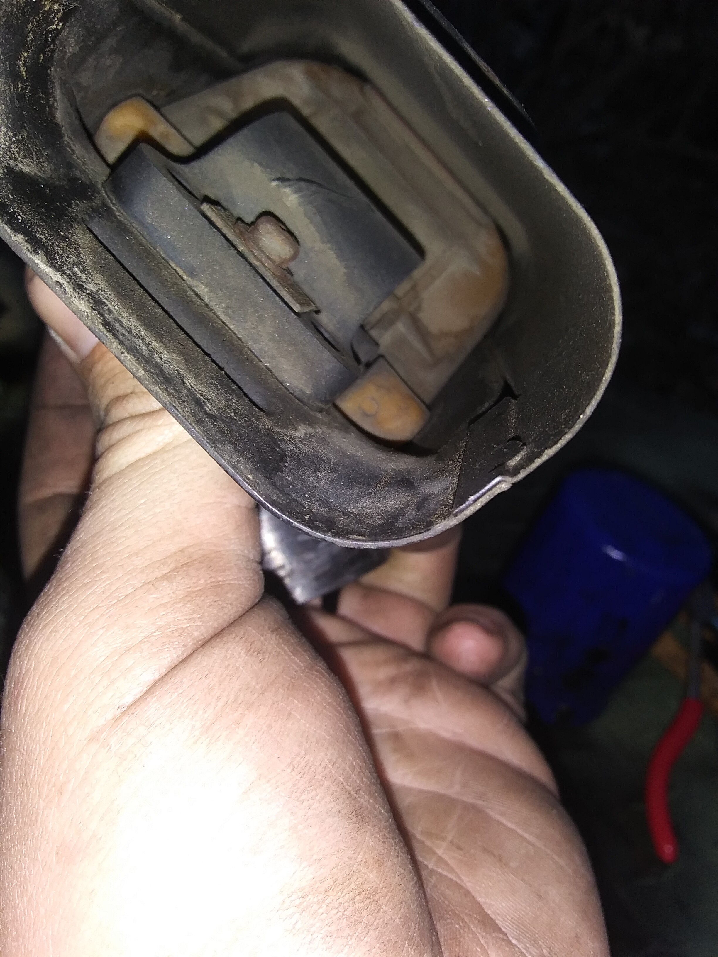

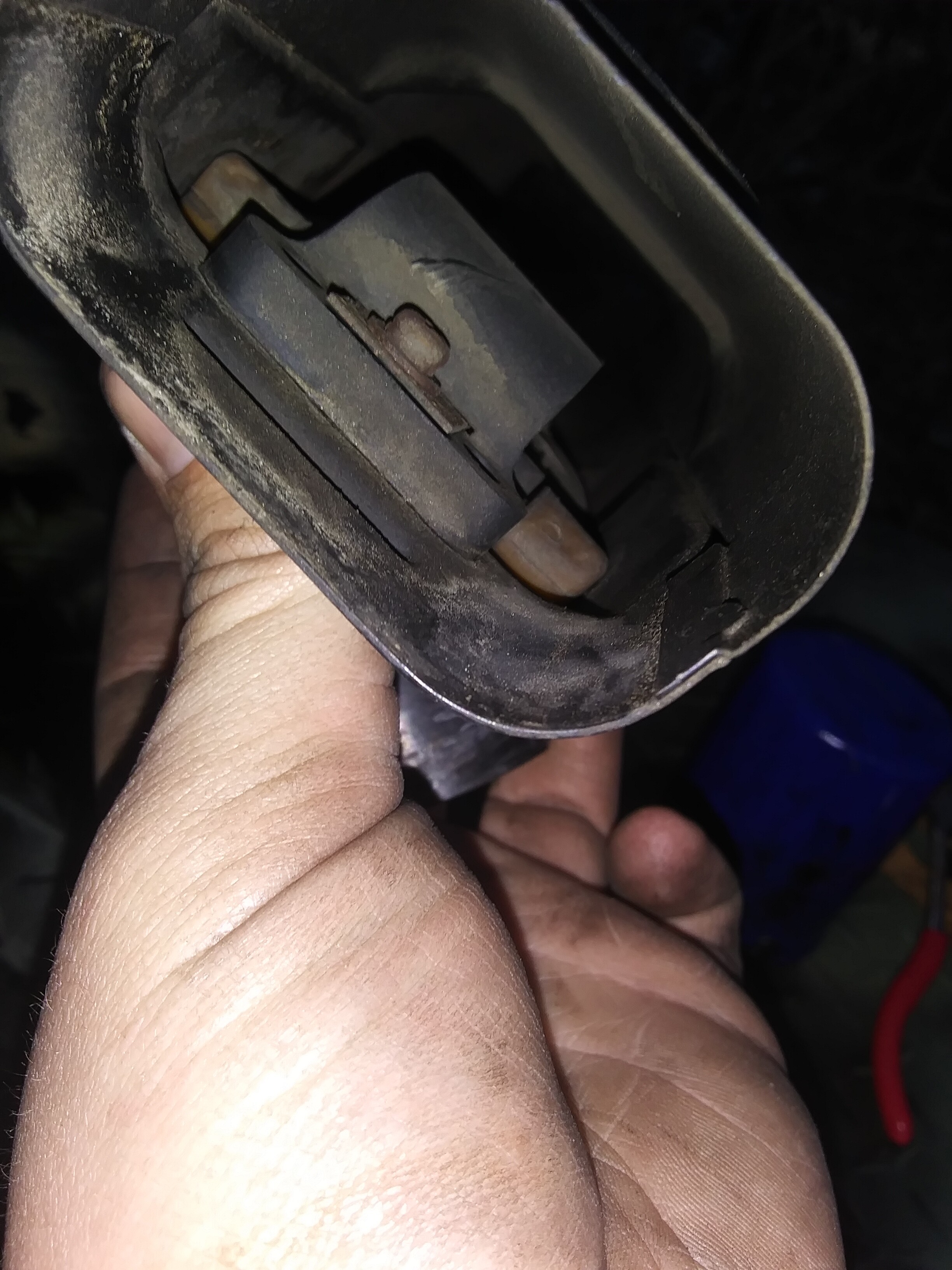

A few neat features of the airbox on this truck. I think this is part of the EGR or maybe some other evaporative setup, looks like the flexible hosing is coming from what people call the charcoal cannister. Very neat flap design. I wonder if I can plumb in my woodgas off of that area or maybe the incoming air will force the flap down.
I plan to remove all of the old vacuum mess and replace the exhaust and carburetor with a more simple system.
Pace Setter headers and a Weber 32/36 style carb. I am going to make the original aircleaner fit onto the Weber though so I have a way to direct the woodgas inside.
This whole system is aged out and would cost an arm and a leg to replace.
The new headers come with an O2 sensor hole so I could insert a wide band AFR gauge into that.
The air intake end of the air cleaner has a plastic bit that runs towards the radiator to get fresh air, so it goes from the airbox as rectangular to circular piping, I could attach a butterfly at the end of that fresh air piping to meter the air.

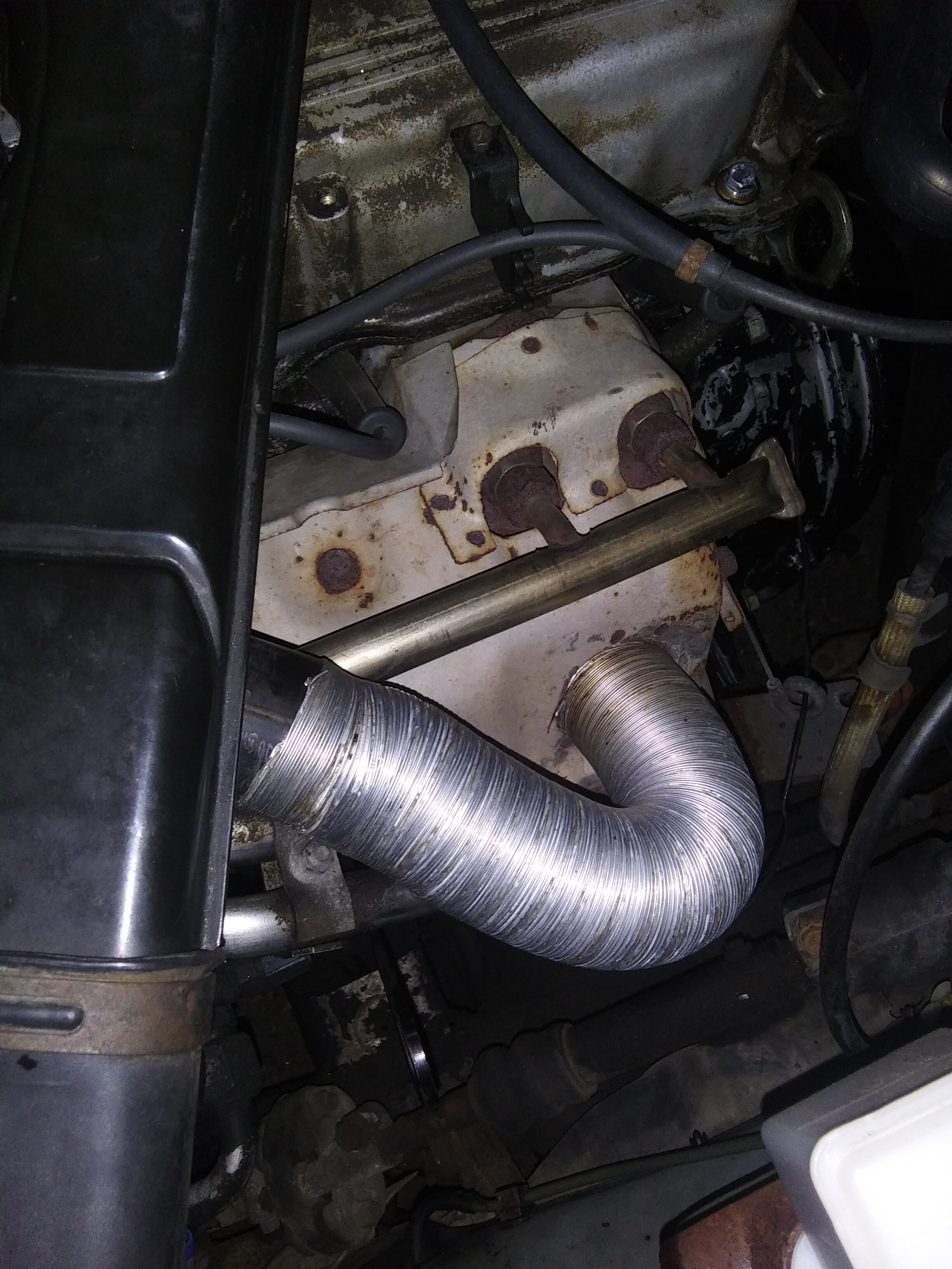

EDIT: That aluminum hose is the air preheater.

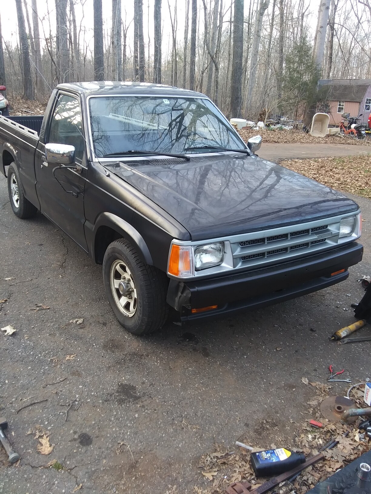

Here’s a picture of the Mazda. I don’t have the bumper ends in and might not insert them and instead make some flat end caps instead of the rounded corner ends. Had to replace the passenger side fender, grill, bumper, and valance due to that wreck. Lucky I didn’t suffer from any alignment issues or frame damage.
