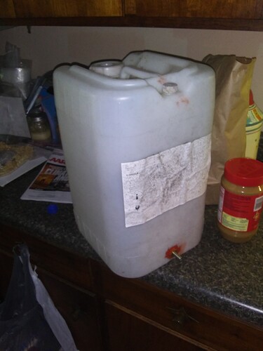

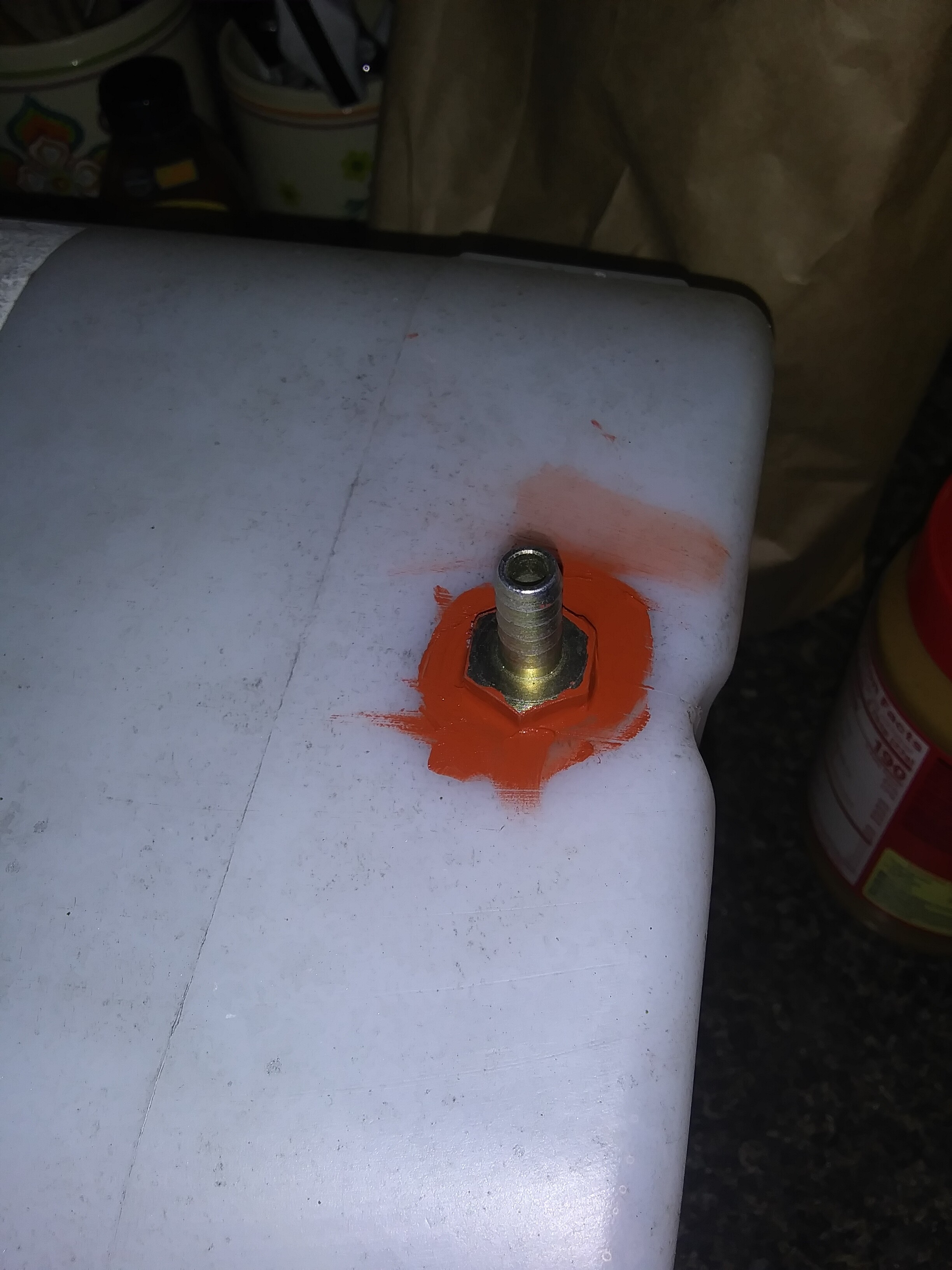

Got the drip tank made up. Used a step drill to make as tight of a fitting hole as I could.
It’s tapped into there and I’m using silicone to seal it up further.
The little cap on the top I drilled an air relief hole into, and the big cap is obviously for filling up.
