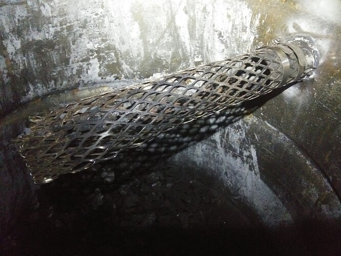

Got the flex hose attached. Also added the gas outlet screen like how Señor Ramos uses.
