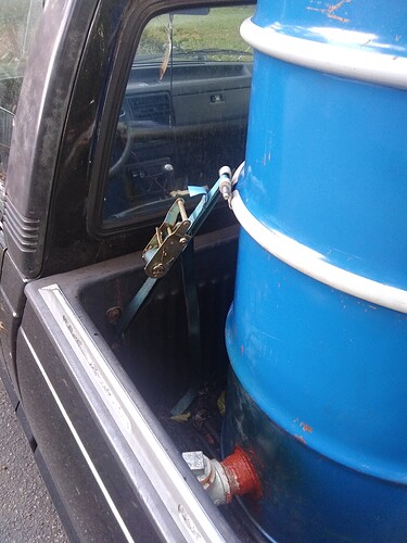

Here’s how the hoops are placed. Pretty sturdy and it’ll work even better when I get some turnbuckles and cable.

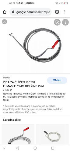

I had a rod trugh a firewall on my chevy other thain that l like to use 1.2mm SS welding wire for cables. Sturdy and smooth. For the cable housing l use this
Its a sink declogger.
