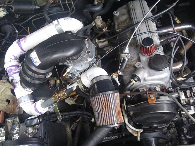

Okay so I finally got the ball valve to work. Cracked it open just a bit to take some pressure off of the ball. Reduced drag greatly. Got her all wired up now, finding something to make into a perch for the handle ends.
Another new problem arises.
I think the 3/4" is too small. I can only give it about 1/3rd throttle on gasoline or it starts to make the entire truck buck and stumble.
Must be too rich even with the valve entirely open.
Hi Cody, you need to go with a larger gray piling and a larger valve. Just saying. I can regulate my air with a 2" piping and a 2" slide gate valve. In parallel to that I have what you have right now for fine tuning my mixer.
If you will built a 2" butterfly valve you can do it with just one valve. The best valve to use in your position right now would be a butterfly valve right where the ball valve is right now.
You can make one with a 2" pipe a large Carter key and and 2" fender washers. I think it was @JocundJake Jacob or his brother Luke North that made one and showed how to build it on their on the open side of DOW.
I even need to build one and replace my slide gate with it. Because my slide gate cracked from use. A metal butterfly valve will out last the truck. I use that of them in my truck gasifer for wood gas and air control.
I need to rebuild that intake spot anyways.

Went back to the 1.5" butterfly since it worked just fine. Welded a valve arm to it so I could move it with the choke cable. Also finally used that 2" spa gate valve as my gas flow cutoff for shut down mode, I’ll get a choke cable for that eventually too.
