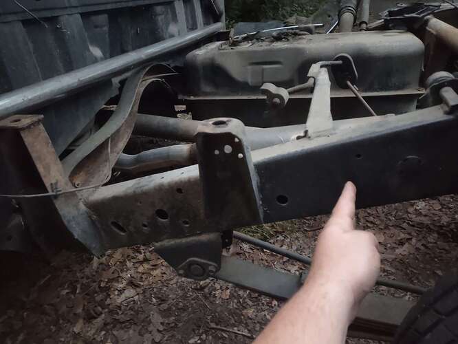

I really want to mount the gasifier on the side of the frame. With the exhaust in the way I can’t mount it inside the frame. I could always make a platform from the bed perches and mount on top, but I dunno how I feel about that, less height to work with.
Right now in between the perches I have a bit under 12 inches. If I move them closer to the rear wheel I get 15 inches.
I want the gasifier mounted so it fits between the perches, with ears welded to the body to bolt it down securely.
My lazy side wants to just put the gasifier in the rear between the rear cross member and bumper.
I don’t have any steel to build a platform up front for a gasifier to sit on. If I did I’d still cut a hole for it to sit through for cleanouts.
Would be fun to build a rear mounted and have a chuck wagon bed.
I thought Don Mannes rear mounted a unit on a S10. Might be worth a look.
I just checked and Don has it taking up the center of the bed. Not a bad idea. I should just hunt for some square tube and make a mount like Jakob did with his flatbed.
John Stout’s Woodgas Rat Rod has it mounted in the back.
I would run the exhaust up the side of the cab.
That’s brand new exhaust, I don’t wanna mess it up. Plus it would put the gasifier too close to the gasoline tank for my own comfort.
Substitute the word gastank for the word badges. Watch some Roadkill and strap a 5 gallon plastic can to your front bumper.
