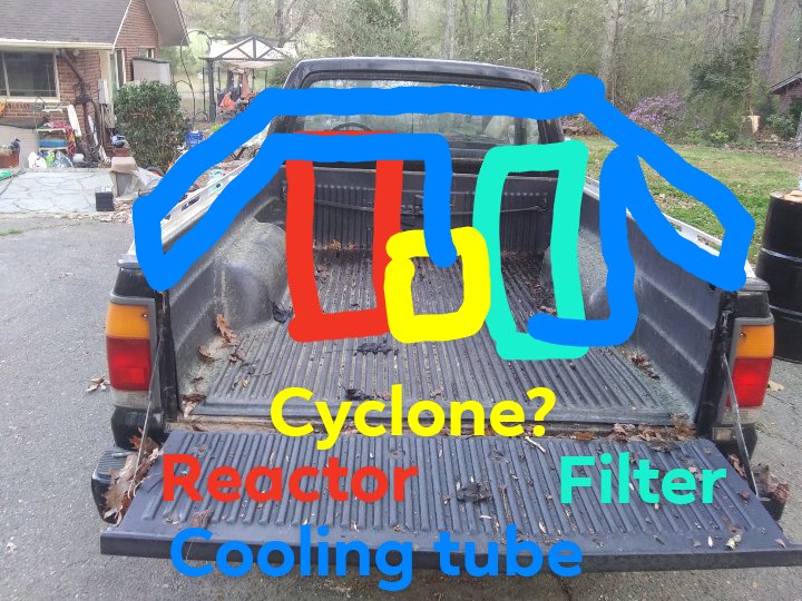

Yes I’m using the air cleaner housing to mix the woodgas and air. It already has a nipple for where the exhaust preheated air came in but now that I have removed the emissions stuff it is available to use. I plan to use cooling tubes along the bed, probably 4 total the length of the bed, going from Cyclone(or expansion chamber/drop zone), running along the bed and then the filter. I might run hay for any moisture and then a sack filter then plumb it to my engine.
I’ll take a photo of my truck and draw the form factor over it in a moment.
