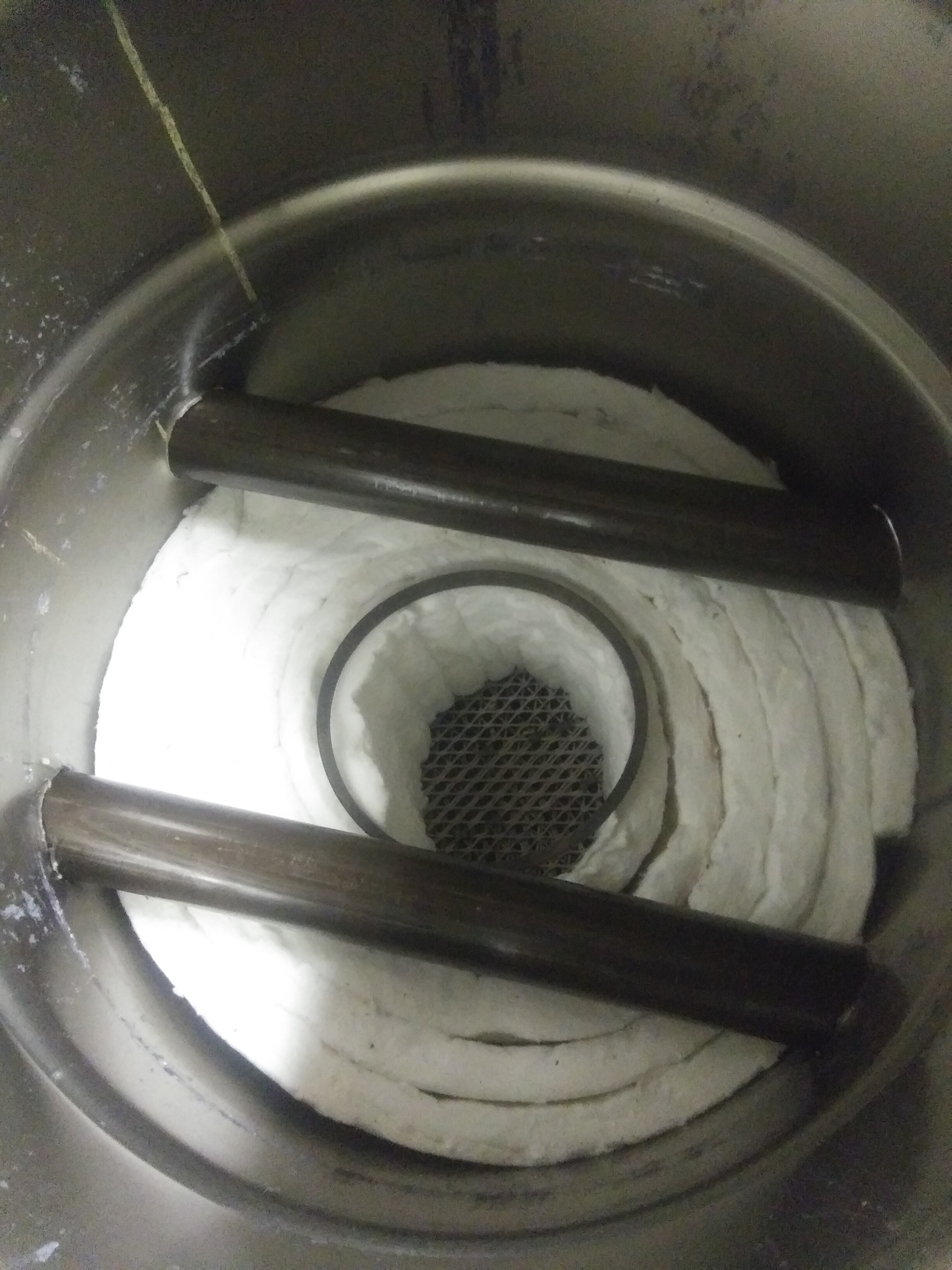

Alright drilling the flute holes tonight. Closest I have to 8mm is a 5/16", about 7.9mm. Or should I go with a 3/8" hole or 9.5mm
EDIT: I drilled 3/8" holes
I use a piece of fiberglass stove gasket tied through a loop in a long piece of heavy wire with another loop in the other end for a handle. Put some kerosene on it, light, and stick it in the flute. With blower running, I hold it under each hole for just a bit to light each one.

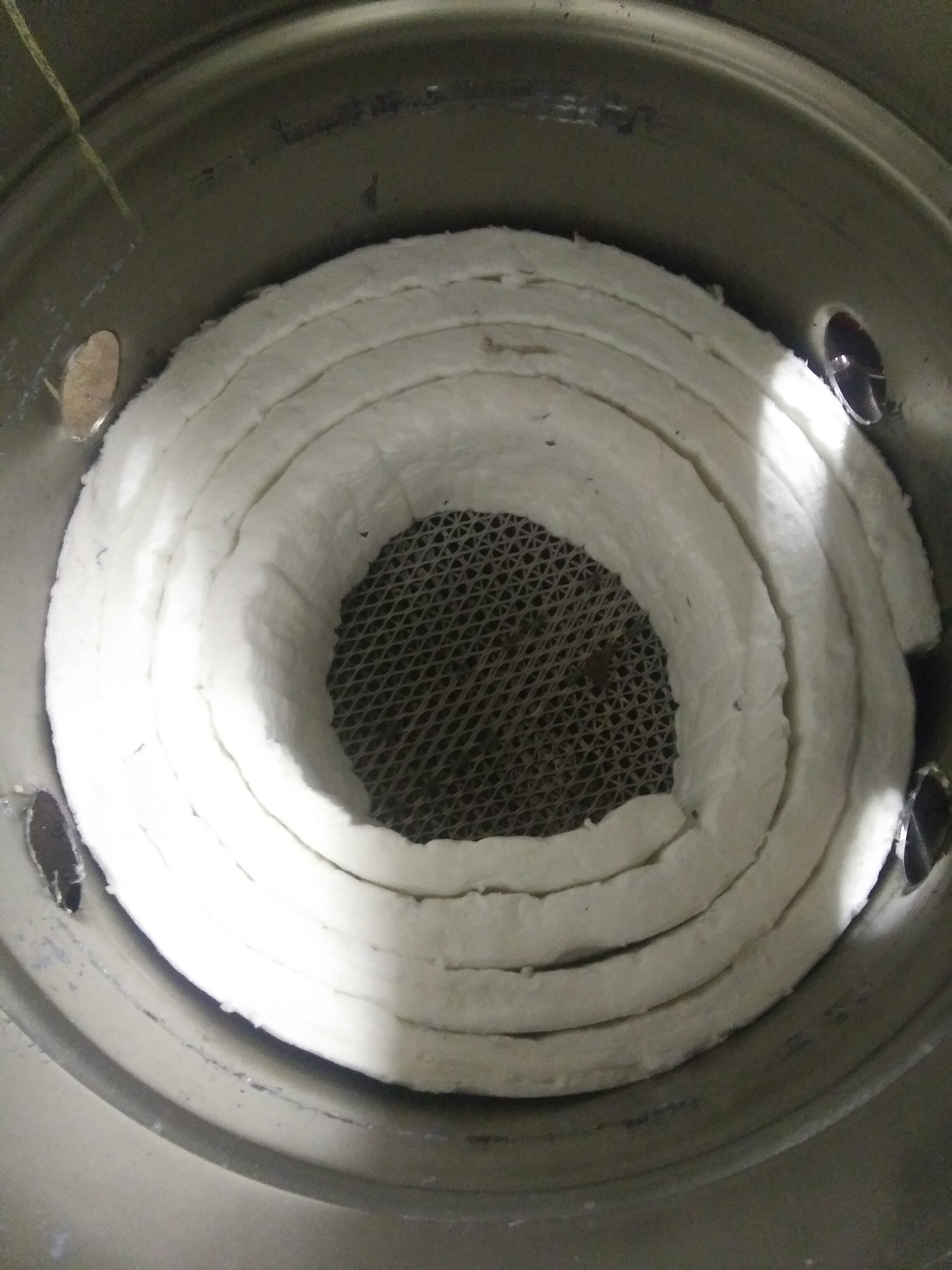

Right now the burn tube ID is about 12ish inches. I have more material I just cut off from the lengthwise side of the roll to see how far it would get. I’ll reduce it down to 8 inches since the distance from flute to grate is also only 8 inches.
There we go. Just need to find my muffler sealant for the flutes.

Instead of the ceramic wool, just let the charcoal lay in place of the wool. If you want a reduction hole cut a plate out and lay it on top of your mesh grate. That wool will make a mesh in the gasifer if no covered with metal. Ask me how I know this. And definitely ware a mask when working with it, it is nasty stuff on the lungs.

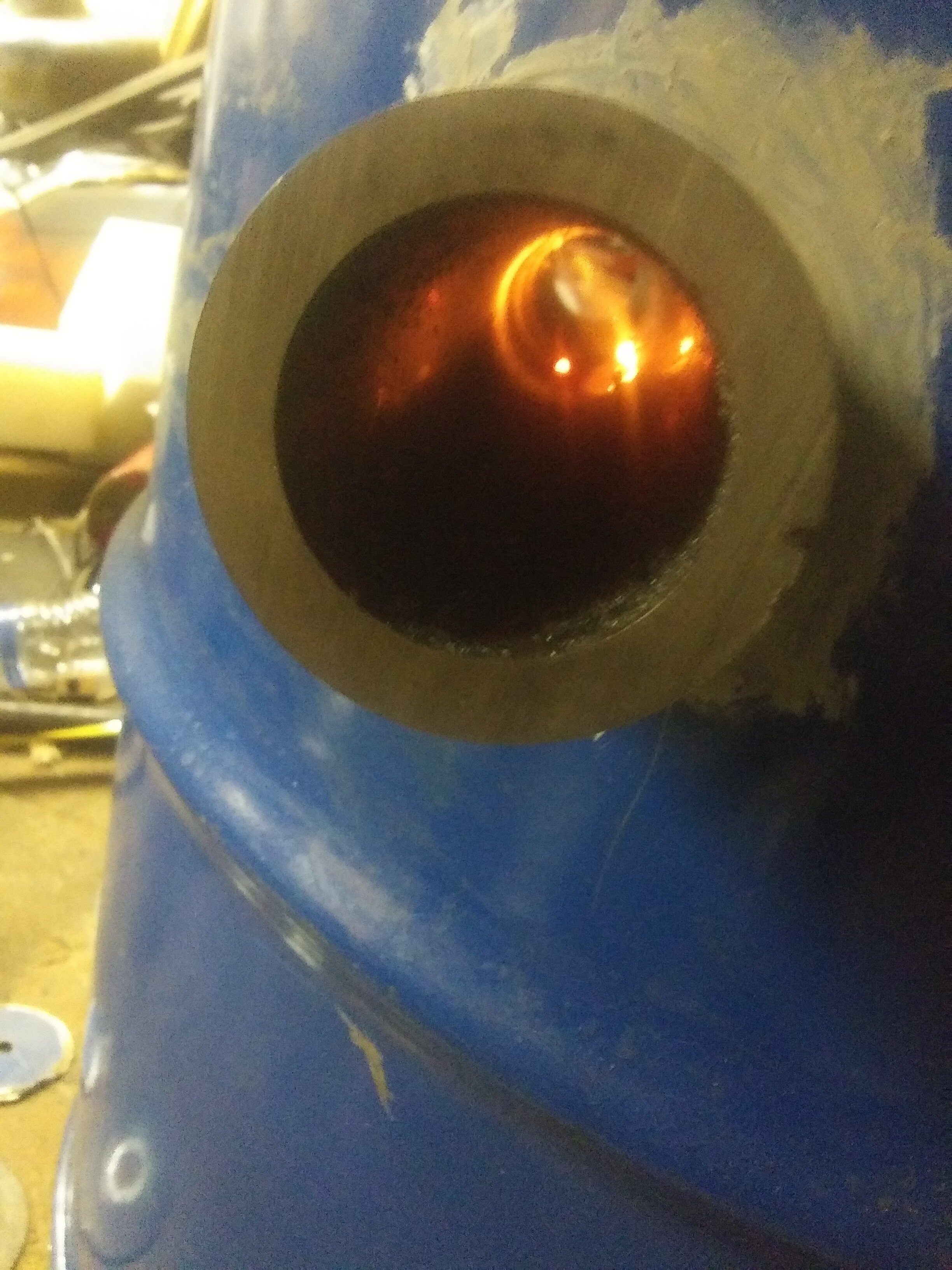

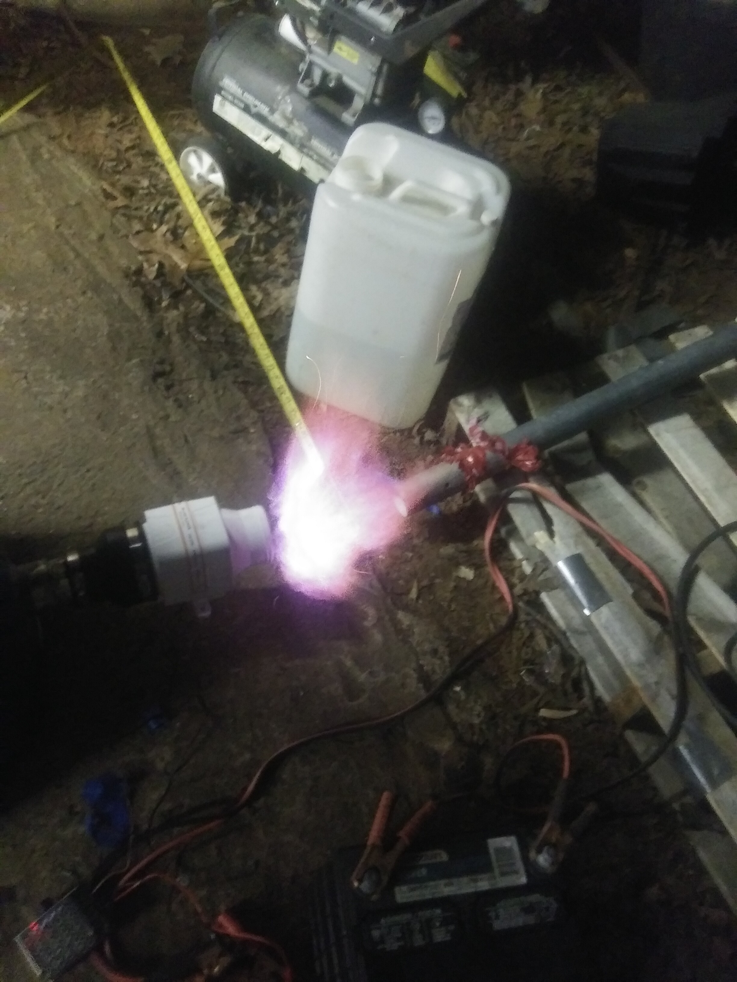

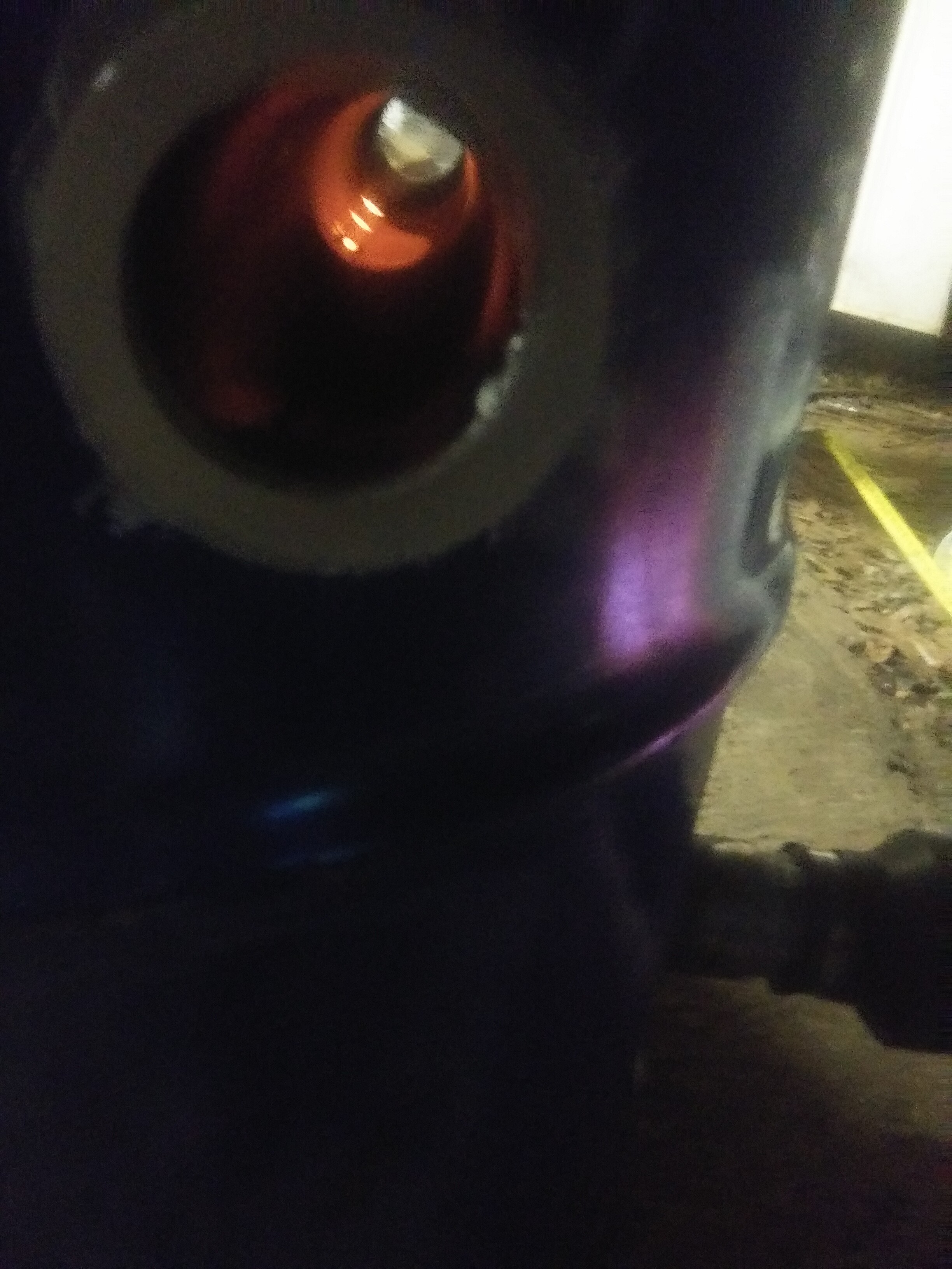

It’s working! It began to slightly light at just a minute in and then sustained flare at 3 minutes.
I shut it down because my sacrificial bilge pump started making noise. Didn’t find metal caps yet so I stuffed orifices with ceramic wool chunks and poured some water down the flutes. Ran it for about 8 minutes or so didn’t keep track of time after flare lit. This is dry very coarse and engine-spec mixed charcoal.
No bigger than my thumb sized charcoal but still pretty big for most.
Looks like good color on the flare nice work :+1:
It isn’t filtered yet, fan got sooty obviously. I don’t have a trommel yet to knock out the dust. I’m surprised it ran with how coarse this charcoal was.
And yeah I think I’m going to remove the ceramic wool. The refractory i ordered to give it a hard shell isn’t rated as high as the wool and I’d hate for it to crumble while going down the road. Plus it should give me more capacity.
