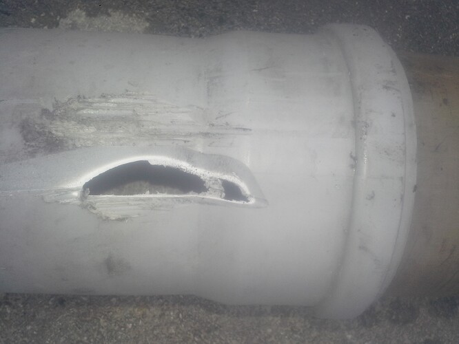

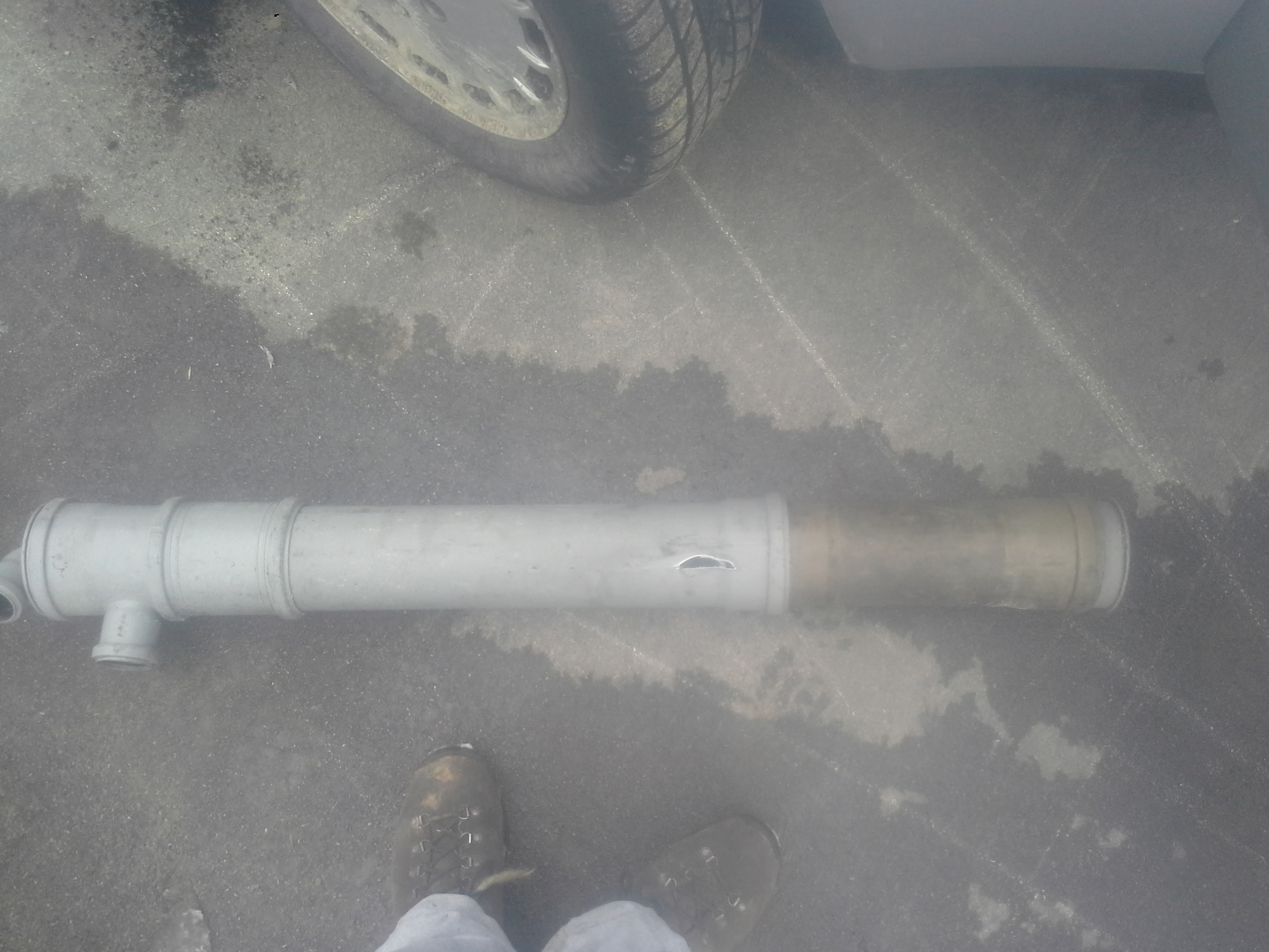

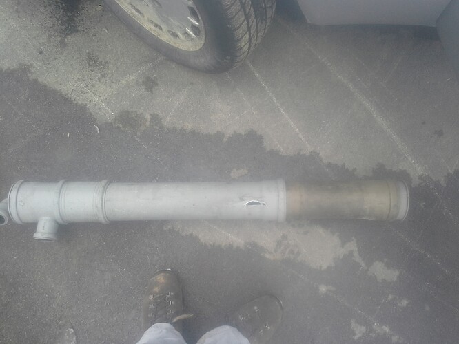

Had problems with lean gas mix lately (remember-l have a fixed air setting), bad idle, slow startup… so l investigated and found a brounish filter cloth. It seems l got a tarry bach of charcoal in the hopper and it ended up in the filter. No worryeas, easyer to change a felt sack thain a engine.
I am actualy wery pleased as this felt cloth seems to work as a safety filter for tar!
The felt sack, althugh a bit brown and stiff from tar, still feelt no resistance when hooked on a shopvac. Hmmm something else is goeing on. I folowed the golden rule in gasifier troubleshooting, first check for air leaks.
Bullseye.
A snowbump must of pushed the filter houseing up to touch the belt puley and it made a nice hole in it.
New pipe was connected and it runs strong and crisp once again!

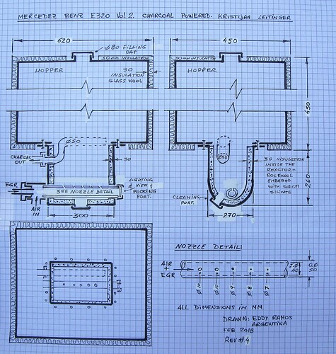

Hi everybody:
Working closely with Kristijan, he very kindly, accepted to share the details of his reactor/hopper with you all guys. He is a generous man.
Krisitjan, let me thank you in my name, and on behalf of all other people that may use, now or in the future, all or part of your build.
Eddy Ramos (Argentina).
PD1: Same will be for Bruce Southerland, who also kindly shared his info.
PD2: Kristijan. I will like to make a drawing of your filter. Can you send me the dimmensions?? Thank’s Eddy
Thank you Eddy for taking time to make such informative drawings. I am from the very old school and these types of drawings make the most sense to me as apposed to computer generated 3D drawings. TomC
Hi Kristijan,
I see that you have only +/- 25 cm between the nozzle and the exit of gases. I think Koen recommends 50 cm. Does not the gas come out a little hot?
the 5 holes of the nozzle are of decreasing diameter, remarks you a better distribution of the fire in the firebox of the gasifier?
Thierry
The thanks goes to you Eddy, for all the time invested in your drawings!
Trierry,
Normaly 25 cm wuld be much too low yes but dont forget this is multi nozzle gasifier :wink: so instead of haveing one long reaction zones l have 5 shorter ones. This lowers it conciderably.
Edit, oh, nozzle diameter. It was observed with same dianozzles that the last pnes had more flow thain the first. Thats becouse the rushing in air hits the wall and builds more pressuure. This configuration equalizes all nozzles to the same power.
