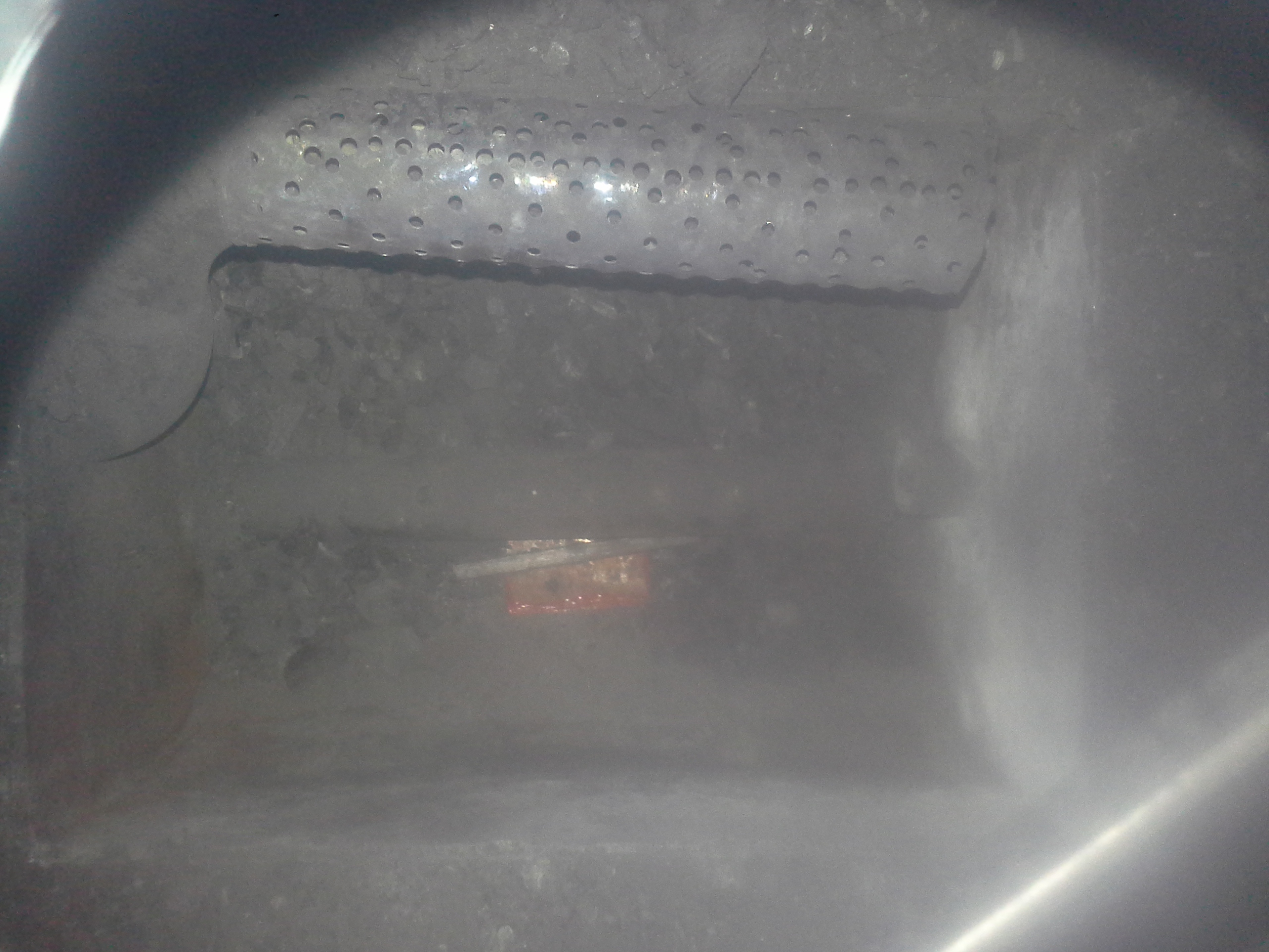

I installed a emptying hach on the bottom of the gasifier yesterday, ash acumulated over the last month making startup harder.
There was about 5 gal of ash inside! But wery litle clinkers.
I wanted to make a closer picture of the nozzles but l culdnt reach down there.
Anyway, thenozzle is intact. The new hach can allso be seen in tge picture.
Allso, l damaged the rockwool lining while poking the other day, so l had to take it out. Will see how it works with just char/ash for insulation.
I have not lived on the dark side, but wondered-- 5 gal of ash between the nozzle tip and the gas outlet pipe-- doesn’t the ash smother the fire at the nozzle? TomC
I don’t think we ever saw the perforated outlet manifold. Never plugs?
How much ash/soot does the cyclone catch compared to the amount of ash in the gasifier?
Tom, for me it tends to tunnel through the ash until it sniffs out charcoal.
