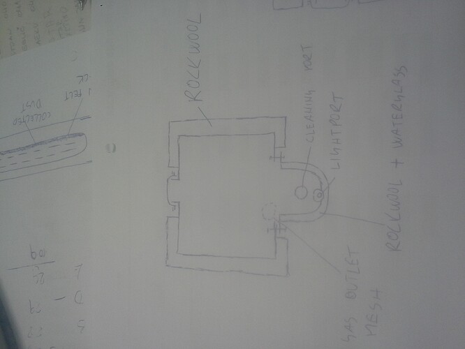

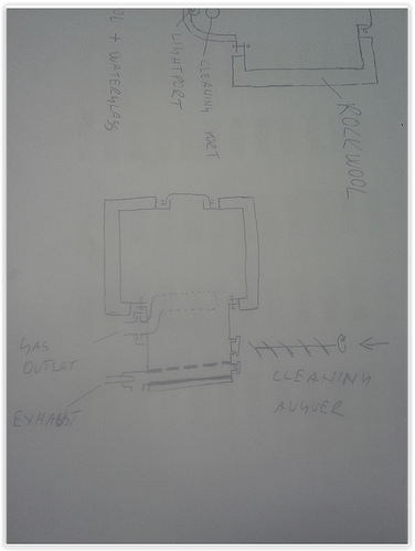

Hi Krisitijan.
Do you mind if I can try lo layout your chargas gasifier system?
Truly yours.
Eddy Ramos
Hey Thierry,
What leads you to think of charcoal being damp?
I dubt it thugh, i use freshly baked ringing charcoal.
Eddy, by all means, if you need any help let me know.

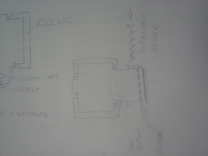

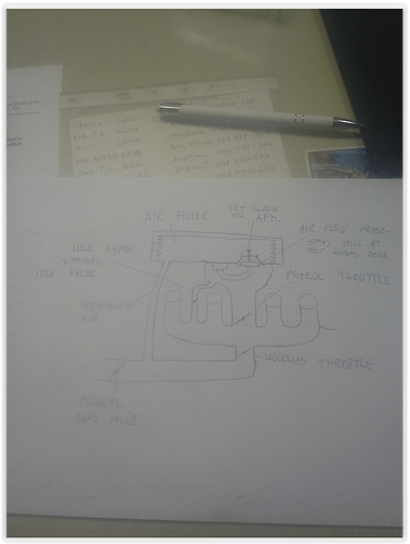

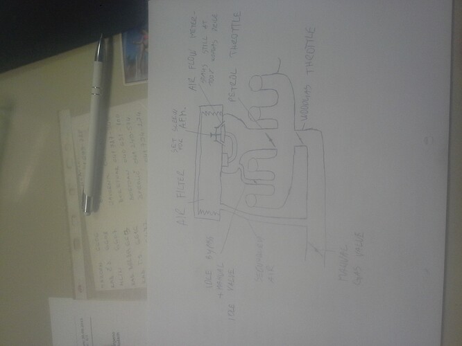

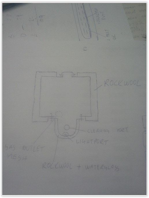

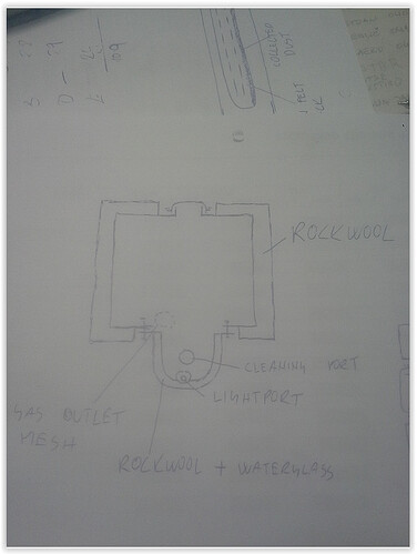

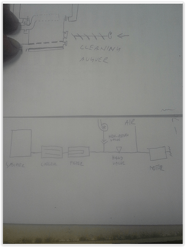

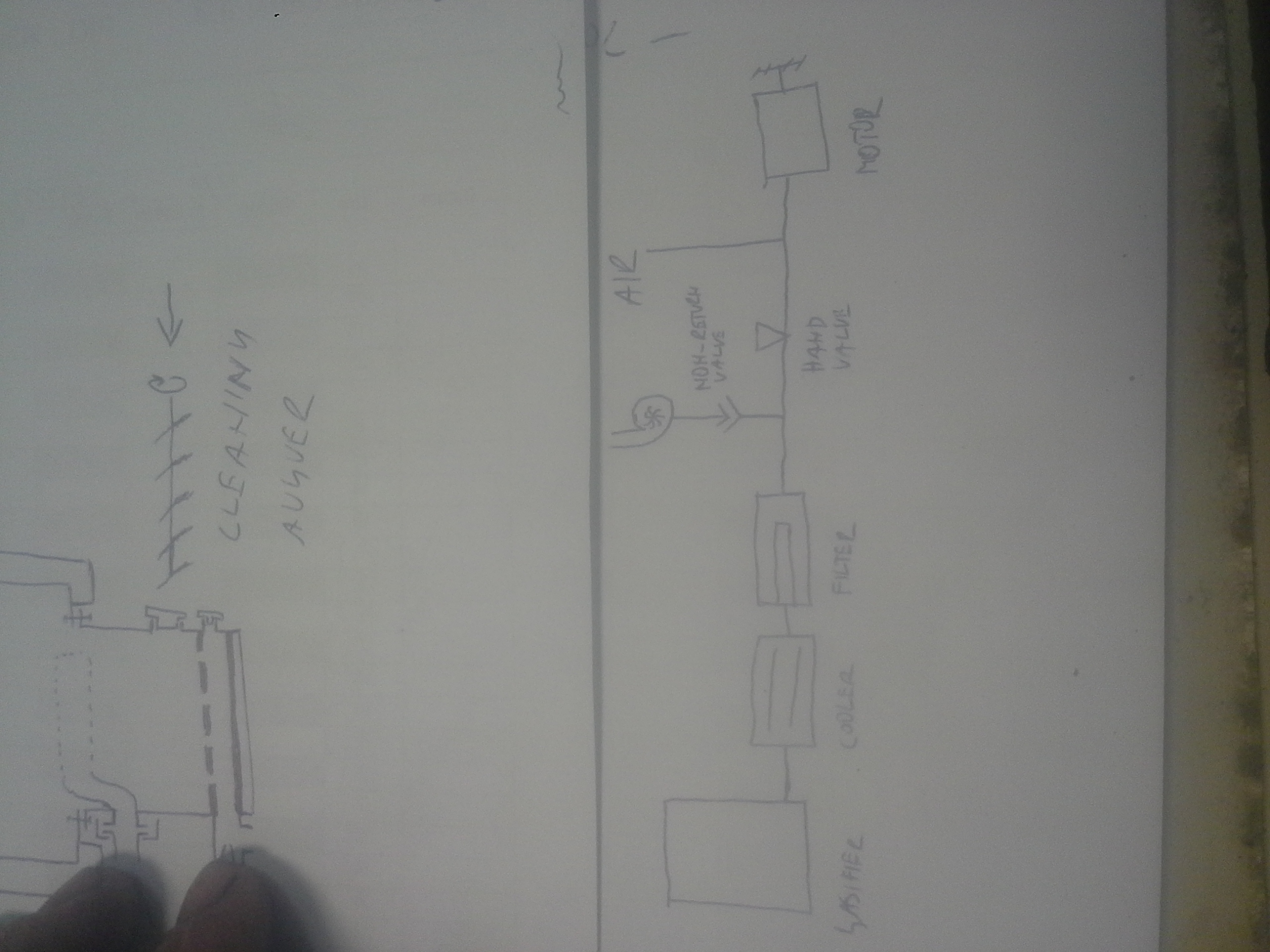

Hi Kristijan:
Thank’s for your permission to make a drawing of your system. Actually, I was amazed by your horizontal nozzle long time ago, so your gasifier system was the first one thatI tryed to draw, but I have being following you on this and other topic, specially the Nozzle one but it was and is hard, for my, to complete understand how your systems works. I think that the best way for me to start a nice drawing of your design is if you can hand draw a very basic sketck of your system, so then we can go from there.
Looking forward for that.
Best Regards.
Eddy
PS: Make a very basic drawing, take a picture (JPG) and upload the photo.
Hope this helps! If you need anything else let me know.

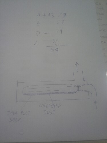

Hi Kistijan:
Thanks for the sketches. I will star working on this and will start shooting you with some questions.
B.R.
Eddy

I drilled aditional 4 6mm holes in the poking rod. It seems to work great! However, l did empty the gasifier before the trip just to be safe. I cleaned out the britle slag that the vacuum poker can not extract. Allso, l had a lot of dust in, it wuld be hard to vacuum it all. Its nessesery to vacuum the dust out regulary.
The poker works for light dust and ash, but periodic emptyings will still be nessesery. Thats why l will make a biggee emptying cap on the bottom and clean with a 2" auguer.

Hi Kristijan:
I started working on a drawing of your system. I have some trouble understanding it. Do you have an e-mail address so I can shoot you with hundred questions and drafts before we can post here the final results?
Eddy Ramos.
Eddy, l sent you a pm here on DOW, we can arrange things here.
Thank you
