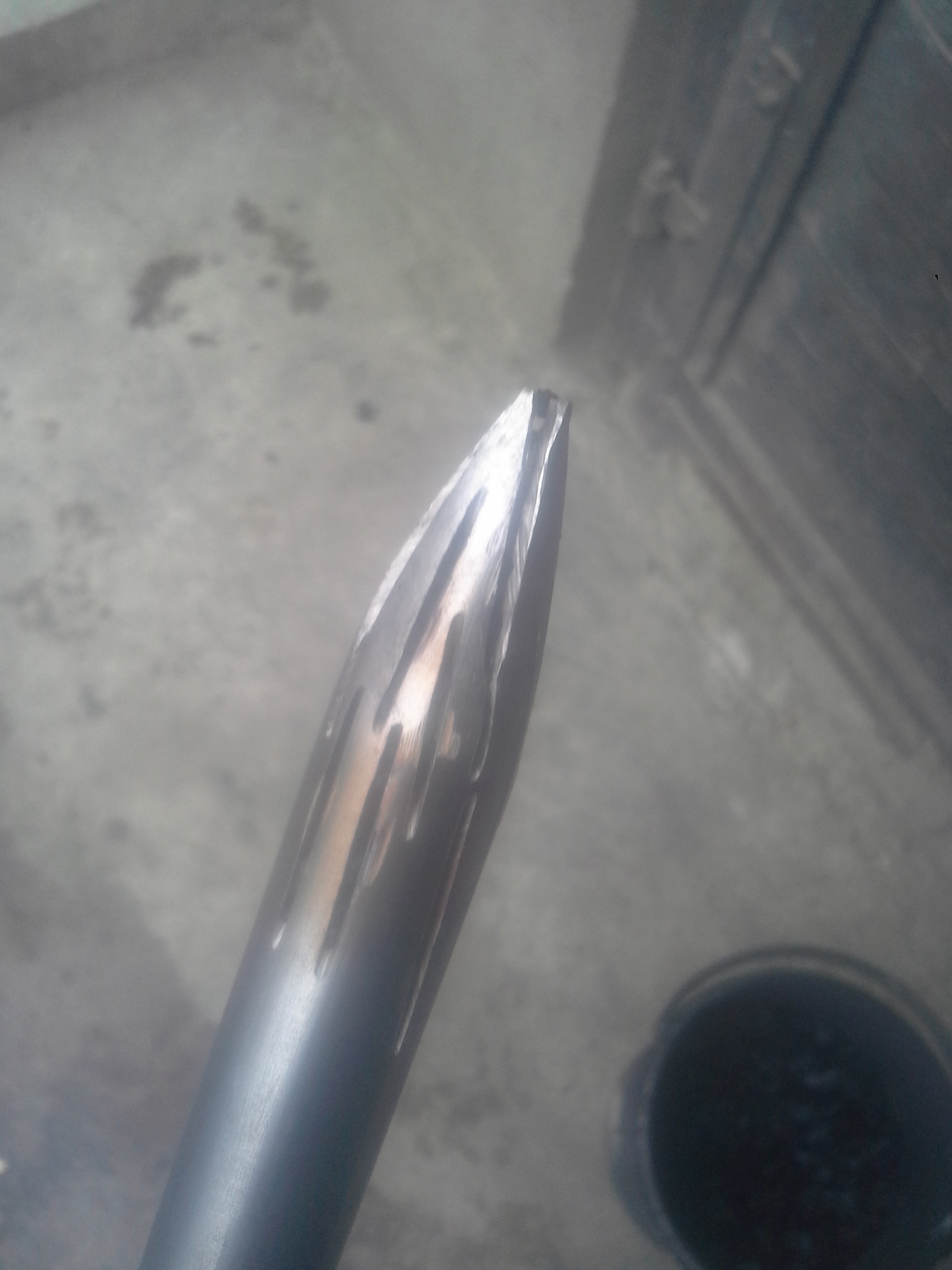

The dusty gasifier simptomes are starting to show again. Long hard lightup and a hot hopper.
I tryed the auguer method Don and JO use on their gasifiers, doesent work well enough. The auguer expells just clean char as the dust makes a cone in the gasifier.
Plan B.
This is what l came up with. Its a 1/2" pipe poking rod hooked to a vacuum cleaner. I hadnt had time to test it on the gasifier, but tryed it in a bucket full of dusty unscreaned char. You just start the shopvac and poke trugh all the char. Dust gets sucked while char cant suck trugh. Works well, althugh clinkers will still require periodic hopper emptying.
I´m sorry the auger didn´t work but that SVP (Slotted vacuum poker) looks like a winner. Clever!
I bet that will work.
Can’t wait to hear how it works. :smiley:

Easy servicing is always a key for a good and trouble-free operation. Hopefully your vacuum-cleaner-rod works, as this is a nice idea.
But if it doesn’t, maybe a clean out door at the bottom of you gasifier would help. You could empty it every week when it is nearly empty, just sieve the ash out and put the rest back into the hopper.
