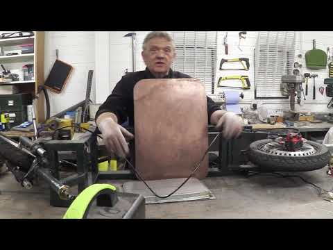

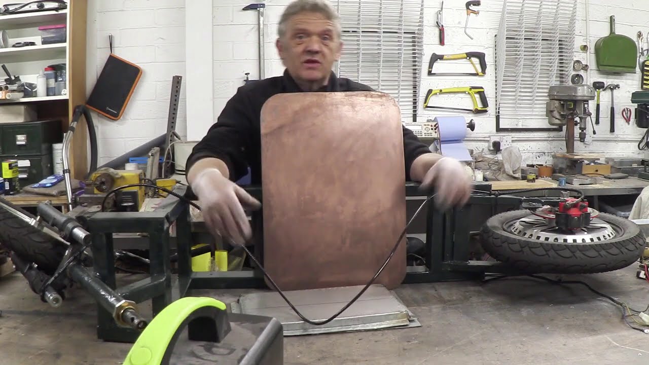

So l looked in to copper plating and found this.
The copper lair is probably super thin and most likely wuld even rub off but it can probably be reaplyed periodicly. It seems super simple and cheap to make but has anyone ever tryed such a thing?
