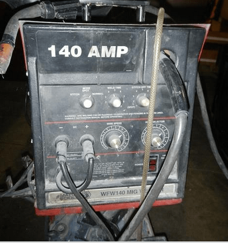

My Matco has stitch control for thin metal where I can variably set the weld time and stitch off time. This does a nice job of welding thin metal without burn through by letting it cool off between pulses.

Don, that Matco with the stitch timer looks good.

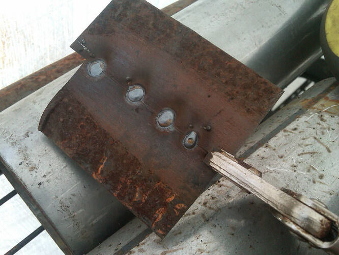

I got my new regulator/flowmeter today and tried doing some gas welding on some really thin stuff (metal banding material). This stuff looked like swiss cheese when I attempted to weld using flux cored wire, so the gas certainly does make a difference… However, I am still having an issue with either the rust or my wire speed or gas flow… I have to really brush the rust off to get a weld that don’t have burn holes. I would like to weld through the rust to save time, but if the metal is rusty, it just don’t come out as smooth. Is rust removal always required as standard prep ? It don’t seem to be as big a problem on thicker metal, but is much worse welding thick to thin if rusty.
