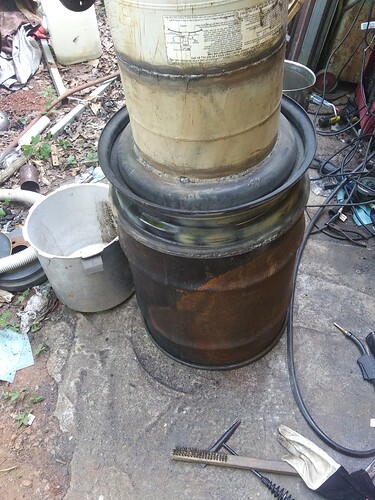

Finally getting some more traction. I have the car rim welded on, I’ll add a condensate gutter there and then the 20 gallon drum. I’ll probably use Joni’s venturi ejection system with this.

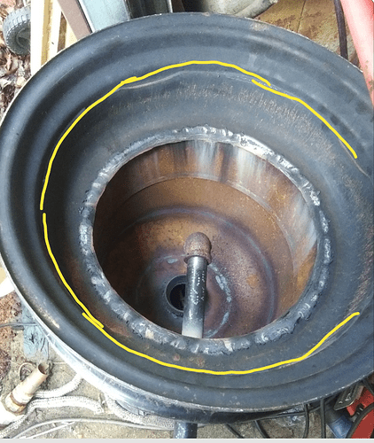

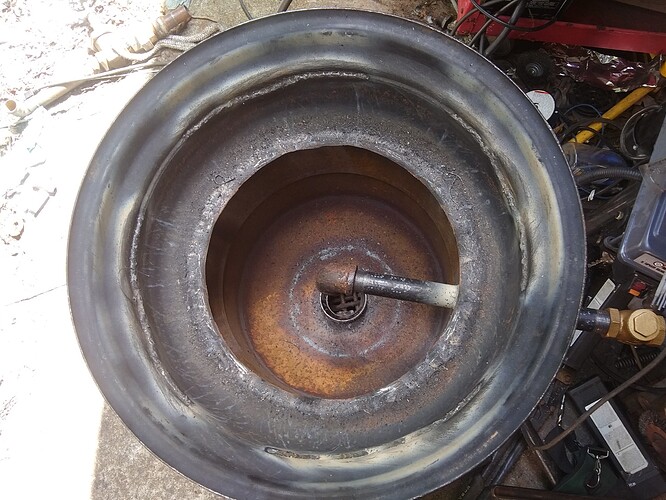

Made sure the car rim was sealed up. It only had a few beads so I just closed the gaps with weld to be extra sure.

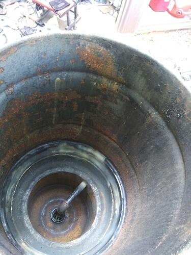

Hopper is welded on. I’ll be making a gutter later, something I can tap into place and tack weld. Maybe an upper gutter or line the whole hopper area with a narrow gutter with smoke holes for circulation.
Here she is rightside up. That aluminum pot is just my stand for it right now since it lacks legs.

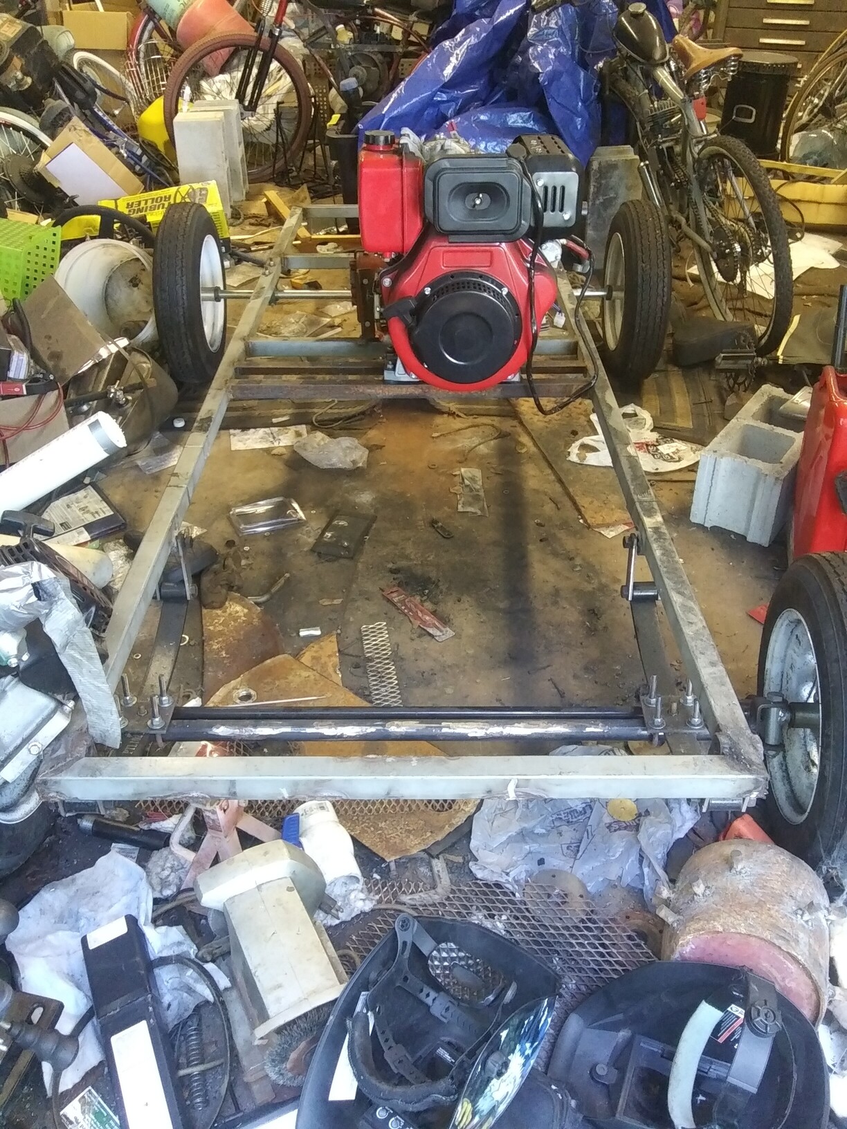

Also excuse the mess of my shop but here’s the rolling frame of the Trucktor. I’ll probably mount the gasifier on the Drinker’s side and my filter on the Captain’s side. Steve Bowman gave me what used to be the tub for a transformer and it has locking tabs, I think with a gasket made it’ll make a decent filter.
That Diesel will be saved for something else.

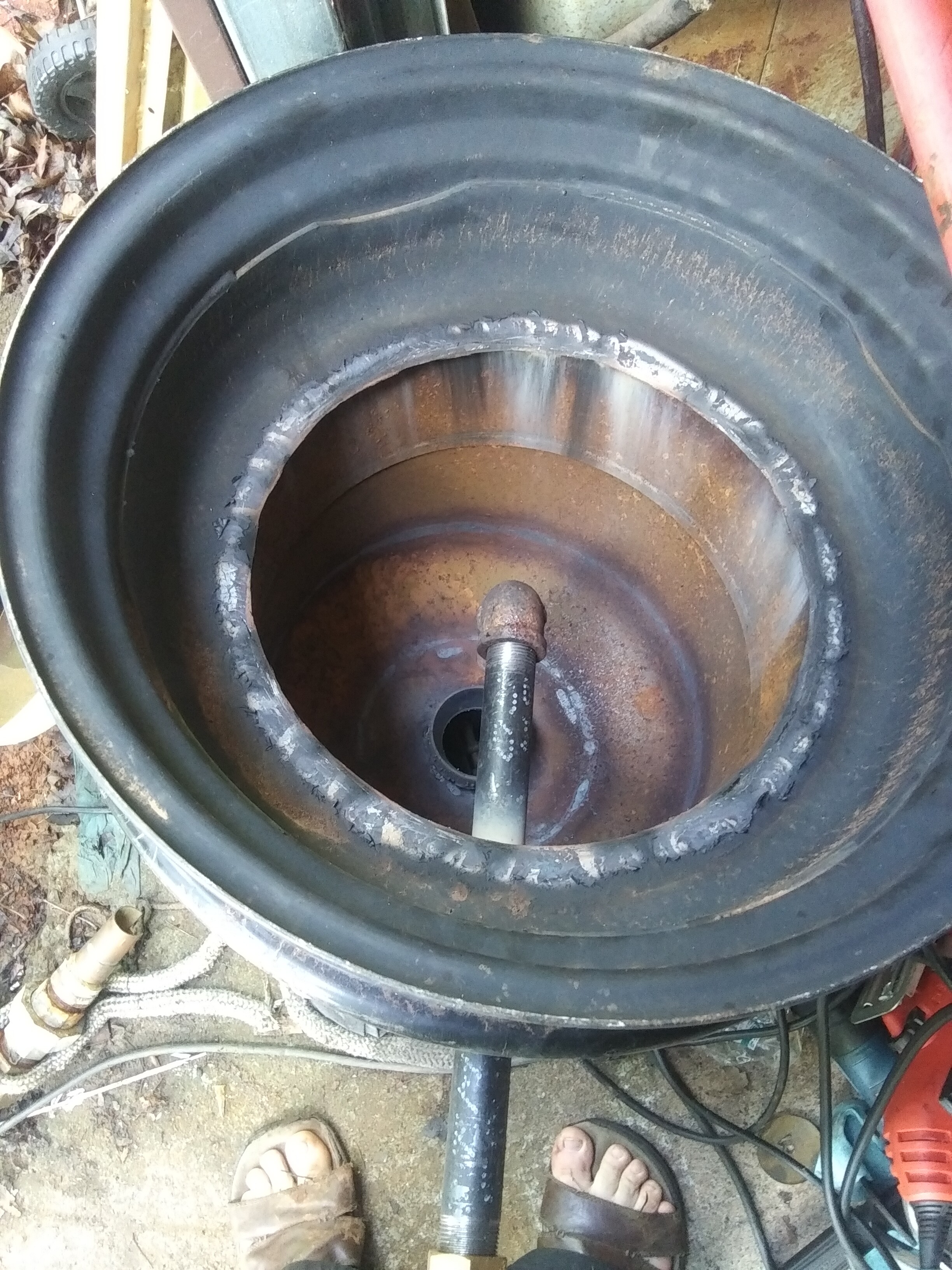

Leak tested, only 4 small leaks! I’ll take that as a victory. Used a pusher blower and drizzled soapy water around. Welded over anywhere I found bubbles.

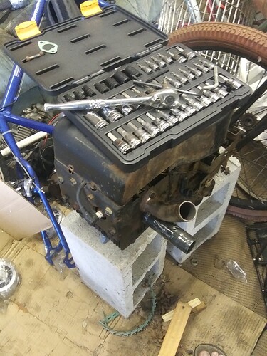

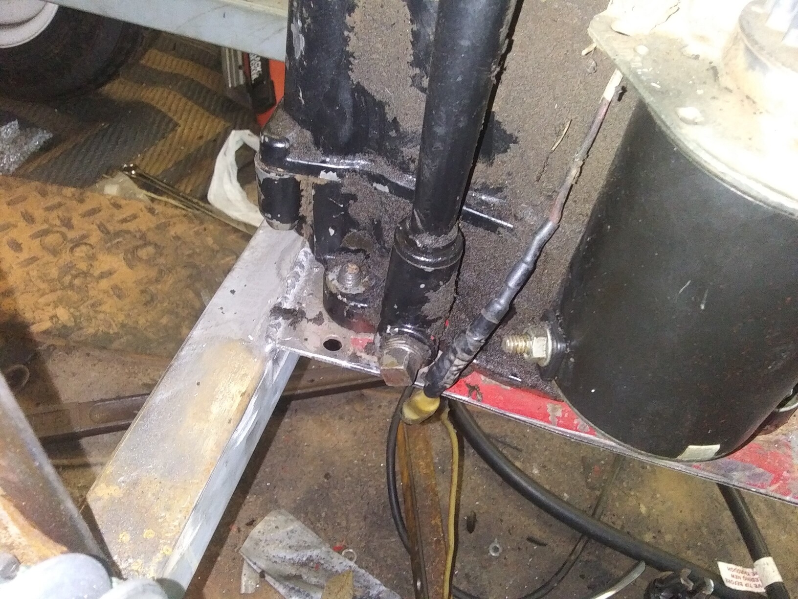

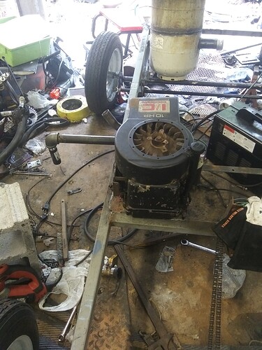

Cut the motor plate from the DOA Snapper mower. I’ll weld that to the frame for the Briggs engine.
Got the plate welded in and engine mounted. What luck the oil drain also has easy access too!
The guy that had this Snapper before me didn’t use the right bolts for mounting. Instead of coarse 3/8" bolts they used whatever 5/16" bolts they had laying around. Thank God the aluminum threads on the block weren’t goobered up.
