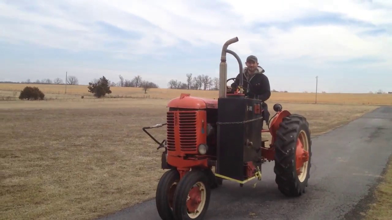

Here’s an S-80 unit on the side of a tractor I stumbled across .
Enjoy
Shrappy :smiling_face_with_sunglasses:

Did I see Wayne’s old Ford in the background with what looks like some new cooling rails?!!
Yes Tom . The old ford handles its age very well :blush:
