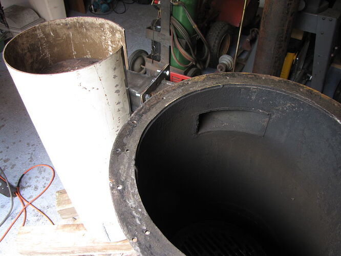

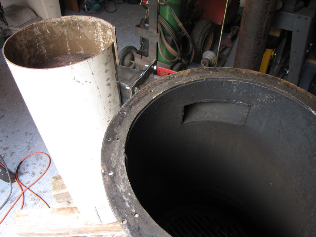

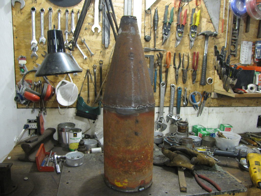

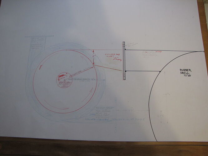

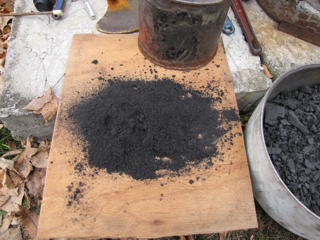

Your monorator did catch a considerable amount of liquid for a short run, but I was more impressed with the amount of carbon you caught with your cyclone. Could we get a picture of the cyclone and maybe some detail? Thanks TomC
Hi Tom & Wayne,

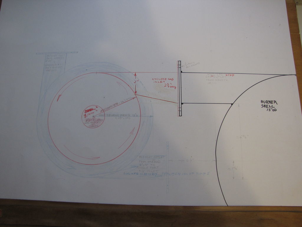

I was pretty happy with the results. too, considering the variation of a few dimensions to fit what I had on hand “close enough”. Sometimes that gets you. I used an 8" diameter fire extinguisher for the cylinder and built a cone the same length 13". I compared my dimensions to the design dimensions which you will see.
It works really good with no moisture in the cyclone, although moisture in the cyclone isn’t cyclone dimension driven IMO. I don’t feel a need to build another just to “hit” the numbers. That said, if I did build one to the numbers I would feel confident the performance would be just as good or better. If you check out my photo pages (page 11) there are more cyclone/preheat build pics. Click on my name here and on photos on my home page. The cyclone dimension chart I may have found when researching gek gasifiers. I like to draw full size when practical for a real life view and feel. The last picture was the end of 2 hr burn last year. Lots of heavier (atomic wise) particulate matter- very dry also.

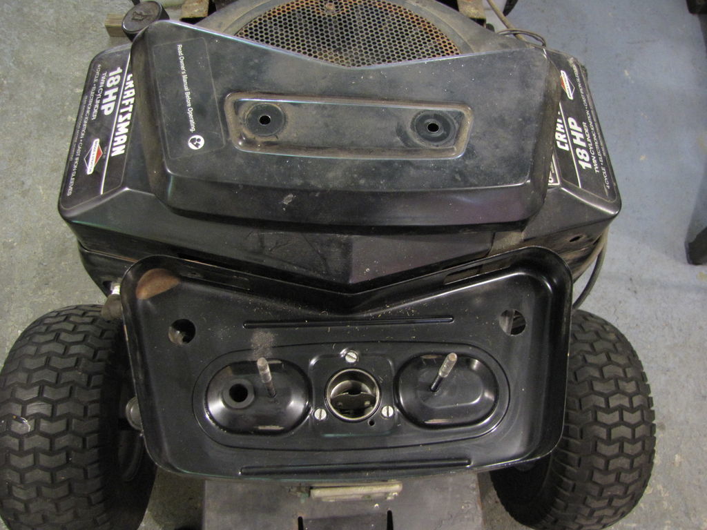

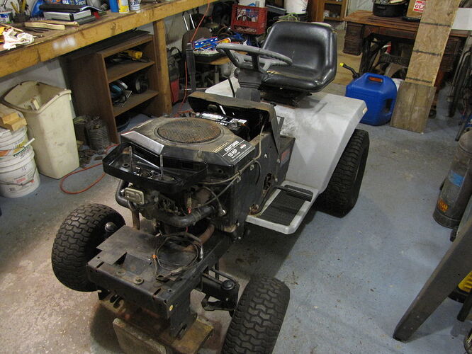

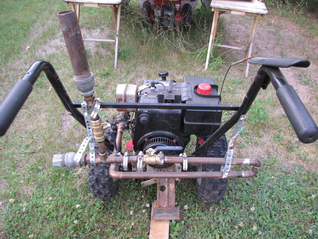

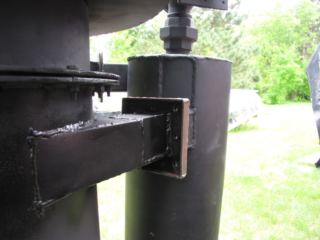

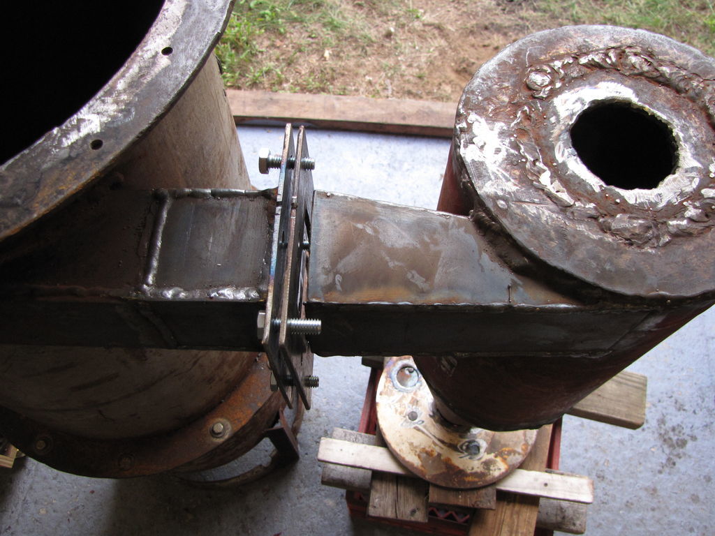

Pic 1. I got the 18 hp Craftsman started today. It jumped to life, how lucky for me. Have to replace the brittle fuel lines and fuel filter. Yes, all those pesky gasoline things. I want it running well on gasoline first. I’ll probably run the 8 hp Tecumseh snow blower for some burn time while I finish up with the rider. I know it’s an under pull but I have to see what it does. I gotta have some fun. Pic 2. I need to make a gasifier manifold to fit on the air cleaner supports.
Are your plans to put your unit on a trailer Pepe? Can you change the restriction to make up for the difference in engine size?

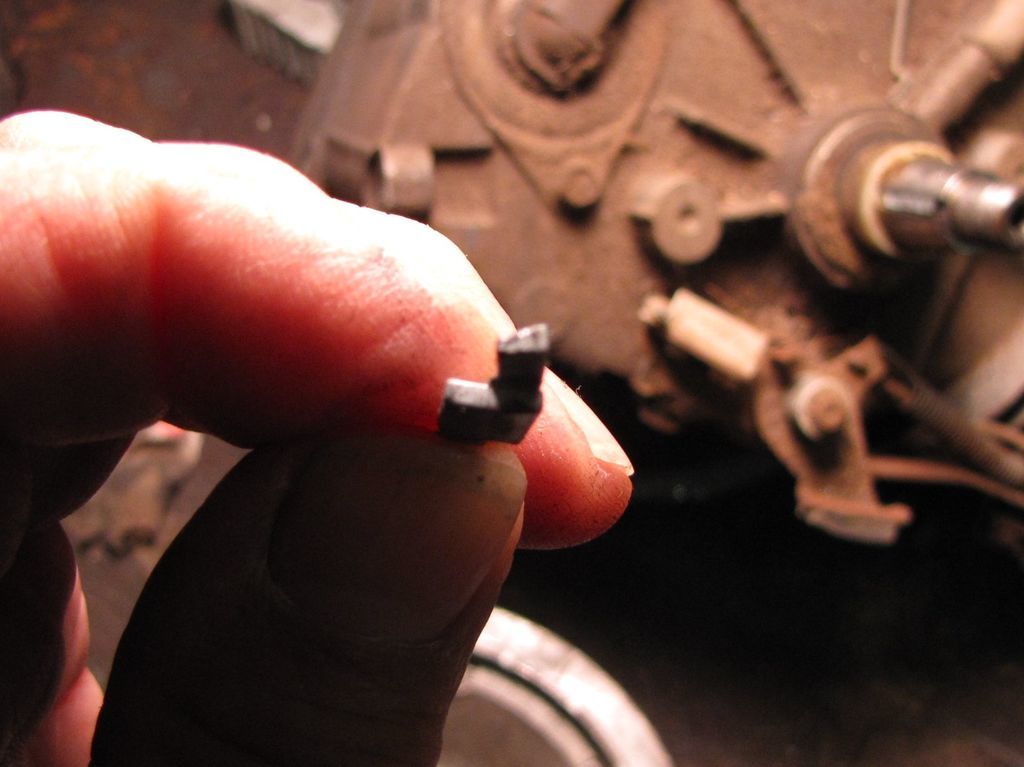

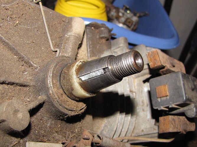

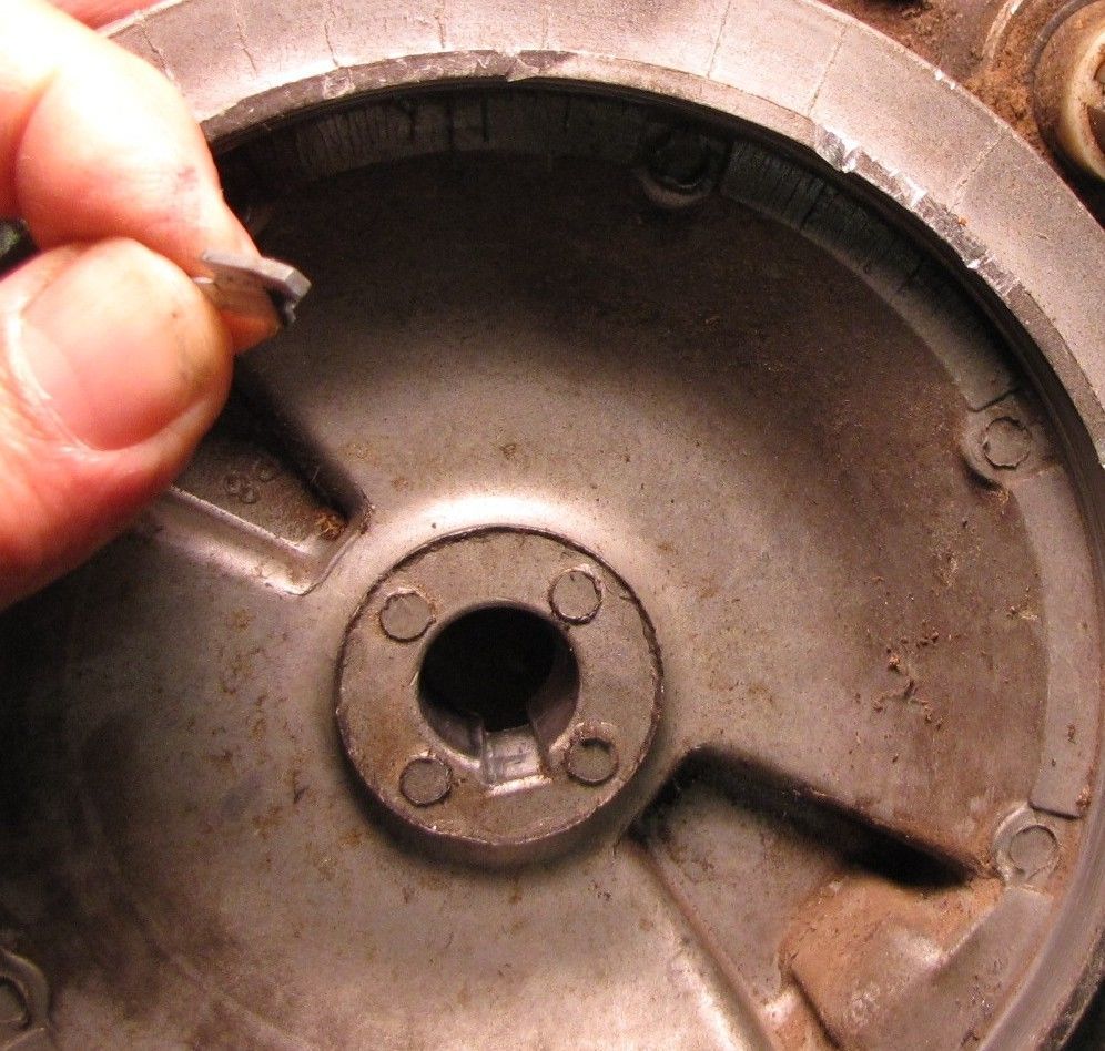

I just received my 8" 3 jaw flywheel puller and pulled a flywheel with a sheared key. I set up and torqued on the bolt quite a bit until it popped off with a loud snap. It was so loud I thought I snapped the flywheel. It was fine. I did however find a keyway configuration I’ve never seen before. The shaft keyway is 1/8" and the flywheel keyway is 1/4". The key is one piece.

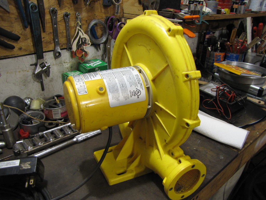

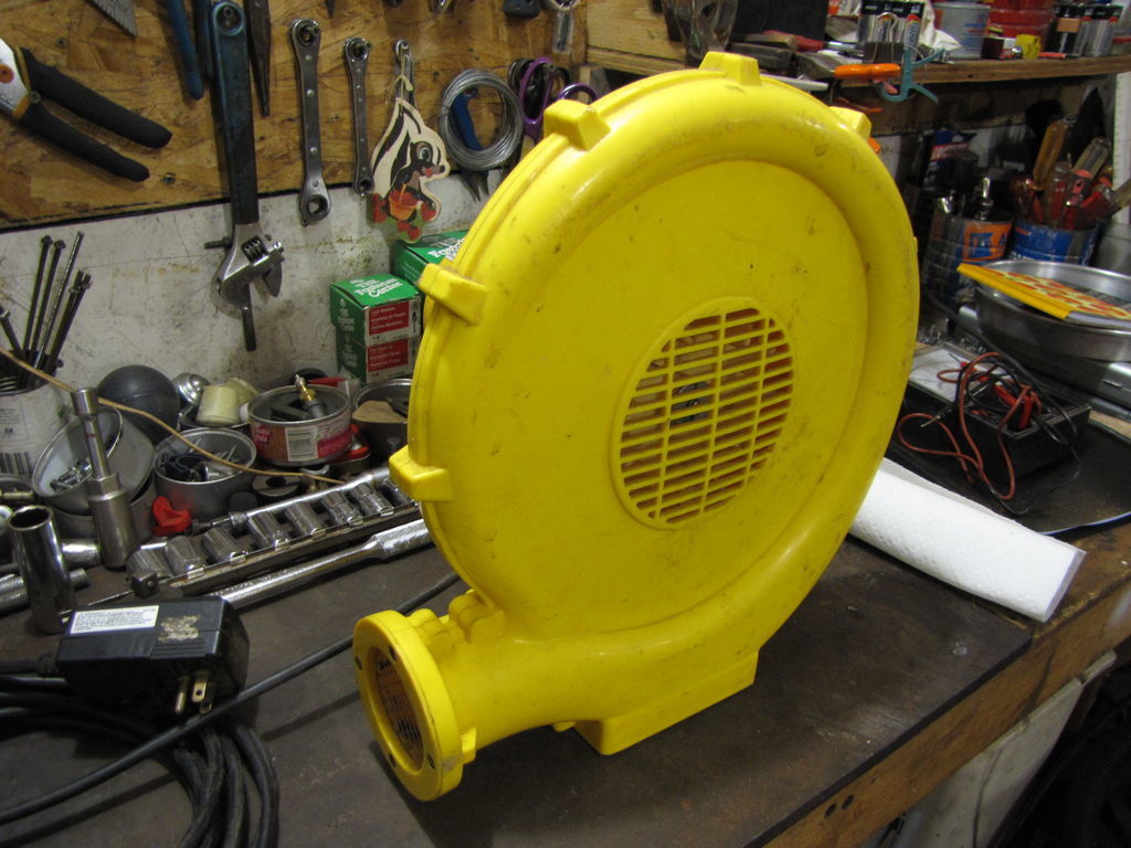

I’ve got a new fan blower to play with and adapt. It’s used to blow up play houses, etc, outdoor use, continuous use. I’m hoping I can control the fan speed.

Pepe, it looks like you could advance or retard timing depending on which way you insert the key.
Hi Don,
Thanks for the comment, it made sense, but I just found this gem this AM, after much searching

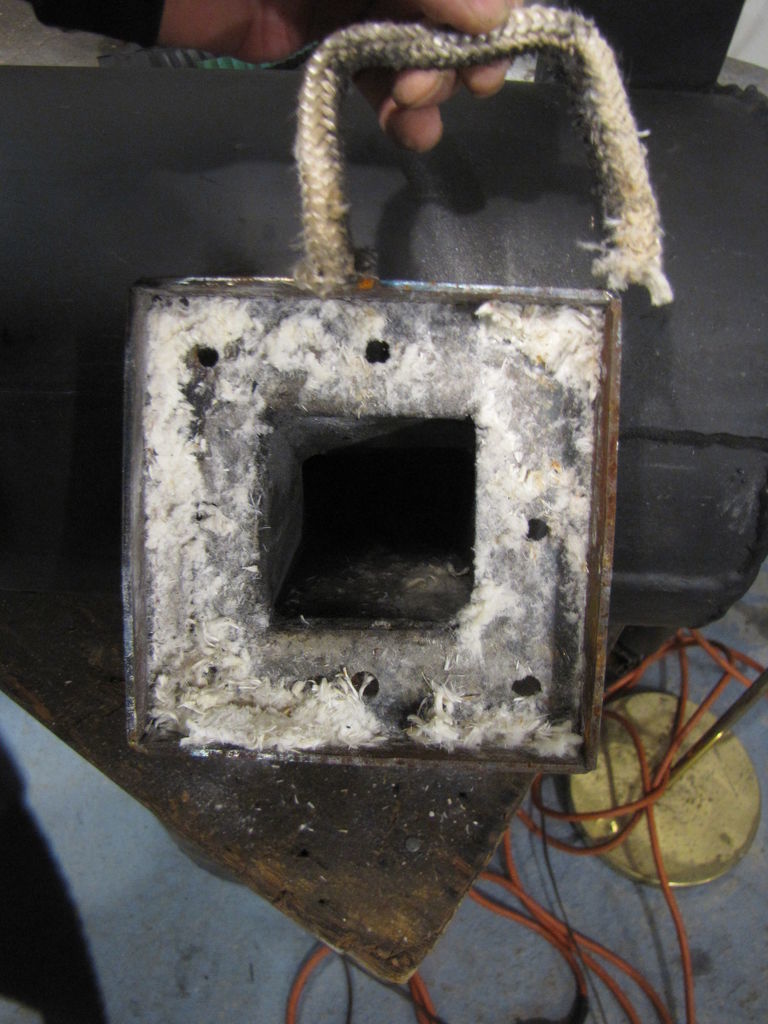

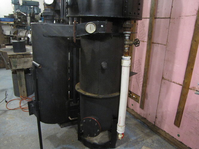

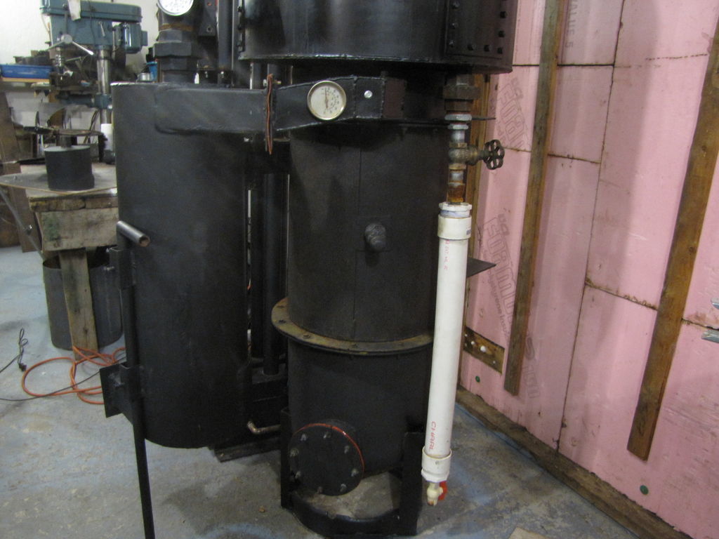

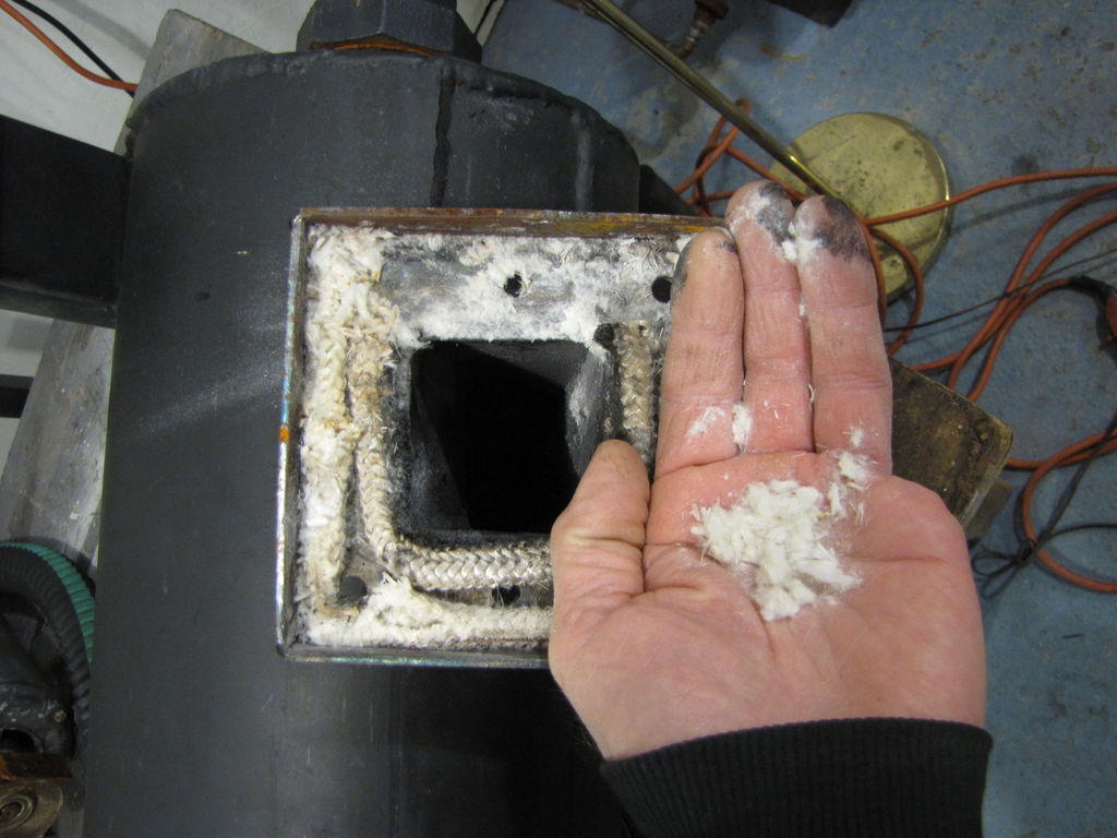

I finally got a few hours to set up my unit inside. I outlined all the bases on the floor with a magic marker for reference. Before I stood it up, I checked the burner to cyclone shroud gasket. It appears to have been leaking and gradually the heat ate up the wood stove fiberglass door gasket material I used. Thus the explosive flare starts I witnessed in the video I posted in my 08/01/2014 post @ 09:55 hrs. I’ll have to find something more heat resistant and/or reconfigure the connection. Maybe a sleeve type connection?
Here’s a short vid of emptying the ash collector on the cyclone with an appropriate notation to move on.

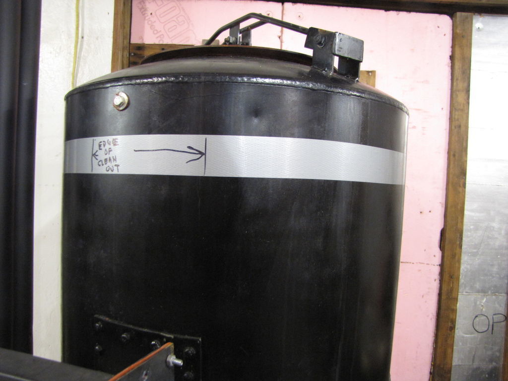

My next step is to layout the cooling tube number and locations on my monorator hopper. Later I’ll remove the preheat shroud and hoist the monorator hopper with burner unit off the base unit, check gaskets, clean out the char, etc. At this point I can also remove the hearth and check it or replace it with a different hour glass configuration. So far I like it just like it is. Gasket performance is my main concern. I’m also going to put a hinge and quick latch on the base cleanout door.
