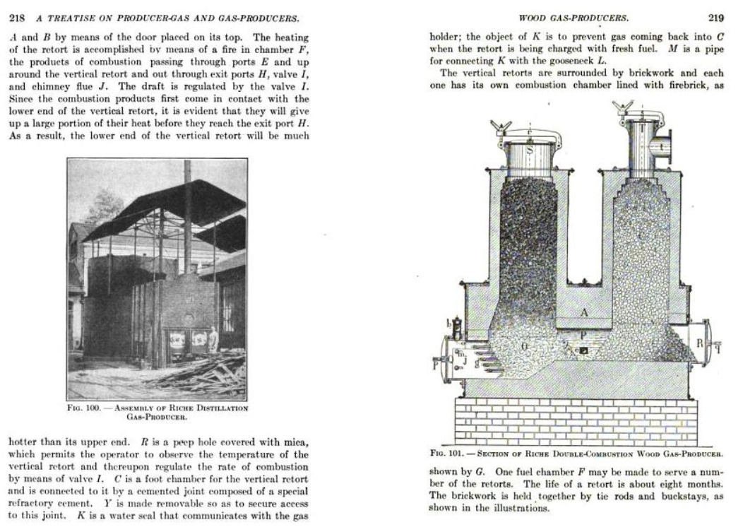

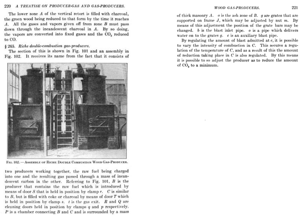

Just had a thought about how you could salvage your cross draft gasifier to run on wood. There was a design in the early 1900s that was essentially a cross draft wood gasifier fed into an updraft charcoal gasifier.
The unit consumed more wood than charcoal. Secondary air was added between the wood gasifier and the charcoal gasifier. The wood gasses were burned, which heated the charcoal to glowing hot. The hot char would crack any remaining tar as well as combine with the CO2 from the wood gas to form CO. The charcoal also functioned as a filter.
There should be a picture here.
It’s the one in the middle on the right.
I’ve seen other gasifier designs that incorporate this double burn concept in various embodiments, as a way of dealing with tarry gasses. If you’re going to use pine, it’s probably worth looking into.
I’ve seen a few variations that configure the air nozzles with a venturi that draws tarry gasses from near the top of the hopper. This helps make sure more of the tar is directed into the combustion zone. It’s basically burning the tar to heat the char, instead of burning the char to crack the tar.
Due to the venturi, some hot gasses will be drawn up into the hopper, pre drying the wood and extending the pyrolysis zone up higher.

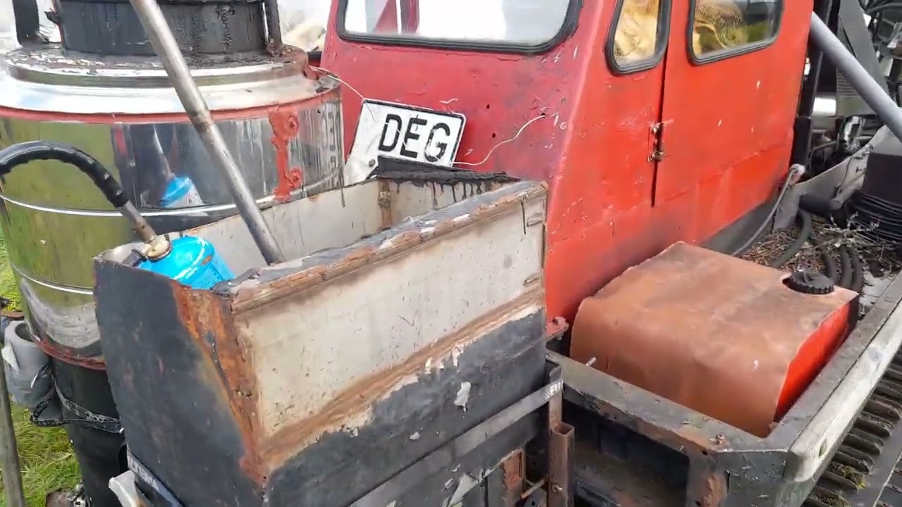

I can show how many people do in Sweden, I have one that gives gas to a 1.5 liter engine, but has had problems, but probably mostly due to my welding.
Think you can translate with goggle, table 1 shows the dimensions of the hearth, Knv is how you calculate how much gas the engine needs. K= 0024 at idle K=0094 at full throttle n= engine speed v= liters of the motor
