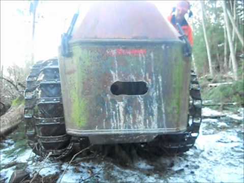

Anyone have any details on building tracks like these?
They kinda look like the old cleated snowmobile tracks Al. They would have to be spliced to get them that long. The cleats are just riveted to flat belting. you would need bigger than snowmobile tabs welded on the inside to keep them tracking on tires while turning. I have plenty here I would give away to anyone wanting to build a set. I had a guy give me a trailer full. I use them for mats driving over wet areas. I have enough for about 100 yards x2
Thanks Jim, wonder what shipping would be? Where do you live? Are they very heavy?
Al Check out “tracked vehicles” on youtube. There are quite a few examples. Some of them take a tractor tire and cut the sidewalls out and us just the tread. I took care of the cross country ski groups tracked vehicles that they used to groom the ski trails. They were just belting material with cross bars bolted on. The cross bars did have two small right angle pieces welded to the bars — as the bar went over the tire one angle was on the outside of the tire and the other was on the inside of the tire. The triangles were mounted so that the point of the base and the hypotenuse sides were pointing into the tire. That allowed the track to pull off center a bit with out gouging into the tire. The tire could just kind of ride up on the slope and force the track back into alignment The bars were spaced to fit in the cogs of a rubber drive gear…TomC
This is an ELL track for skid steers. OTT is over tire track.

I am guessing the weigh 30-40 lbs each and you would need 5 to six depending on wheelbase and tire diameter.
Would you be willing to get rid of 6 of them, and ship? if so let me know how much. no hurry, thanks Al

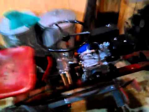

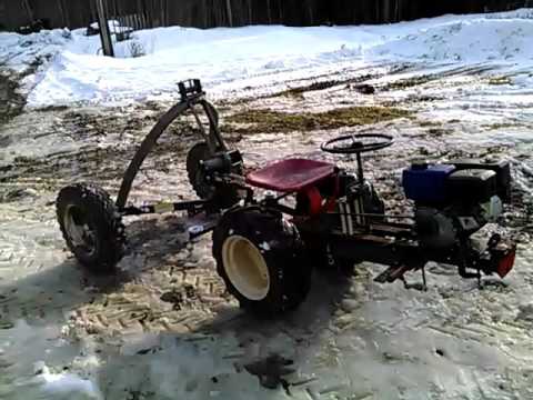

Anyhow, the steering has been a real head scratcher and this is what I have so far. Wouldn’t surprise me if it fails in the field but it’s all I got right now.
Sorry for the poor video…!
No wood gas, yet, just and old engine with an old and too long v belt. So I just c clamped the engine on. The engine will be moved closer to the rear when I can get the right length belt. Didn’t want to stop driving around but someone turned the sun off…
still a long ways off.
