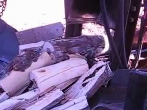

Cut and split a bit but have to get a hydraulic hose. Pulled out a bit more wood.
