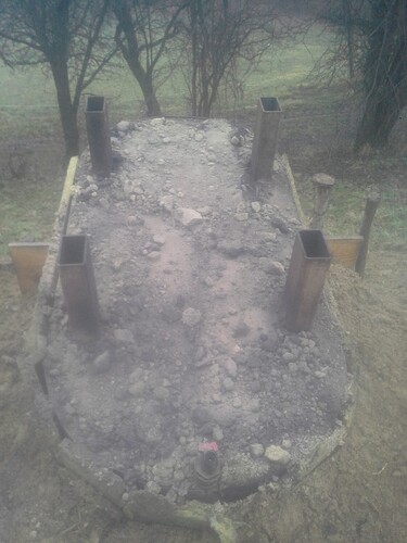

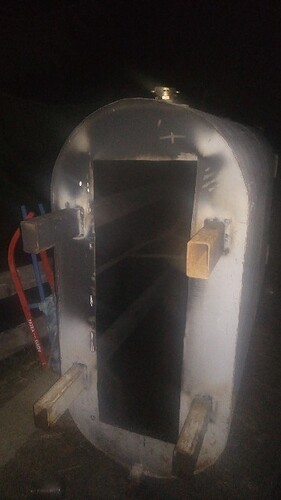

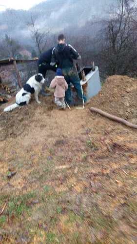

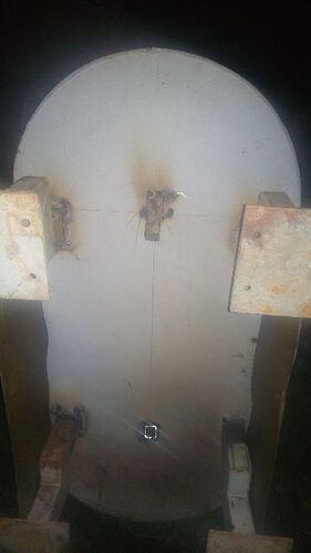

This was a 2000l heating oil tank. I cut two lids out of it, welded in the heating chimneys, insulated and burryed in the ground at the edge of a hill, for easy emptying
Wood is filled at the top, sealed, and fire built underneeth. Steam is vented of and when the wood is heated enough to release flamable gas, steam vent is closed and the gas goes in the bottom burning area, ignited and the exhaust vented trugh 4 chimneys runing trugh the wood bed.
I first filled some damp wood in and it just steamed and steame for hours and hours so l gave up at 2 in the night and put out the fire. The next day l lit again and the gas was flamable soon. When the Kursk was realy self heating, it started a chain reaction scareing the crap out of me. Allmost half a cord wood was piroliseing in there, no way back now!

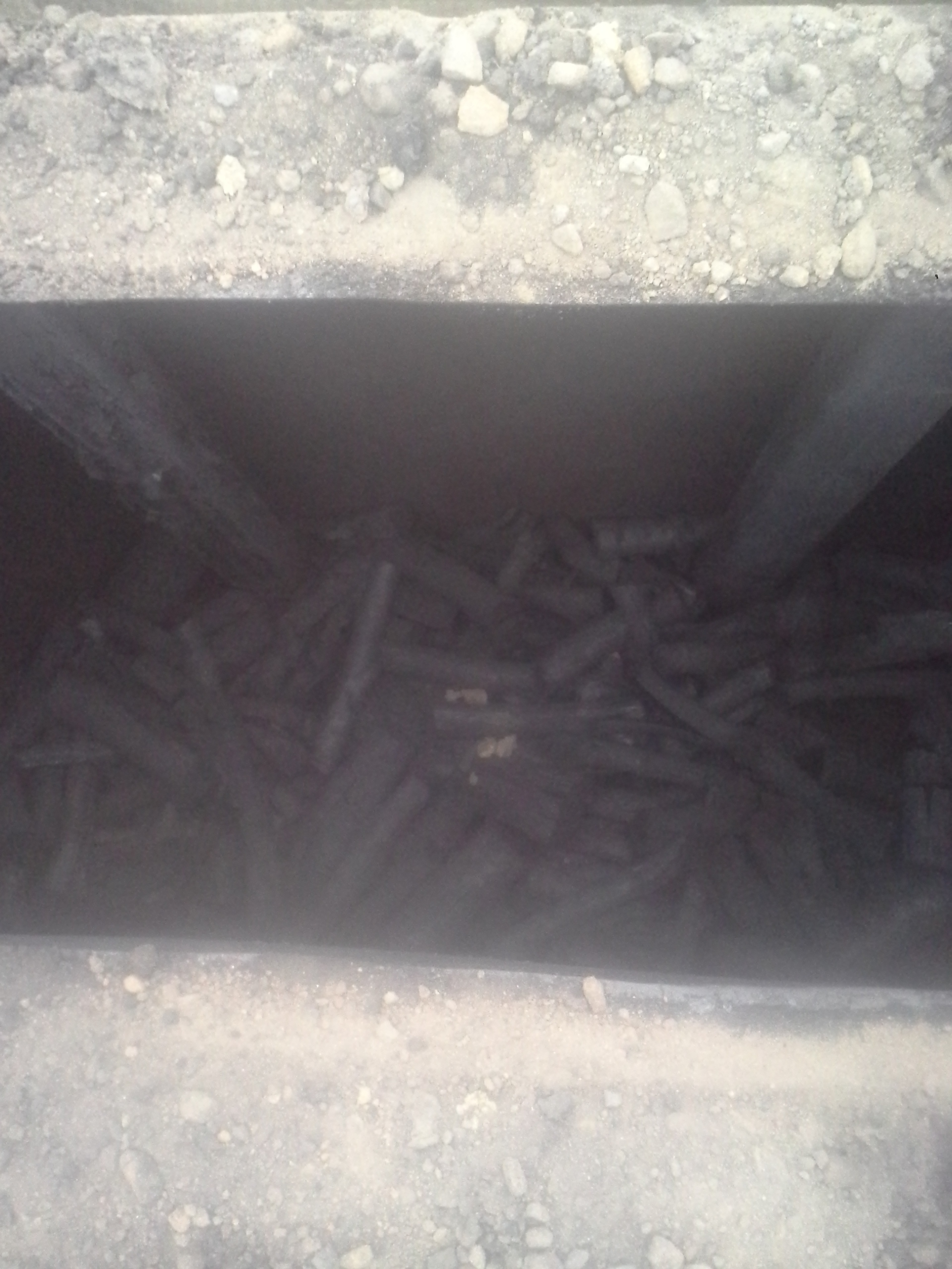

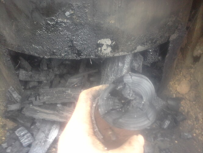

Now, this morning, the kiln was still hot but l opened it and looked inside.
I was sceptical at first, being used to 55gal batches and now makeing a 500gal batch, but upon opening a stone fe in the kiln produceing that butyfull highquality char “cling” sound. Indeed the charcoal is amazeing.

When cooled the char goes In to the grinder. And then a screen below it and into a hopper. Is there a road at the bottom of the bank so you can bring the charcoal up to the car? That would be cool to use the bank of the hill and the slope.

Yes Bob there is a road right under. I plan to add a sifter to the grinder, do it all in one. And a big silo fot engine grade char, make my own filling station.

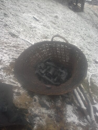

Per instance, its hard to see on the top picture, but the wood used in this burn is about 3-5" dia logs. On the pic they look like twigs but those are some thick lumps of charcoal in the kiln!
Those are fast to prepare, and, when enough time is on hand for steaming prior to charing, require litle air drying.

With what did you isolate the oven?
I envy your climate :roll_eyes: dig the hot land at this season is hard to imagine here
3 cm rorcwool. Nothing fancy.

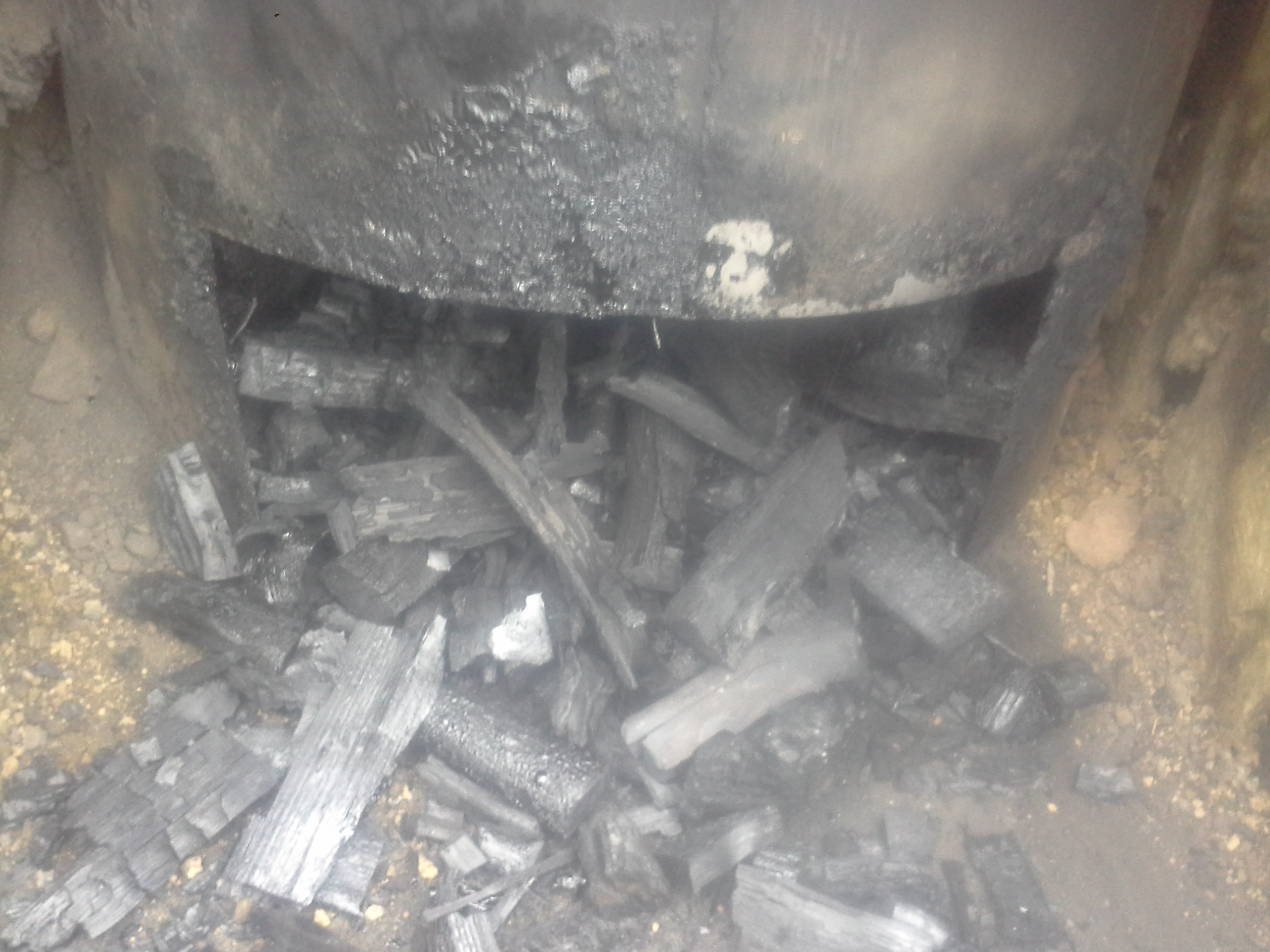

Emptied the kiln today. What a feeling, never saw so much char at one place in my life :smile:
There were 3 partly chared logs at the gate, everything else was premium ringing charcoal.

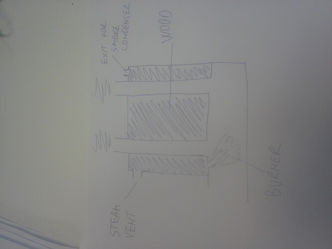

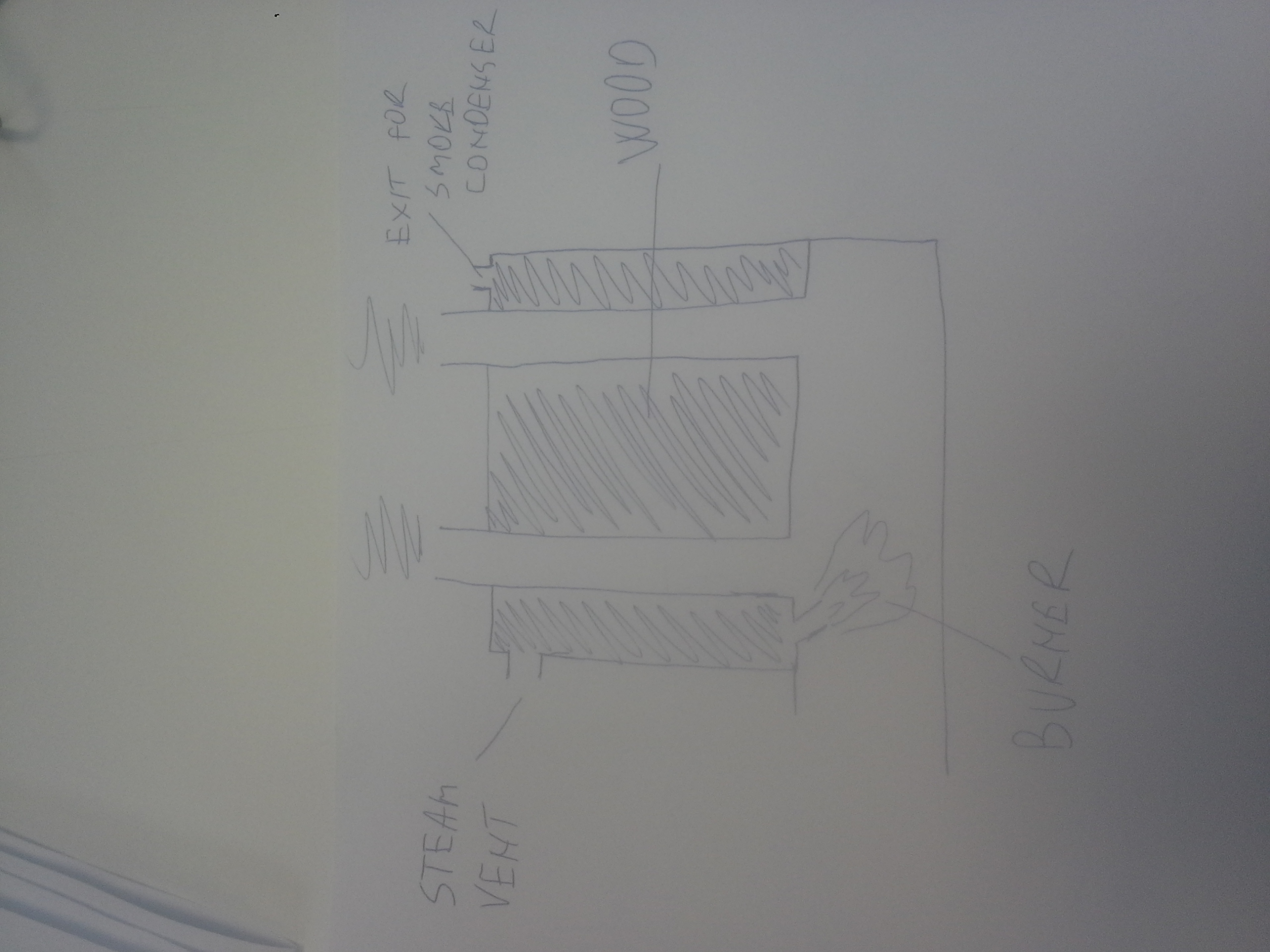

Bob asked for a skiz
Thanks, Kristijan,
That clears it up a bit. Might want to turn that front steam vent up and away from you! Very impressed with the result, Charcoal looks great. Did the retort survive the heat?

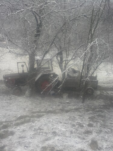

I like the cab on your tractor. :heart_eyes:
