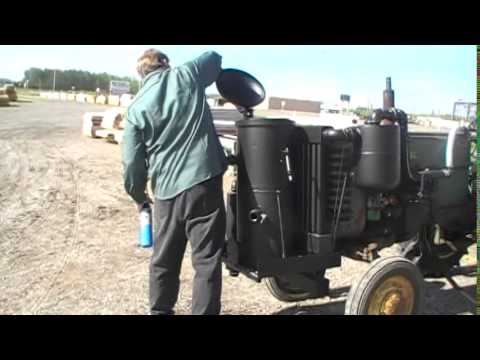

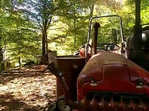

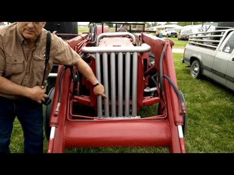

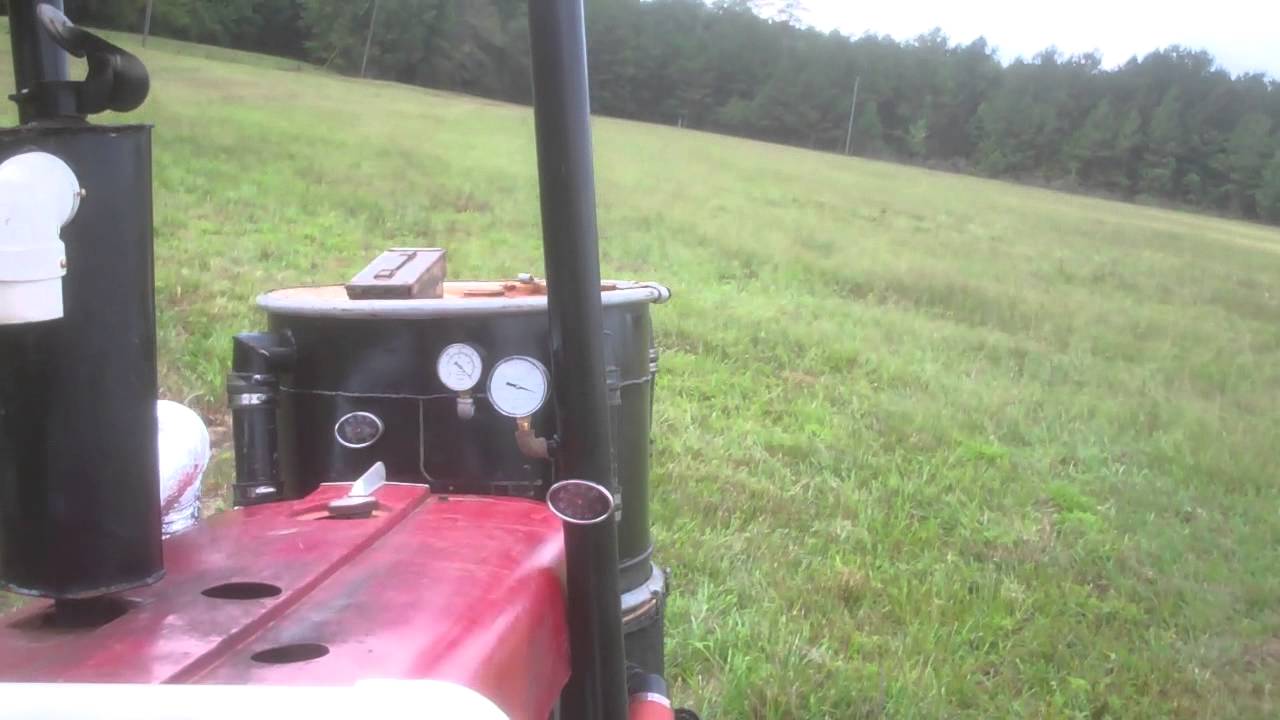

There’s really only a few ways to mount a gasifier on a tractor. Behind, Sidesaddle, or in Front.
This is one of Arvid’s builds.
Here’s Ron Lemler’s tractor
Wayne’s
And Tone’s diesel tractor
