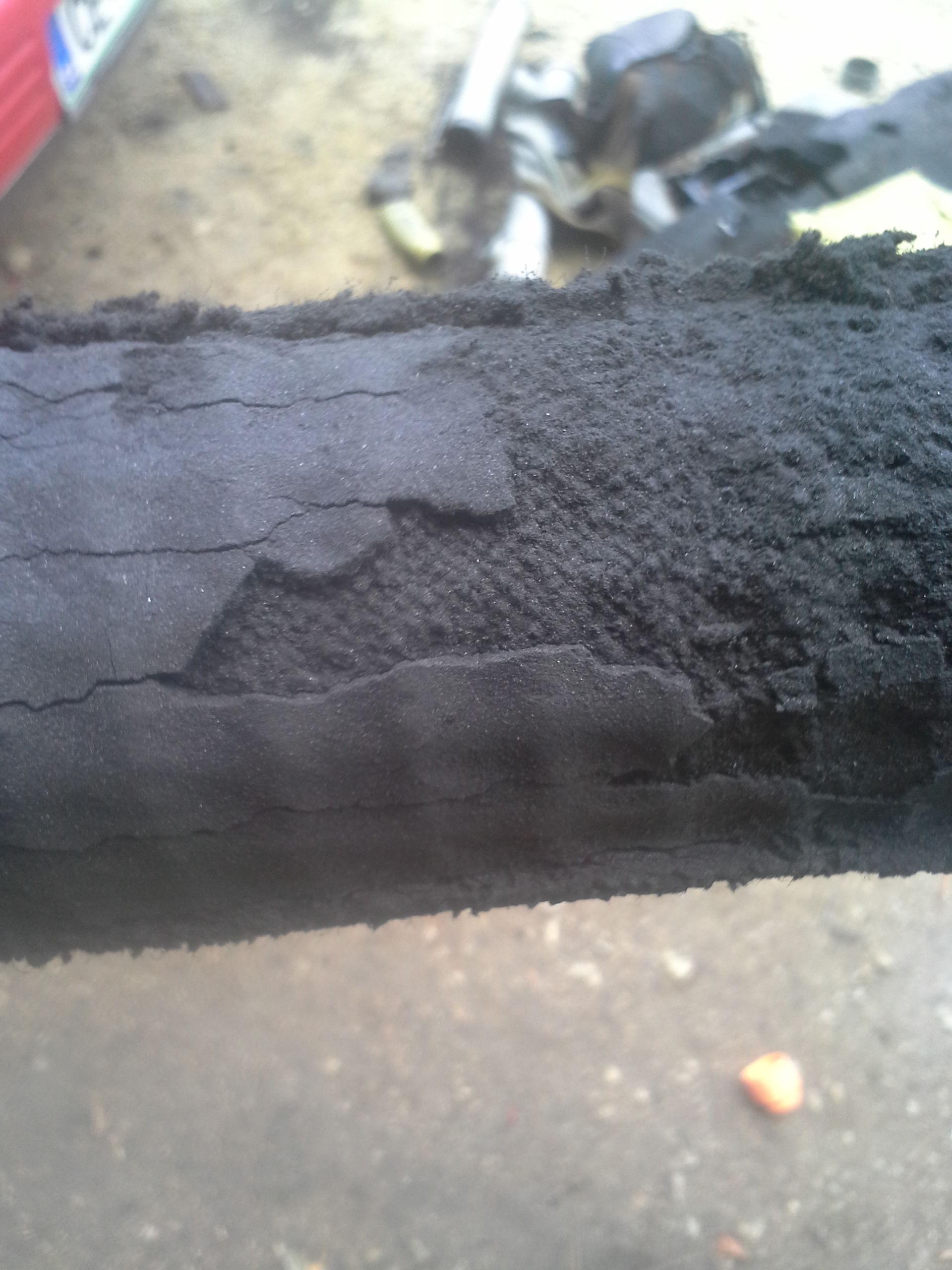

If you plan to make a stationary charcoal gasifier/filter l wuld advise a much simpler, and cheaper towel sack filter. It works smazeing with dry chargas.
This is a pic of the towel filter l talked about. It requires minimal cooling after the gasifier, slightly moist gas doe no harm to it, aids to efficiancy actualy.
It works with woodgas too, but only if the gas isnt too wet. Then the water starts rinsing out the soot trugh the towel.
I know GarryG adopted this kind of a filter on his recent project, hadnt reported the resaults?

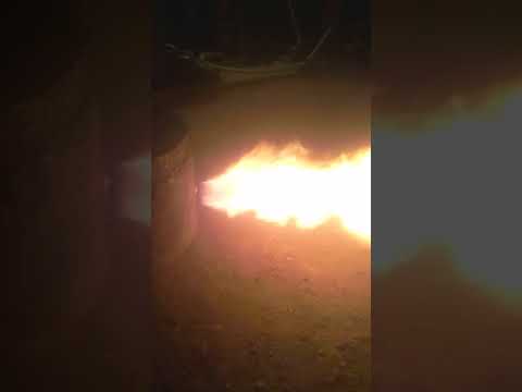

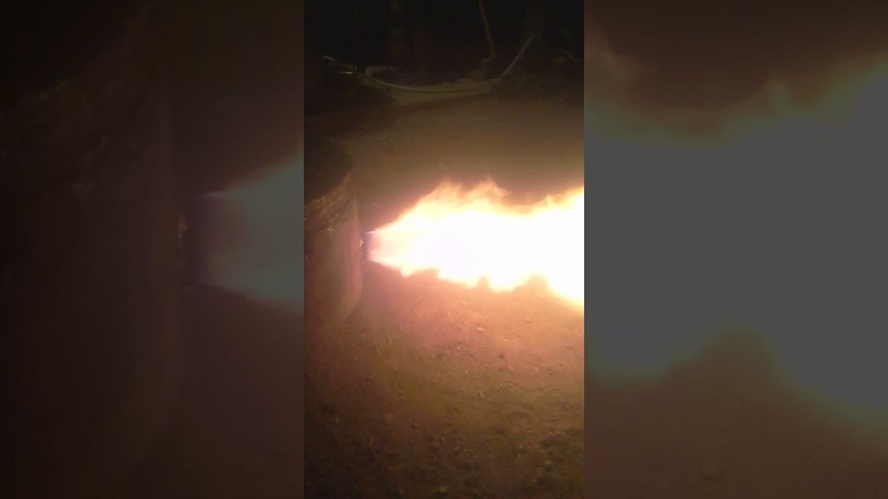

As did @Saman, l too just got my first flare on the new gasifier today!
I had litle engine grade charcoal, and it was quite moist, but l did manage to get a reasonably good flare quite fast.
Allso, the baffle seems to work well! More of the report tomorow!
Can’t wait to see your MB cruising down the road
Careful there you’ll lose that mustache!
Oh! It’s ok. Mustaches grow back. Eyebrows too. (experiences)
Very exciting to see your flare. I look forward to seeing how this all comes together.
Ha, l only trim my moustaches with woodgas puffs, so without DOW for so long they grew wery long
Opened up the gasifier, all looks well.
The Thein baffle is a big sucsess! I found about 2 cups of a mix of charcoal and ash, much like JO reports on his rabbit. No sparks seen while flareing, indicateing the baffle takes them all out.
