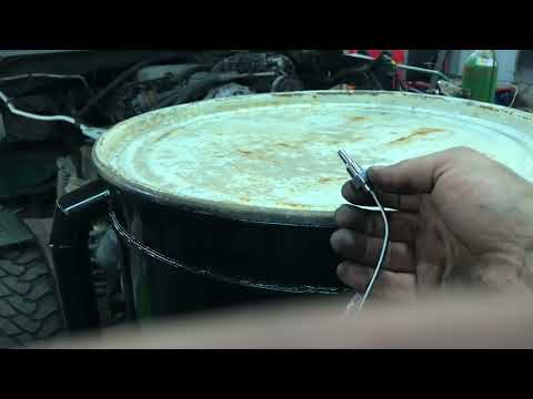

New project! Normans next gassifier truck
A mixture of both, continuous by the centers over lapping each other and about 3/4-1" in between each row. Lots of open space around the edges, with most the middle area covered up as the fins overlapped
Thanks for the video marcus . very good job!!
I have learned to use more spring tension to the front of the hopper ( closer spring spacing ) . If you have a burp it might not get condensation on your cab .
I did that on the Toyota and I’ll be doing the same on the Dodge. Only issue is the lid I’m using is a rather tight fit on the drum so I’m a little concerned it won’t set back down after a fart, or might even bang. I have peened it a lot and it is still a super snug fit, like to get it to sit on the hopper completely it is a good palm smack, and a little difficult to get back off without a little prying
