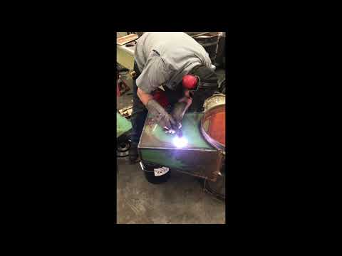

Marcus, as soon as you showed up here on DOW I got the feeling you were the right guy for the job - I was right. I hope youâre still able to get some sleep.
Thanks JO, still sleeping but gasifier construction is digging into fishing time with the kids. The gasifier is coming along pretty well so far, hope to be onto the hopper by next week but i need to start on the bed asap. That will dictate where the hopper cooling tubes, drain pipe and gas outlet will go. That will be a big part of this build
What JO said .
Great video Marcus .
I keep watching and now will have to change my design on my build. Great video. I love how you can cut circles free hand with the plasma cutter. I have been watching how you hold your hands and pivot off your back side.
I just brace the back of my hand as an anchor and pivot slowly, it works pretty good for spots where I canât use the protractor because it will hit things. Now that I have built this stand off mount, I believe I could build it again off of the barrel completely that would allow the use of the protractor and the underside welded nuts I was talking about pretty easily. Need to get started on the clean out/access door, debating a angle iron style like @JocundJake uses for his hopper lid on a few builds. Looks like just 45° miter cuts to make the frame, then a duplicate for the door and a silicone seal in between?
I made the hatch out a couple inches away from the drop box so there could be some insulation to protect the seal and cool it down from the hot gases going by.
Great video Marcus, as always. We used a muffler on dads heat exchanger as wellâŠthey work great and the price was right. Freeâ:+1:![]()
Canât beat that price for parts that will get you down the road on wood, wish I could find some 50 cal ammo cans for that price, and some tubing. Political climate and all I have no interest in sacrificing a full ammo can for this build and my local supplier canât get them. Kinda stopping me up on lower barrel completion
