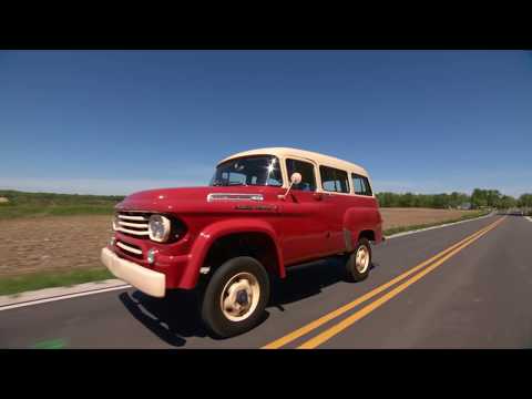

I’ll be lucky to get one more vehicle built. Money and energy, but just like Marcus, the ideas cannot be blocked. I had one Jeep Wrangler. 1990. Maybe the most unimpressive vehicle I’ve ever owned. I know a lot of people think they are great. Maybe for rock crawling but in mud or deep snow any of my work trucks would make them look bad. For hill climbs my 65 chevy mud truck ate just about everything except for one IH truck with a frame stretched out about four extra feet. The power company in this area used these old Dodge power wagon station wagons right up to the early nineties to maintain their out in the wilds lines.
Those are such a good looking rig ![]()
There is one of those power wagons parked in a yard not far from here… no paint left on it. Looks solid though… i see potential. It appeals to me for some reason, but have never stopped and inquired on it.

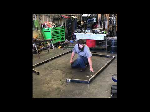

Good morning Marcus .
Not that it makes much difference but was you aware the beds on the dodge rams ( 90 years ) are NOT parallel . The front of the bed is just a little wider .
I learned the hard way of building a welded parallel cooling rack . ![]()
Did you add that picture or am I finally getting dementia? I liked the post but don’t remember the photo. Anyway I’d love to get my hands on that thing. Would have to build the gasifier at the back doors. That would be a challenge. I’d be up for it. Where there’s a will there’s a way.
Yep and as the years changed each truck got a different taper so as to have a specific canopy, tonneau cover, toolbox, head ache rack and so on. Cornering the industry for more money. Actually one of the reasons I wanted to do a flatbed for the new truck
Tom scroll back up to that post he edited the picture into it
Lol, i added it. I drove by later that day and snapped a pic as i went by.
Your getting a nice start on your V10 project, On my 99 dakota i plan on building a light aluminum tool crib or cabinet around my barrels, with air ducking up from the bottom and vents around the back. Two big swing open doors for easy maintaining. with hing back lid posibly. If the outer barrels are insulated, it should be plenty cool around the cabinent. THATS what i am working towards any way. On your cooling rail clean outs, you could use like about 1-1/4 or 1-1/2 pipe caps instead, or either way will work.
I thought about doing pipe caps, but figured the bolts would blend in better to the bed, slap a little paint across it and won’t notice it
Either way sounds good enough, Though i like your pipe plate idea is keen and more less noticable. I thought about makeing piece of medium heavy tin or aluminum around my pipe clean outs on end of my cooling racks ,ounce i get it back together on my other truck the dakota. Caint wait the hear your V10 running on a cleaner fuel, than petro. God Bless.

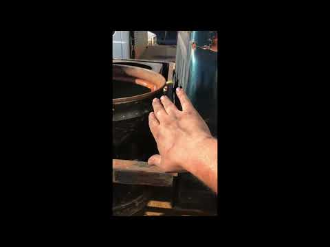

Marcus, snug fit. When I watch your video I start to worry if you forget to take in consideration the space needed for the cooling rail tree behind the cab? I suspect you have other route plans for the cooler though.
