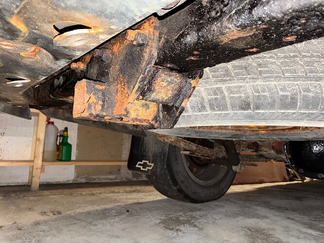

I saw this now when I looked at the other s10, what do I do about this, do I have to replace the entire drawbar? (is that the right word?)
Hi Jan, look in the papers to see if it is registered with ball hitch. This is often the case when rust in drawbar or in frame close to it, a cheap way to fix is to cut the ball of, or make it impossible to use for a trailer by welding a big nut on top of the ball, then register it as a vehicle without trailer pullin possibilities.
A cheap way to fix, but no solving of the problem.
This is often seen on foldable, or removable ball hitch, when they rust stuck they dont pass inspection, and it’s cheaper to make them a “bicycle hanger hitch” and register the vehicle without pulling possibilities.
Ok, do you know if I need a registration inspection if I put a new one on or fix this?
Hi Jan, if you want to “register it back” with ball hitch you need to repair the problem, rust?, you could absolutely weld back a piece of square tubing with a ball hitch, if you make it that way the inspector can’t see you have done something… grind, paint, it must look original, or like you just has sanded and painted the drawbar.
But observe! If you are going to “register it back” probably the type sign on the drawbar is needed, a small riveted metal sign, or a self adhesive decal, stating type, load, maker.
Look in old inspection papers if they still are in glove-compartment, to find the reason why ball is cut off, rust? Rust in frame? Or in drawbar?
You may probably find a s10 drawbar cheap on the junkyard, with type plate on it.
And yes, you need registration inspection, if you put back a ball hitch, that is not stated in the registration papers (I’ve tried, it renders a “2:a” your welcome back for a registration inspection, takes half the time, costs twice the money :roll_eyes:)
