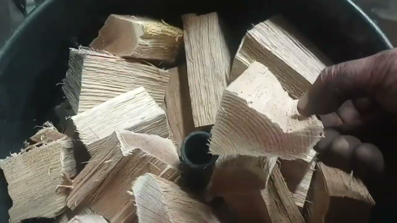

Thanks much Matt. I see several improvements I need to make. Back to work. I drilled breath holes around the bottom of my 55 gal. so I may not be able to control air supply very well on this proto-type. Ill probably replace the 55 gal barrel. Im constantly looking for barrels with the removable tops. They sure are hard to find in my area. I’ll post my progress. Thanks, Joe
Hi ya-all, I finally had success. I took Cody’s advice and re-split to a much smaller size. I ended with a nice batch of coal. I tried to load a picture here but couldn’t get it done.
In the end I think my problems were; pieces too big and my rig is not well balanced. What I mean is I think that the inner retort container (30gal) is a bit too big for the 55gal outer container. It worked really well when 1/2 full of smaller pieces. Eventually I’ll make a new rig.
