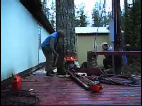

@tcholton717
some felling like this perhaps.
Iv seen that one and many others like it, some call it an amazing shot, I find it to be some luck cutting the stump, and pure luck when it hits the ground. You can get a tree to go almost any direction you want, even steer it to the ground by controlling the hinge, different cuts ( humbolt, church step, swizzler, dutchman, swanson ect) but once that tree touches down you dont have any control over it it can kick up back forward sideways roll slide or stick. You can mitigate it SOME. But not control it.
That tree in particular for my skills I would have climbed it speed lines the limbs off, lower the top out and take short logs off till about 15-20’ and then dropped the stem.
But every tree service will attack that tree differently. And if your not standing at the stump eyeing the thing up you dont know the full story, my plan of attack may change if I was there with eyes on it. May have been bone heavy out one side, may have had a bad kickout, a double top, powerlines nearby and so on. Its real hard to be a arm charm arborist and not look like a fool to the guy on the ground doing the work :joy: But I would not have had the steel set between the legs to drop the whole thing in that window. I would have liked a look at the stump to see how it was set up on the face cut, I’m guessing a humbolt with a swanson on the front face to make it drop hard and fast and off the stump before it shot away from the stump hoping to use the limbs to peg the log to the ground and prevent movement left or right to the shed or house. Judging by the fact they pulled the last log on video with a skidder and there were plenty of brush around this looks to me like a small logging operation and some professionals.
That being said, there is a strange disconnect in Washington from being a logger to being a arborist. Guessing pacific northwest area by the fact it is a doug fir they were cutting. They don’t seem to like each other, a logger will blunder through what should be a arborist job of being hard headed and made of steel and often get away with it without damaging anything but not always. And a arborist wont take on a logging job with a ten foot pole, to elite to bring themselves that low. Its interesting to say the least. Then there is the hybrids like my dad has always been where its just called ā€œTree serviceā€ whatever you need done we can do it. But a few hundred miles south into Oregon its the are high dollar arborist everywhere working in the city’s on big fancy houses with ornate trees. few hundred miles north into bc Canada and its the same there. This is just my experience though
