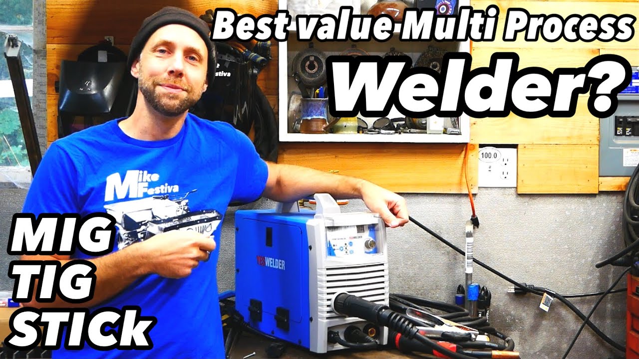

This welder will do what you need. There are many others as well. This is on sale right now and there is an additional 15 percent off, code on their site. You will need a gas bottle as well and a welding helmet. Pay for a decent auto-darkening helmet, not an HF. I bought one and then relegated it to the back shelf. If you are going to do this, get your equipment ASAP. All these machines are coming from China. Maybe.

HI bob are you welding with a yes mig welder, that 3 in 1 machine welder price, looks too cheap, have you had any trouble with those welders. can you get 0.35 rollers for that machine.
