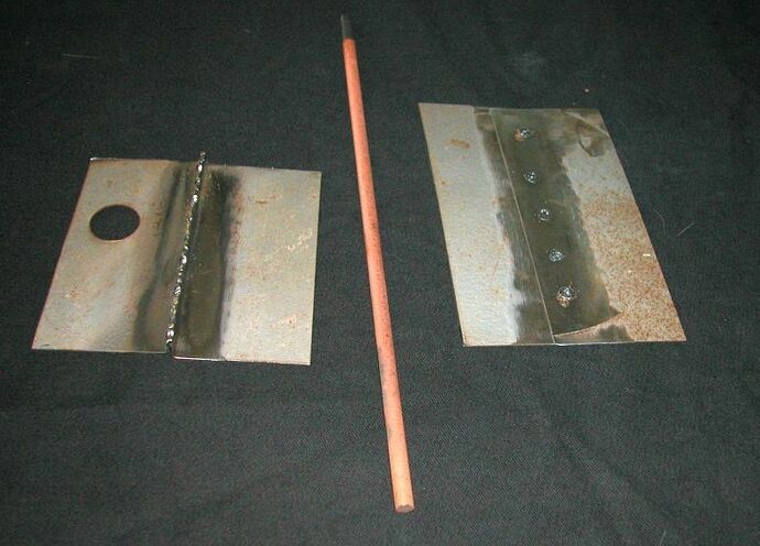

No mig welder no sweat go old school. (CAW) Carbon arc welding
I welded these pieces with a Lincoln 225 amp ac welder set at 75 amps using a carbon arc rod.
left to right in picture. fused seam, center 1/4 inch carbon rod and on the right spot welds made at 115 amps.
All these welds are fast and take some practice.

David I use carbon arc rods from arc lamps, most welding supply shops still carry these rods. as far as the batteries, I’ve heard they will work, try them.

Don my uncle gave me one of those buzz boxes back in the “60s”.As I remember I had to cut the 1/16th rods in half to maintain a stable arc. Folks be careful with carbon arc, it gives of CO it shields the weld some what but it is still CO.
I have carbon rod, I use for other projects, Do I need a special holder (electrode) to use it for welding?
Wayne I use the same one that I use for rods. I grip them about center so they are about 6" long. I’ve used them with AC and DC straight polarity. 35 to 75 amps. The shorter the arc the cooler, the longer the arc the hotter.I also sharpen the carbons to a dull point like a pencil. .

Wayne CAW and TIG are very similar in technique. IF you can run a scratch TIG you will have no problem with CAW
