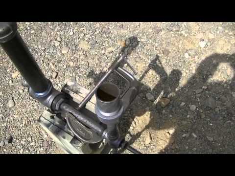

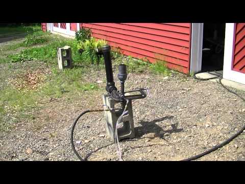

Many people would like to try building a wood gas system but can’t weld. Here is one option for getting around the problem. Affectionately dubbed “Constance”, this machine is built from just pipe fittings with a sheet metal grate cut with tin snips.
To read more about this gasifier and gasifiers in general go to:

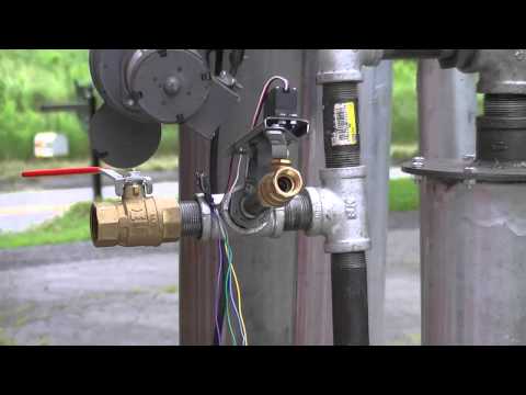

Hi Wood Gassers,
I just finished my automated gas mixer. It uses a ball valve, Arduino Uno, model airplane servo, and a narrow band O2 sensor.
Stephen
I really like it Stephen.
Hey Stephen,
Good to see you on DOW
What Arvid said. I like your work and your website too.
Hey Stephen ,
What Don and Arvid said !

Stephen,
Now thats a cool automation valve!
I was considering using an RC servo to control my mixing valve and just have the trimmer pot on my console and get rid of the cable.
Lots of potential with this idea.
Hi Wes. As soon I get past my two Makers’ Fairs I am going to offer an automatic mixer module for sale. I was going to have it working for the fairs but my voltage regulators have not shown up so I am freezing the design and getting some endurance runs in so there aren’t any surprises on the big day.
Stephen
