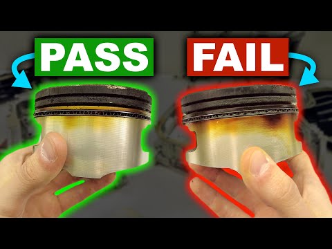

Here is a great video just been released actually semi-sponsored by Mobile One:
The point of this is modern oils are very specifically designed for a specific range of use conditions.
Much, much more than just about viscosity.
There are purpose made oils for 100% propane fueled engines. Sure other will kinnda-sorta’ work. But use the specific purpose made oil to get the longest life and least wears.
Same with for-diesel made oils. Fellows just quit using these in your once gasoline, now woodgasses engines.
What will be the best oil in woodgas converted engines?? Oh, probably standard mineral grade oils in one grade thinner than you’d normally use. Changed out frequently.
Why to use the less expensive “standard” oils. You will be doing the changes more frequently.
I have also ran into two long ran four-stroke air cooled generators that suffered this on-woodgas oil thickening problem. It showed up in sticking cranking compression release problems. Low oil level sensor problems.
Woodgas you are just going to have to go back to the old VW aircooled type oil changes. Adjusted to the climate and use those vehicle were put too. Down to as low as 500 miles if ran in HOT deserts and dusty conditions.
No oil company is going to craft-design a special oil formulation just for woodgas fueled engines.
And this oil thickening made-black phenomena also highlights even more just how hard it will be to use late model double overhead camshaft engines. Rewatch that video. See the engines Mobile One was focusing on. Moderen single and double overhead camshaft engines.
