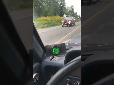

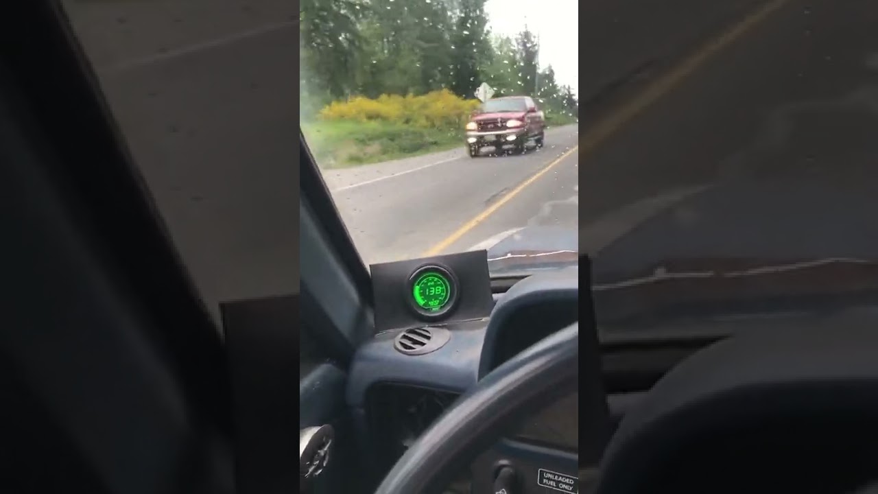

Congratulations Marcus.
Good thing you’re getting rid of gas again
+20 more melons.
I’ve never had an engine without timing marks. I have many times set timing by sound like you are but it always leaves you wondering just how close you are. I think this is the only way to do it but not easy with the engine or even just the cooling system in the truck.
Glade you are back on the road and thanks for the ride .
