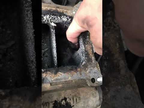

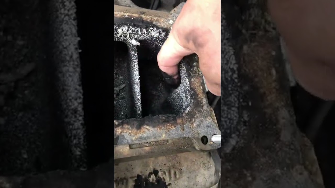

One nasty carberator that needs some TLC cleaning. How are you going to clean the intake out, or are you just going to leave it the way it is?
For now with how little soot there is I’m going to run a wire brush down each runner and if anything kicks loose it will get shop vaced out. Carb I’ll take in to work Monday and tear it down and give it a good scrub out in the solvent tank and be back on the road. It was still drivable, but I had to start on woodgas all the time for the last week. Even if I turned the fuel pump on it made no change at all in how the truck would run and fuel gauge didn’t move at all. The woodgas starts in the morning was taking to long to and I didn’t like getting to work late so finally time for a good cleaning. Somewhere between 7-8000 miles
Wow you have invented a super high mileage carberator that uses NO fuel at all . Look out the goverment might want their hands on this. Take the first offer they give you. Lol
