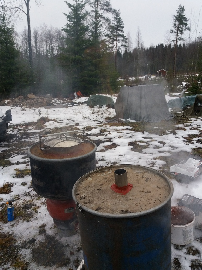

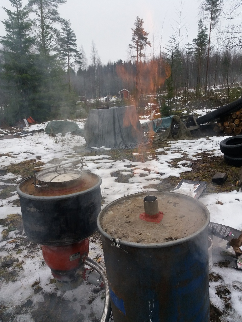

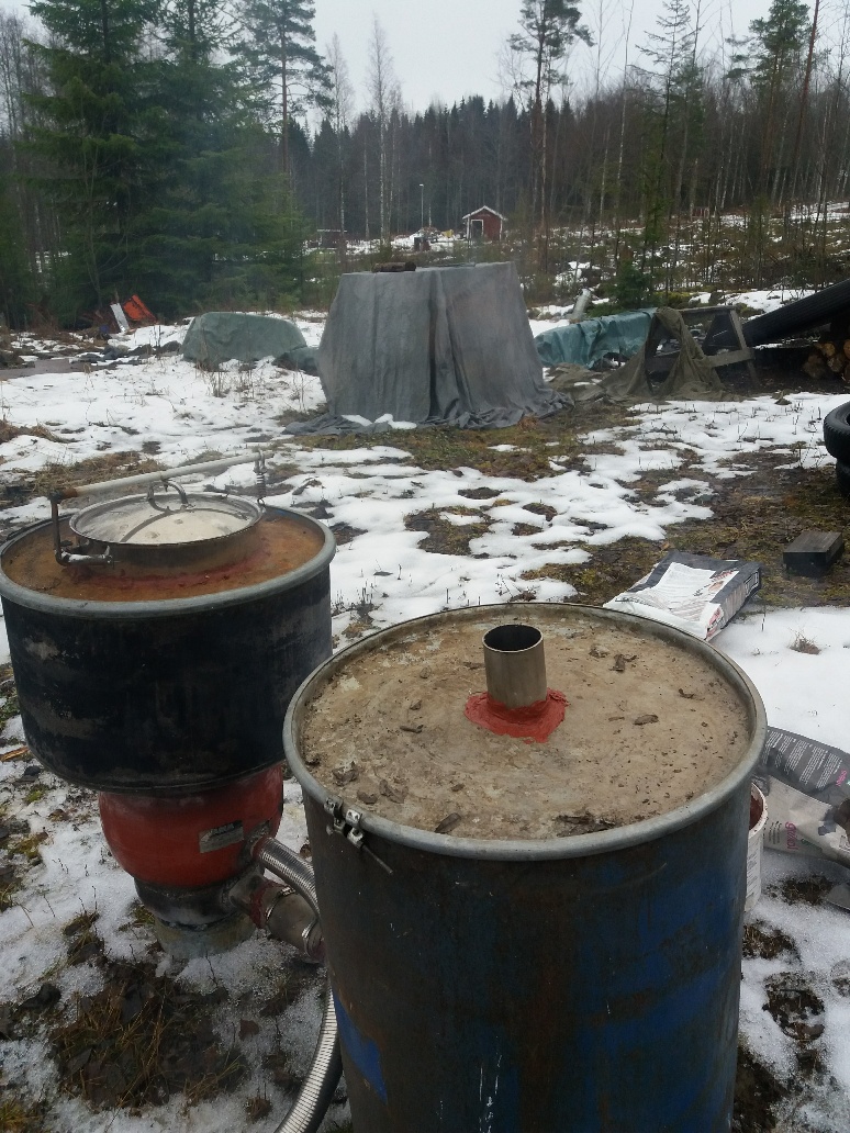

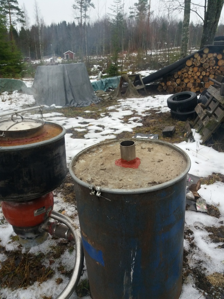

Tried the imbert type the first time today, seems like it works.
The first image is after about 2 minutes from the start, then about 3 minutes in between the pictures.

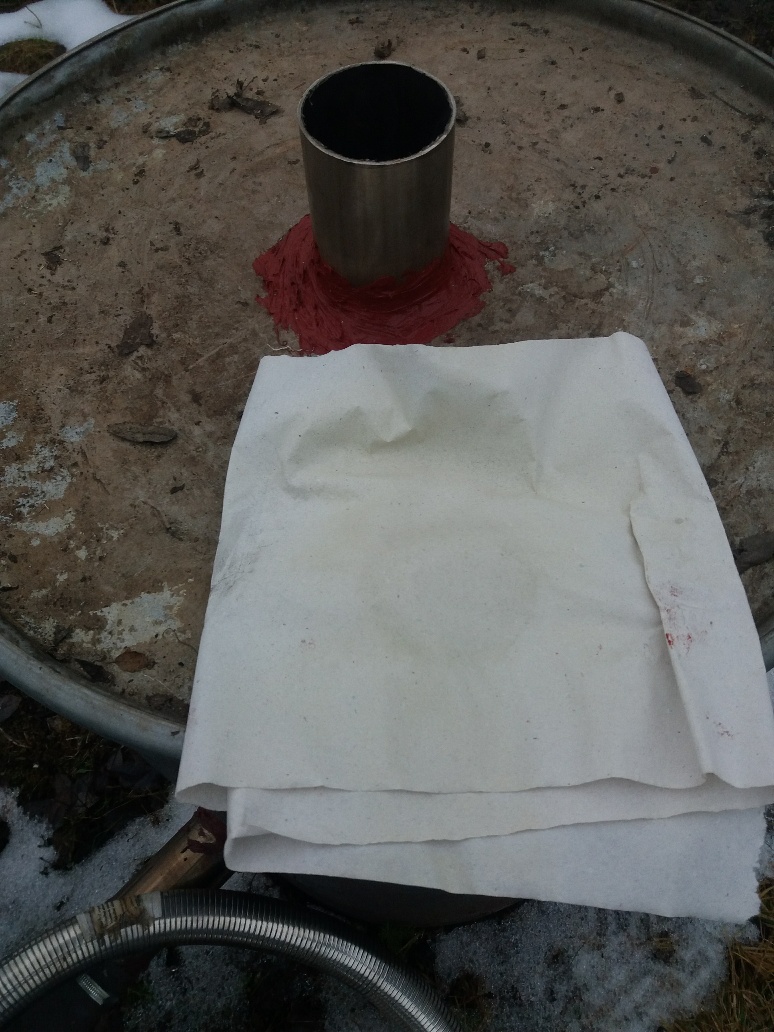

The last picture I ran the gas through a paper for about 1 minute.
Congratulations!
What kind of filter medium in the barrel? Hay?
No, it is the glassfiber bag, does the gas like this free from soot with hay as well?

For a short run a big barrel settles most of the soot, pretty much with or without hay. Over time very fine soot buildup start showing downstream. I bet your fabric does a better job. Can’t tell about ease of maintence though.
CONGRATULATIONS Jan, a Imbert Gasifier making clean gas, nice job well done.
