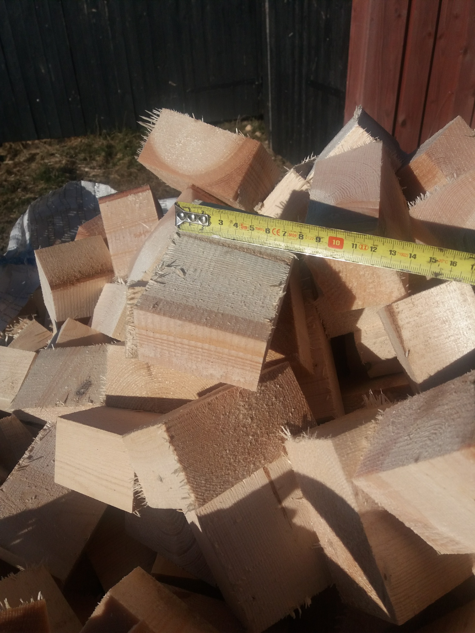

Can I have these pieces or do I need to split them into smaller pieces?
The pieces are 4 “x2” x 2-3 ".

Your fuel size seems good to start with, but soon you will find out in which direction to go. The charbed is the teacher…
