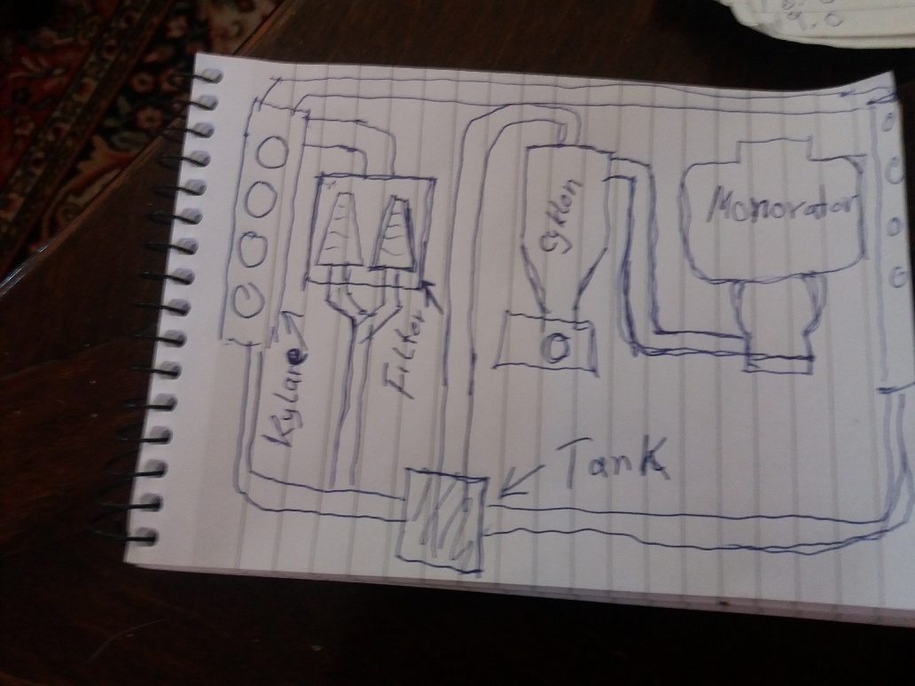

Thanks Max. Do you have the opportunity to take a picture of your design of filters and heating?
It would be very good for me to see.

Are you going to weld a mantel on the cyclone and apply a paperfilter (in its own case)?
Max
I was going to do it, but I’m not sure when you not did it on your car.
I read about these boys, they had problems with the filter, although they have 3 kvm, and my engine is twice as big. The problems became bigger when they traveled shorter distances as well, which I usually do.

Hi, Jan!
24.4.2020
Reheating the cooled and condesed gas on the cyclone has been done on several vehicles in my country and elsewere!
That is nothing exeptional. It does not need me to start my rebuild just to repeat what my collegues have already done!
So, pipe the wet gas from the condensing cooler upwards into a welded-on mantel, tangentially, to get it to circulate around the cyclone, to get the wet gas to dry properly!
Paperfilters can take ~110*C without any crumbling or deformation.
But wet gas will destroy them.
A Fringe case was the DJ-VOLVO, where he tried to do the
reheating with a motorcoolant “battery”= cooler, and acheived just a wet shrunk paperfilter, which did not let the gas through! (starting with a cold motor and coolant!)
The cyclone mantel is hot before starting on woodgas and keeping the (at first = initially bypassed) paper filter dry!
So, if you do not accept facts, choose some other way…
